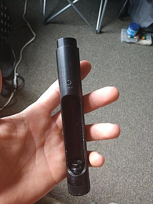

    Got this in a lot, looks like it needs a new piece that attaches to the asa. Anyone know exactly what I need and where I can get it?
  • Chaos
    I'm Comin' To Getcha
    • 874
    Nelson style Dropout changer all that's missing is the retaining nut,spring , power tube and cup seal
    • Jackson
      • Apr 2022
      • 130
      • Pittsburgh, PA
      Yeah, that doesn't screw into an ASA. That's a Nelson style valve body with integral 12 gram changer.

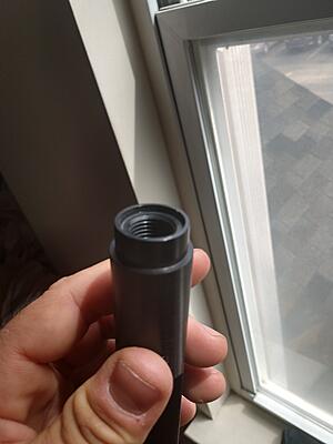

          I think you are right. Or at least on the right track (I'm not familiar enough with Trracers specifically). A Nelson-compatible valve body is held by a cap screw that passes down through the top of the valve body and threads into the trigger frame. Upon closer inspection, that looks like that is not a through hole in the valve body but instead a threaded blind hole, which means that there must be a screw that comes up from below and threads in, à la a Trracer or Phantom. But it is distinctly not a Phantom valve because the reduced diameter section is not long enough.

          I just realized exactly what this is, I was thinking it screwed into an asa ha ha. I bought it with a phantom so I'll have to see if it fits on there.

            Phantoms have a much longer shank part. This looks like another kind of nelson
