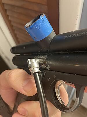

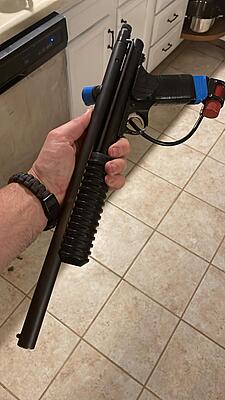

        I just reread your original post. Direct airline?? Which P68 exactly are you speaking of.... P68SC(not likely), P68AT, P68(AT-deleted) or the 68 Magnum?
        Can you post a picture of our newest patient? (MCB loves its pictures!)

          P68 at delete.

            Hey not fair, I've already seen this porn before in another thread. Okay, okay any paintball porn will do.😆

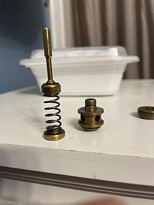

                          To be honest, I don't think I've ever seen the front of a P68AT valve. Does it have a face seal and some kind of dummy 12g? Or is it plugged from the factory differently somehow?

                            It’s a flat wall. On the inside. These are the internals. Should I just try to find like a spider mainspring and cut it down and create a new valve spring?
                              BrickHaus commented
                              CA valve, and that recessed part indicates likely Palmers. Opening up the 4 holes around that brass part is another option.

                            I just found a generic spider spraying and cut it to length and put it in there. I took a shot with in the basement and it seemed like it was shooting a ton harder. So I’ll play with it and see if I can get it up to speed. It might be too powerful now lol
