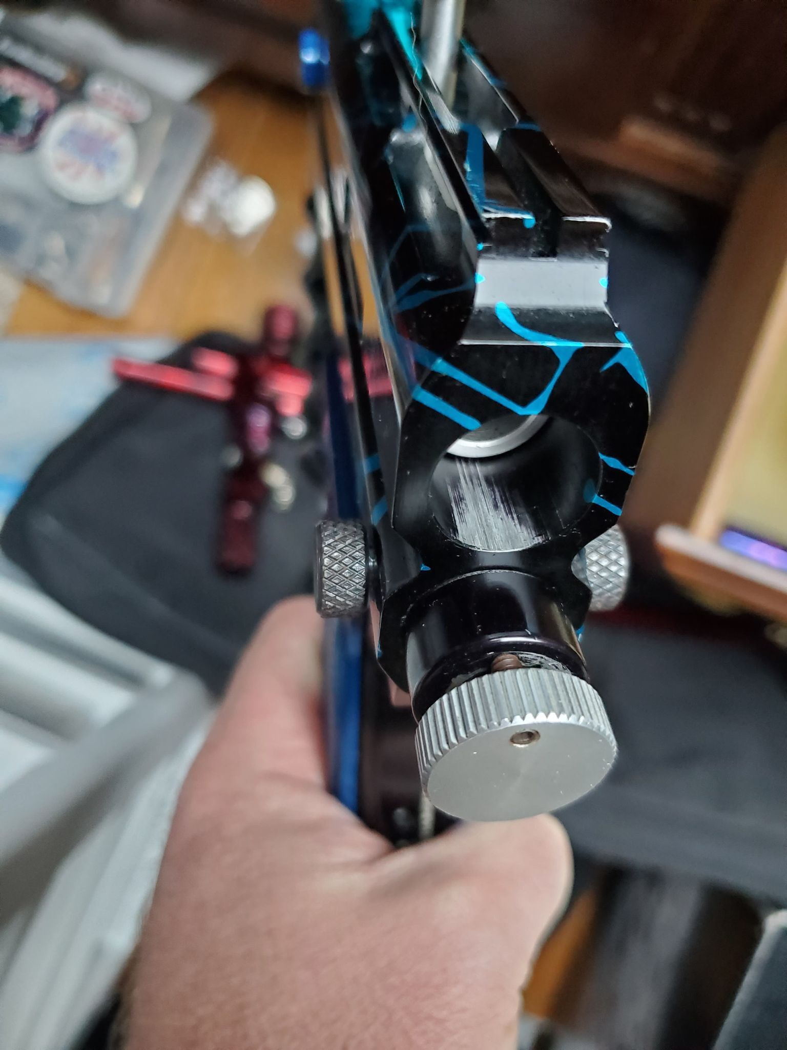

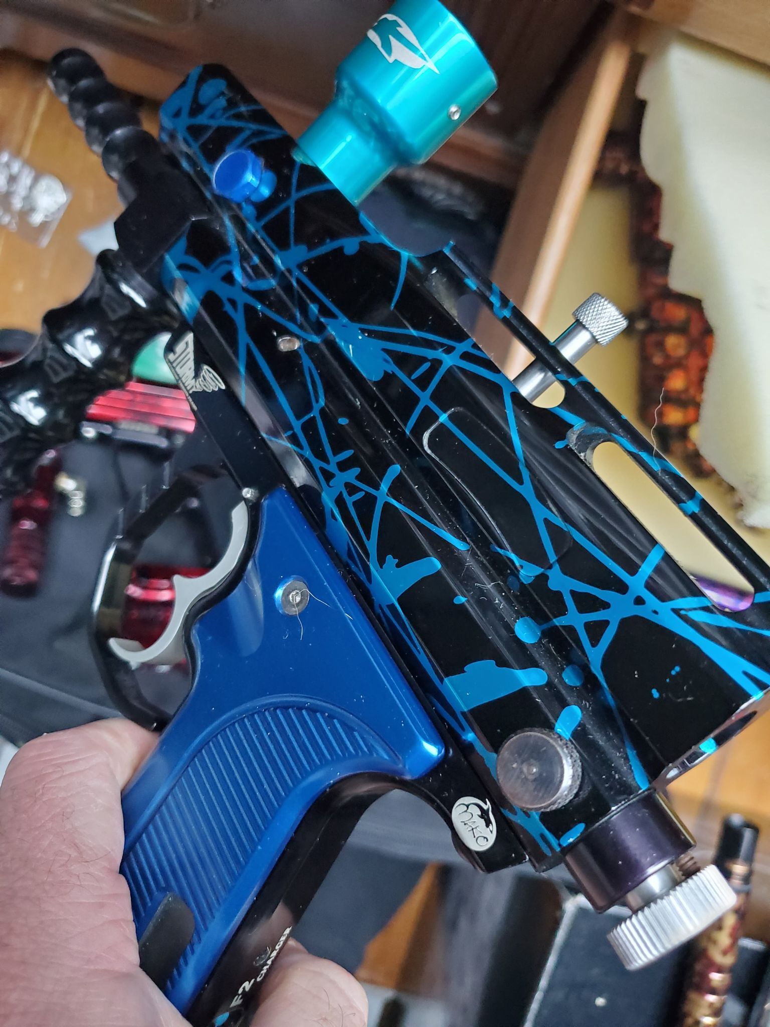

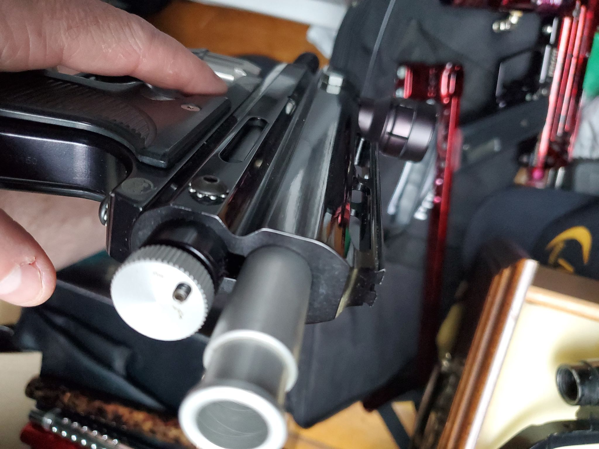

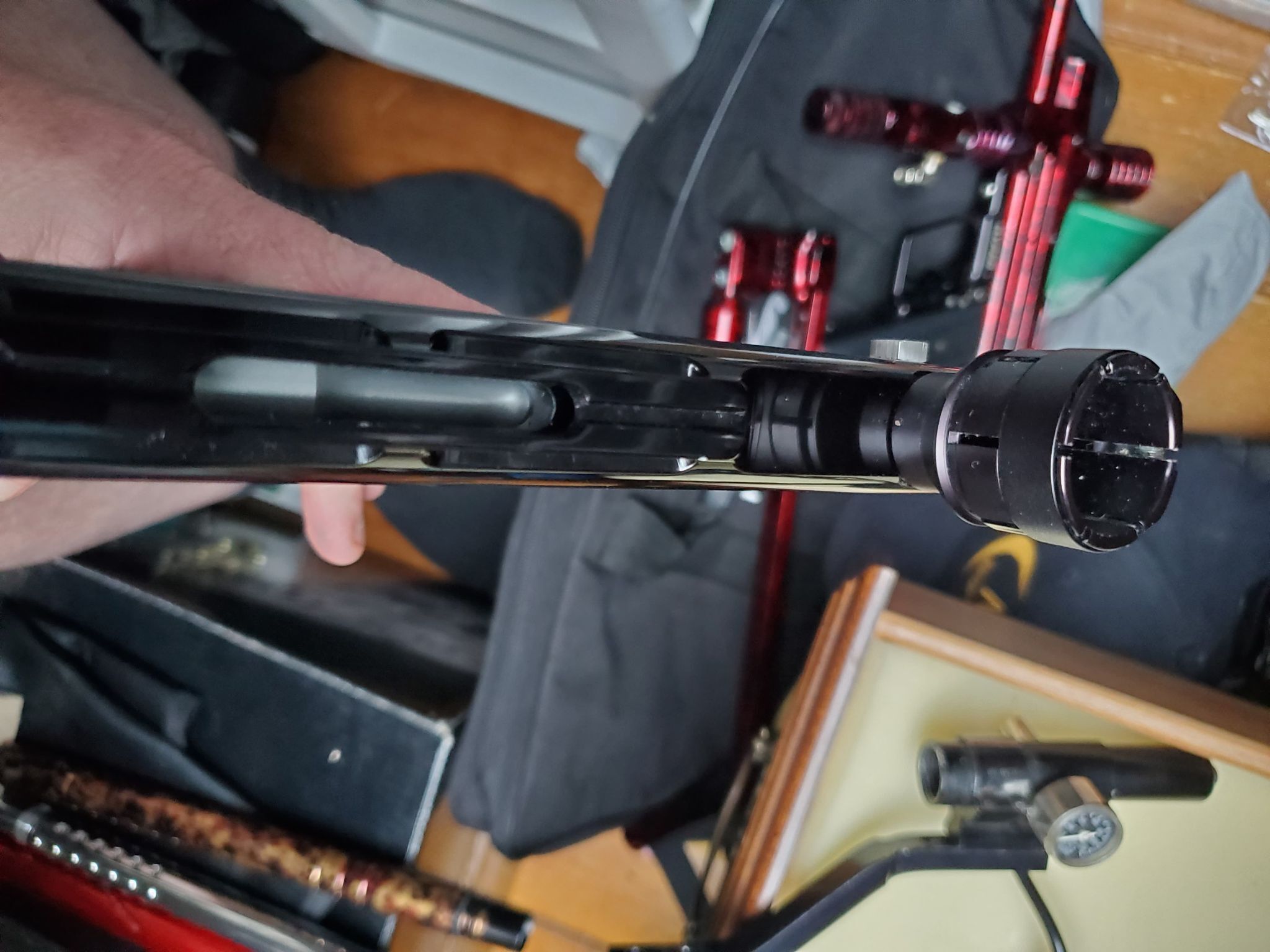

        Scottieb,
        Here are the pictures of my Blue Splash. It is a full gun Millennium. I bought it new. It is the first paintball gun I owned. Has somewhere over 300 chases of paint thru it. Last time it was used was 2005.
        The black is my cousins gun I build up for him from a Millennium replacement body. Last time this was used was 2012 or so.
        The Blue gun is missing the side slot as well as the slot between the tubes that would make it rear cocking. The wear highlights this. Go figure. It also does not have the hole on top to hold something like a aka rear cocking.
        The blue gun also has a recess for a jewell. I have it but when I bought the gun it had already fallen off and was sitting in the box. Its still there.
        Click image for larger version  Name:	image_38175.jpg Views:	3 Size:	232.0 KB ID:	313319
        Click image for larger version  Name:	image_38176.jpg Views:	3 Size:	365.2 KB ID:	313320
        The black gun is the replacement,
        Note the slot between tubes for rear cocking. Also the side & top cocking.
        Click image for larger version  Name:	305080221_386295250330746_4256398176715973998_n.jpg Views:	0 Size:	240.6 KB ID:	313322
        Click image for larger version  Name:	image_38177.jpg Views:	3 Size:	355.2 KB ID:	313321

        • cougar20th
          cougar20th commented
          The blue one has its stock original cyclone bolt.
          The black is pretty much the same as its a bob long cyclone bolt just the longer rear cocking style. (Shown in the cocked position because I was stupid enough to pull it back and theres no batteriies in the gun)
          Some of my other milleniniums have various aftermarket bolts. But its long enough I would have to look.
          scottieb commented
          Keith is correct on this one. In my above comment I referred to the top tube itself being open and didn't mention the material in the body between the top and bottom tube. I've a bolt (unknown manufacturer) that brings the striker-bolt pin up into the bolt when the knob at the rear is turned. I can use it on the oldest style Millys. Shocktech made bolts for Spyders which are similar however the striker-bolt pin does not recede all the way into the bolt.
          The original top cocking models used a single pin for the cocking rod and striker-bolt pin. The stock bolt can be used in other Milly bodies with its pin however the later model rear cocking bolts will not work in the older bodies as the material at the rear of the body between the tubes does not allow a way in for the striker-bolt pin.

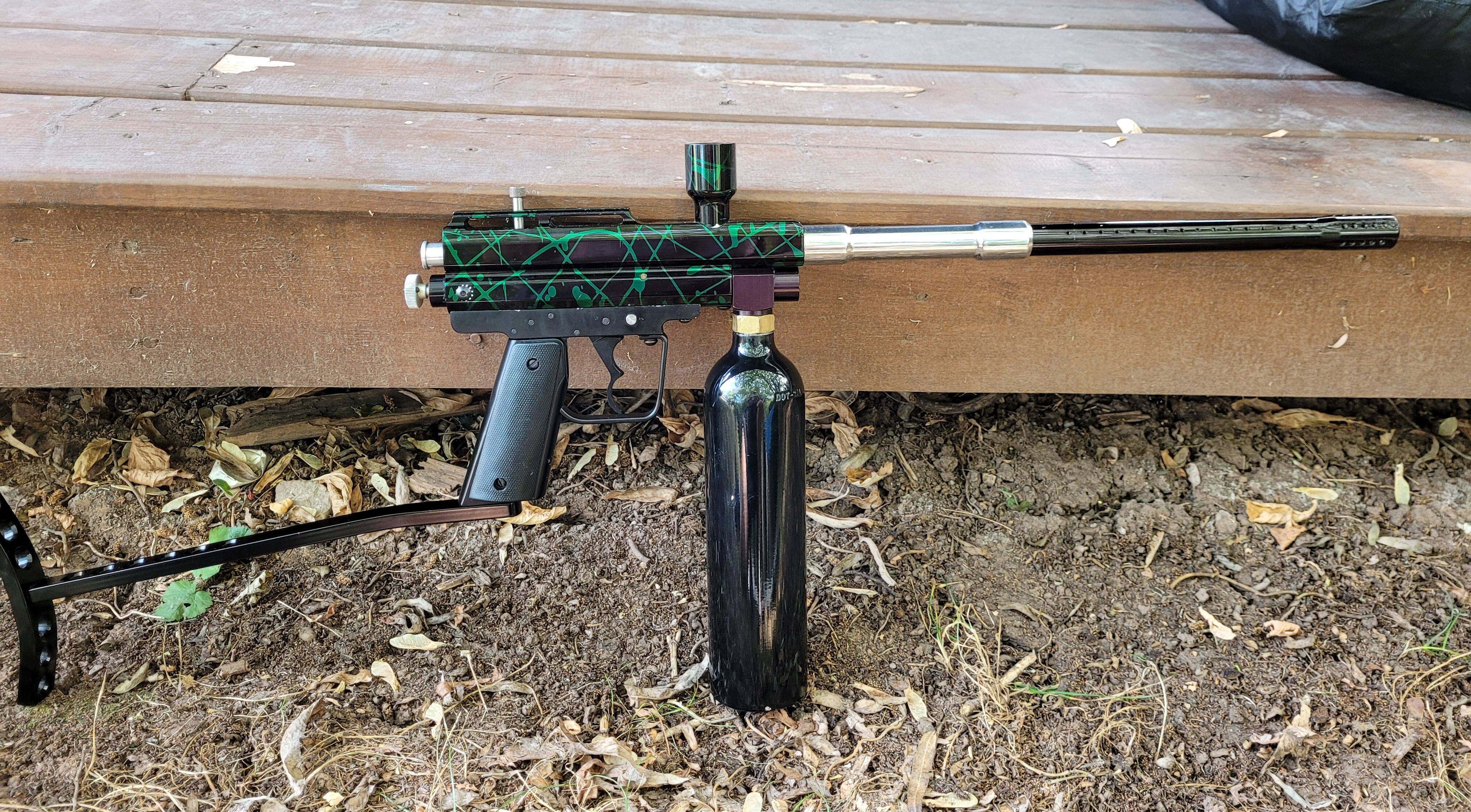

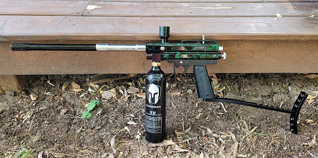

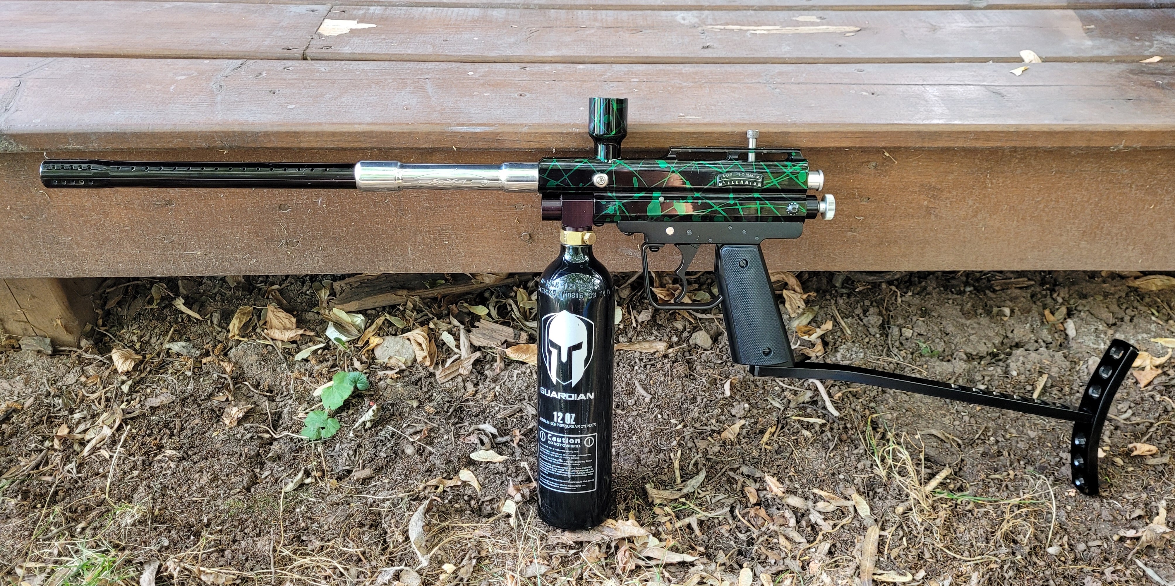

          Alexndl Here you go!
          Ideally, I want to find a nice gloss black gas thru for this and run a bottomline asa, but to get some pics for now, here is a vertical setup with my 12 oz Siphon tank , and my in yo face T stock thrown on there for fun.
          I also tuned it for liquid co2 today in the shed.
          To reduce internal volume, the bob long lpc is removed, and a spyder front cap installed its place.
          From a Warrior spyder spring kit, I have the heaviest valve spring installed (gold), and the light/medium (blue-ish) drive spring in there. With the RVA turned all the way in it was shooting 310fps. The RVA is backed out where you see it in the pics to get in the high 270s/ low 280s fps
          I'll get some co2 fills , and run this for the MCB Sept meetup!
