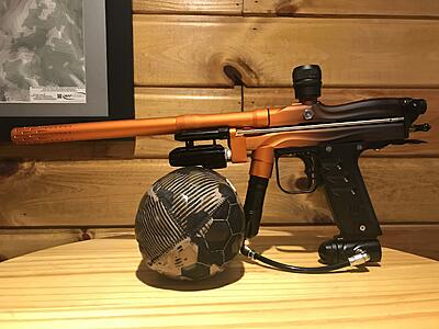

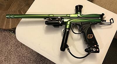

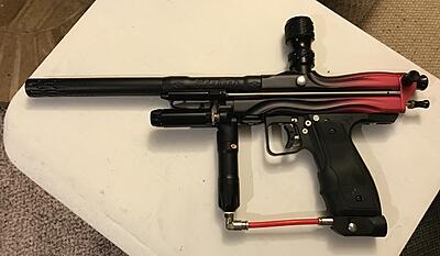

        I’ve used the Inception rams with and without QEVs and I’ve never noticed any performance gain with QEVs. With future builds I’m planning to save money and go without QEVs.
        The Inception ram is easily my favorite ram. The spot on the shaft to turn it with a wrench is a really nice touch, and it’s really easy to disassemble.
