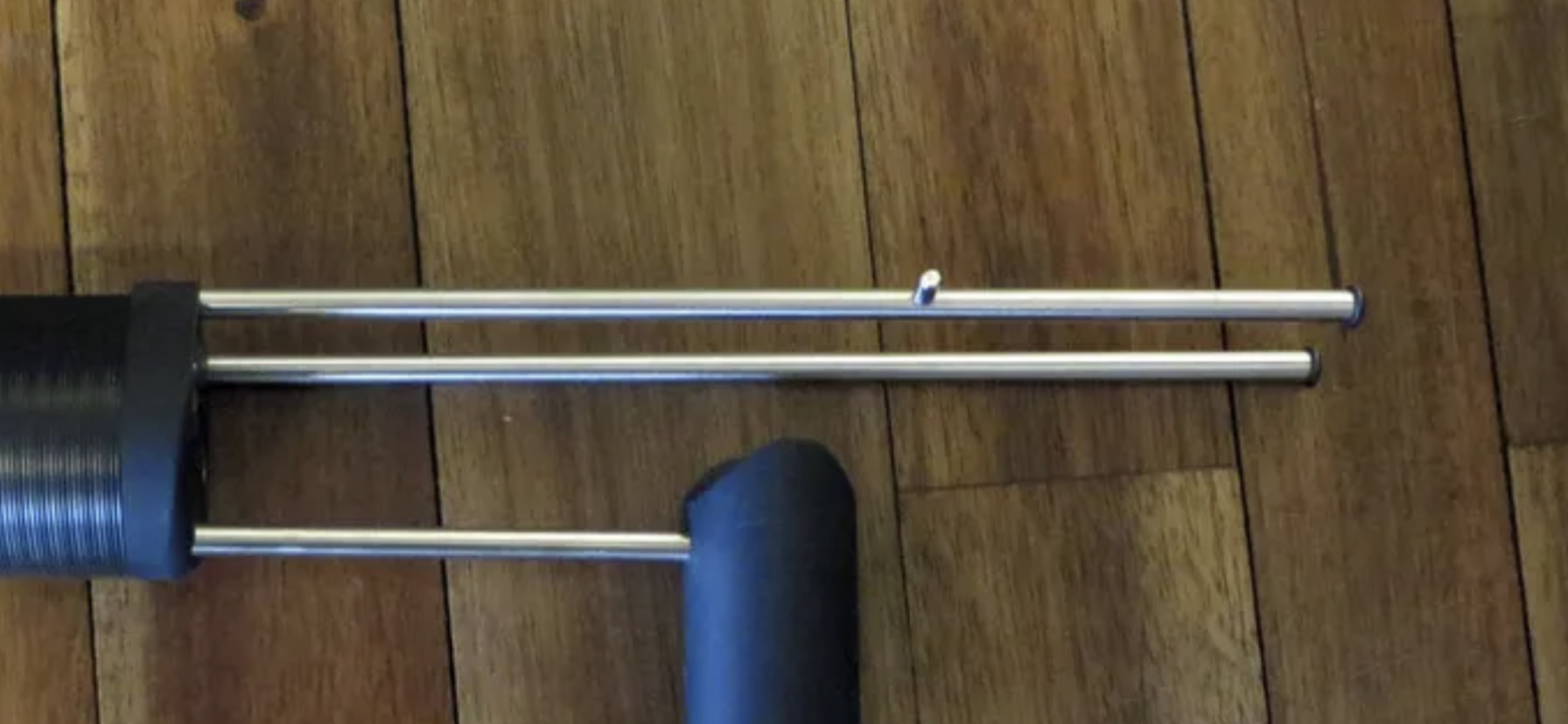

    I've never seen a cocker with a dual rod pump kit. I'm curious about how they mate up with the pump plate and the back block. Is one rod right hand threaded and the other left? Is one rod threaded like normal and the other held in place with grub screws?

    Some are lefty threaded, some attach via grub screw others bolt on from the front.

      Cool. Thank you! What do you mean by bolting on from the front?

    You can also purchase back blocks set up for dual rod pumps.

      Do you have any photos? I'm trying wrap my head around how to attach the back block to make my own
      Thread then bolted on the rod ends threw the back block.

      Autococker parts has them for Karnivors….unfortunately, this is the best I can do for ya.
      https://autocockerparts.com/karnivor-back-block/

    Or you talking about how dual rod pump kits work. They are bolted in on the end threw the back block. Sometimes bolted on both ends. Sometimes thread into the pump plate and red locked so they don’t move on the back end they are bolted threw the back block so it’s easy to remove and clean. They need to be perfectly aligned or they will bind.
    You can use standard threaded rods but it’s a nightmare getting them threaded in and aligned at the same time. Especially with an AT lug.
    CCM keys their rods into the back block and bolts them threw. So the back block is sandwiched between the rod and bolt.
