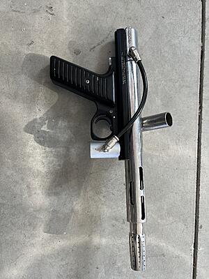

    I’m looking for some wisdom here. I’m trying to put together a couple of small pistol style automags with some stuff in my parts bin. Can I run a classic valve or a minimag off a 12g bucket changer?

    You sure can , ran a 12 gram vertical changer in a Mag many times.
      • 4255
      Yes you can. To keep a tight setup you can run an ASA off the valve with a fitting for the 12g changer. Horizontal adapters are out there but are scarce. And you can also fit a duckbill pointed forward for the 12g changer.
      • Toestr
        • 2878
        • Poland, Onterrible
        I read a post on AO where a guy did a bunch of stuff to improve 12g efficiency. He opened up an older valve with a threaded in powertube and devolumized the dump chamber with and also added orings to the bolt and powertube. Probably some other stuff I'm forgetting too. He was getting 30-40 shots iirc.
        For air routing I think your best options are either horizontal under the barrel (difficult to find horizontal ASAs), Hawaiian style (this will be the easiest) or side saddle as mentioned. For side saddle you could use an Automag VASA or a remote line ASA with a steel hydraulic 1/8nptm to 1/8nptm nipple running off the side of the valve. I highly recommend the steel nipple because a brass one would have a better chance of getting bent or shearing off if you take a tumble.

              That’s what I have so far, thanks for all the responses. Would you suggest a different hose and fittings set up.
                • 6341
                Hard line or braided is best. The on off pressure of the 12g play can give you issues with macro. Expect about 20 shots without mods.

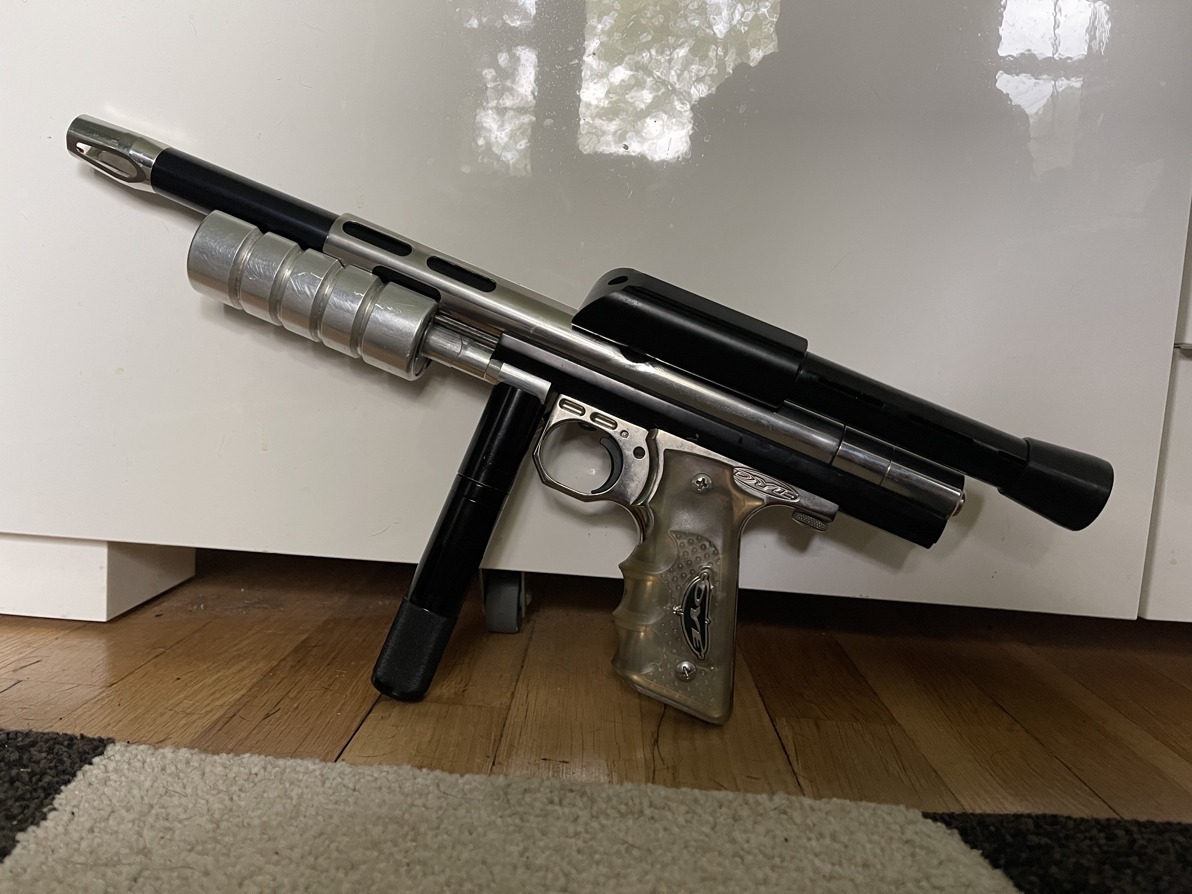

                        This is fantastic! Where can I get a stick feed like that?
                    • Pyrate Jim
                      Shi Tamajutsu Ka
                      • 696
                      • The Group W bench
                      I actually have two I run on 12g's.
                      The first is a Sydarm. The other is a build I put together on a Lukes stock-class body, with an AGD pump kit and Line SI lever lever changer "island style".
                      Both are a level 7 valve and have no trouble on a 12g, but the platform itself is a bit of a gas hog so don't expect more than 18-20 shots on a single 12g.

                        I built Riots and my VSC Pumpmags. Both are devolumized. Both get 12-15 good shots. After that velocity drop. Of course weather does play a slight bit into that.
                        About the only thing I can think of that would help efficiency would be mounting the 12 hram holder directly to the valve inlet. As there would be less wasted CO2.
                        Either way I swap 12ies when I reload generally.
                        • Pyrate Jim
                          Pyrate Jim commented
                          The Sydarm goes directly to the valve, and a sidecar mounted changer can do pretty much the same thing.
