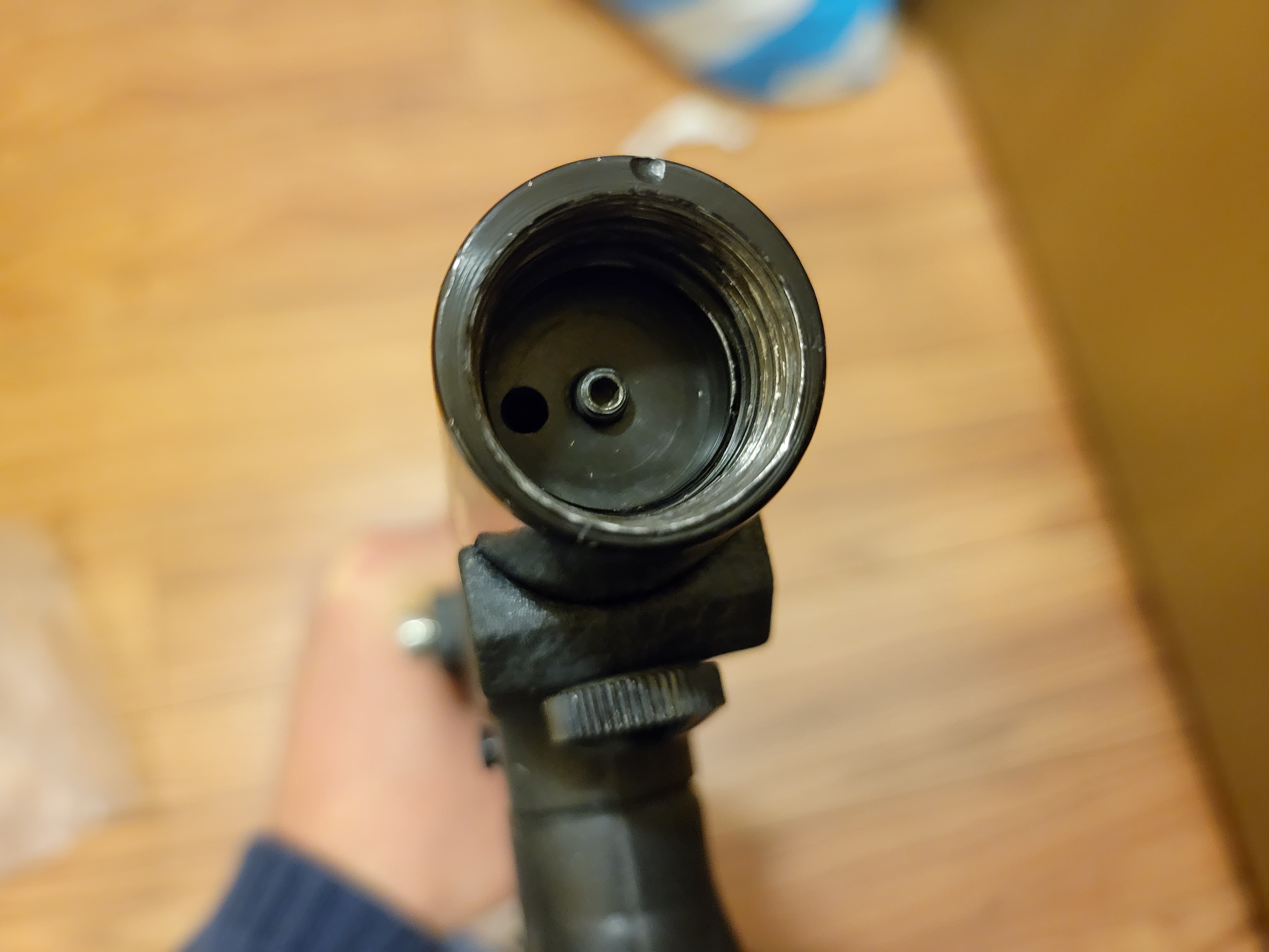

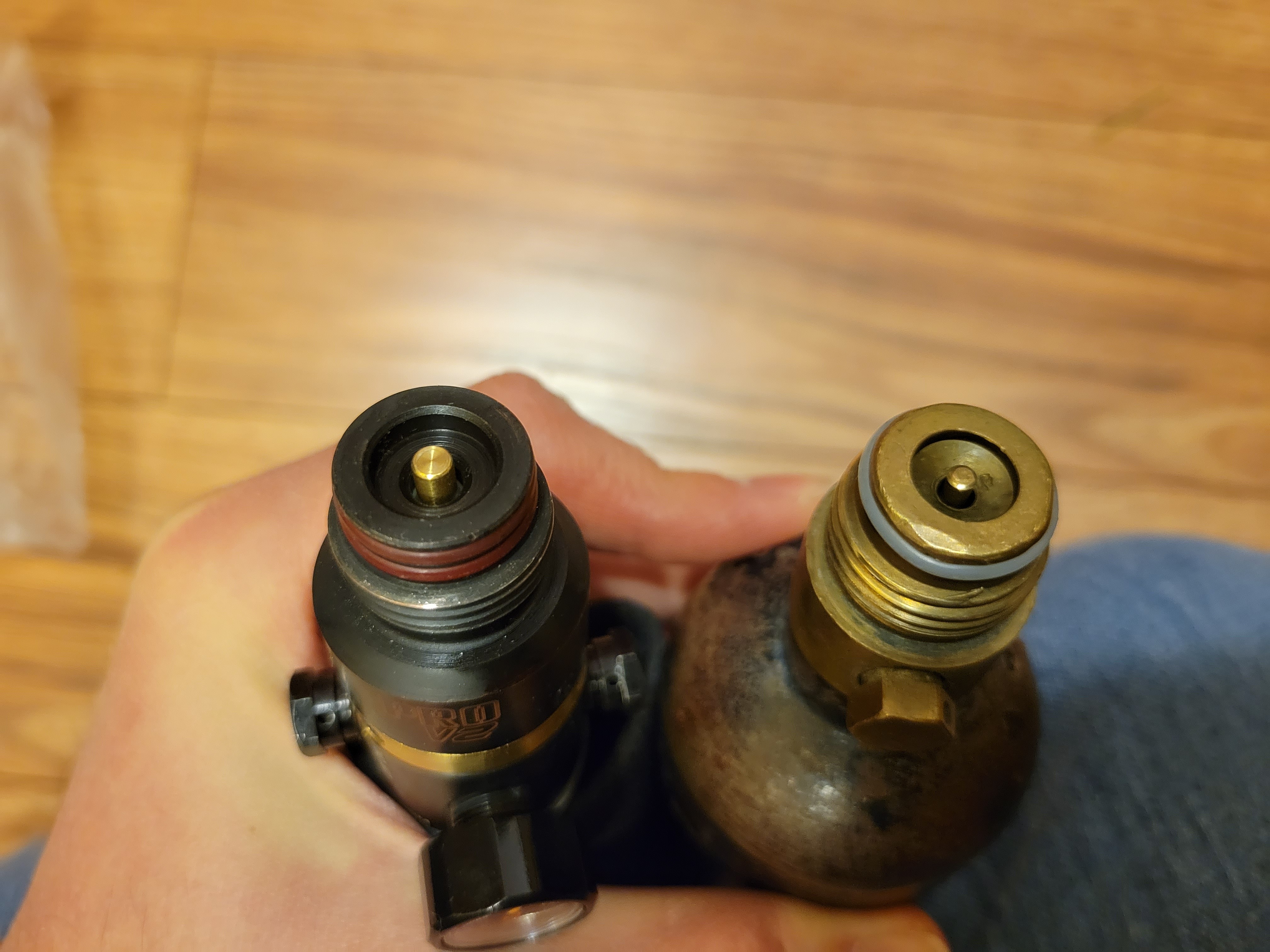

    Hi, I have another issue I need help with regarding my Diablo Pump. With my old CO2 tank, it holds air and pumps and fires properly every time...just finished trying it in the basement. However, I also got a new HPA 15ci tank with a Ninja regulator, but with the new tank the gun will shoot one shot and then won't cock and be able to shoot a second shot...unless I take the tank off and put it back on. When I take the new tank off, I don't hear any air noise either, as if it wasn't connected...but it must have connected since it'll cock once and shoot once. Is the pin on the new tank possibly not getting depressed enough by the little Allen key set screw in the ASA? I wasn't sure if that little set screw in the ASA is supposed to be adjusted at all or not or if that is even the issue. I attached a couple pictures...one showing the back of the ASA on my gun with the little set screw pin, and the other showing the difference between the pin on my new HPA tank and my CO2 tank. Any help is much appreciated. This seems to be my last obstacle getting this old gun completely up and running.

                  • 6185
                  I would adjust that pin in the ASA out a bit.
                  Low pressure could still be your problem but I think you are seeing a very low flow rate and that's what's really doing it.

                    When moving a Nelson clone marker from CO2 -> HPA you have to remember two basic things
                    1. HPA regulator output pressure should be at least 800 psi and most likely even higher then 850 psi.
                    2. CO2 gas has a higher density (ρ = 1.98 kg·m-3) then Air (ρ = 1.29 kg·m-3) so you have ~65% of the mass per volume at velocity when using HPA. So HPA imparts less energy onto the ball for the same valve train (no changes). This may require a lighter valve spring or combination of hammer and valve spring to increase the dwell on your valve to get the same velocity. This is why there are many proponents of CO2 for paintball. There are pros and cons to both and usually with a little bit of spring tweaking or pressure regulation changes you can get either to work.
                    Oh and given your description of the behavior "...gun will shoot one shot and then won't cock and be able to shoot a second shot..." I suspect that your ASA pin needs to come out a little more. It is most likely that you actuating pin is just barely opening your pin valve on insertion of the bottle in the ASA and you get a "squirt" of Air into your ASA but it is not depressed enough to have the valve open in general (2nd shot). If you want to test if this is an issue before changing the ASA pin take a straight edge and place over the Valve on both bottles and measure the gap between the straight edge and the Regulator Pin and I expect there will be a larger gap on the HPA regulator.

                      Thank you for the thorough description. Everyone has been so helpful here and also with other questions I've had so I've learned quite a lot from here. One of the last things I did try last night was to back the ASA pin out a decent amount but it didn't help unfortunately. The behavior stayed the same. I did get it to shoot more than one shot, sometimes several in a row, by holding the tank so it doesn't keep coming loose...but then about every 3 or 4 pumps it randomly won't engage the hammer properly even though it all is still pressurized. I wish I had a tester for the tank/regulator. I may have to find one to purchase in order to troubleshoot this. I will take a straight edge and check the pin distance as you suggested when I get home though.
