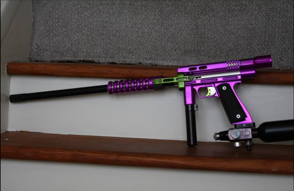

    Anyone know what O-rings are needed to rebuild a Centerflag Dynaflow regulator? My on/off finally gave up the ghost and I figure it's probably time to refresh the whole thing.
