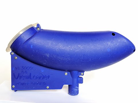

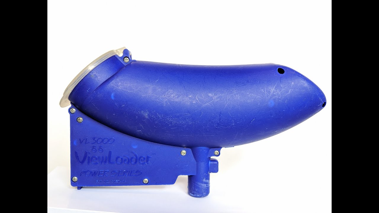

          • OpusX
            OpusX commented
            I have a VL3000 ... [cat with newspaper meme] I should put a VL3K on my Shoebox [/cat with newspaper meme]
