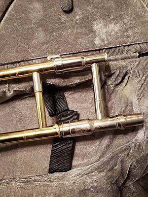

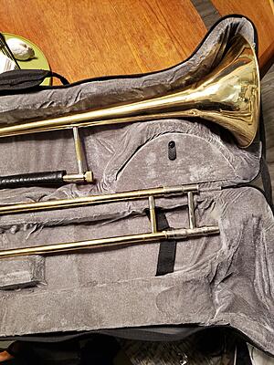

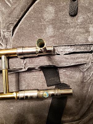

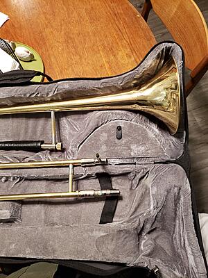

    Hey guys. I was asked to take a stab at repairing my nephews trombone he let the slide get all rusty and crappy, so it was dragging, and he broke this slide handle.
    They figured I could use a soldering iron to fix it, which I know I cant.
    I was going to go to home depot, and get lead free silver solder for plumbing, flux, a pocket torch, and some emry cloth.
    After some ypu tube research I see that q propane pocket torch likely wont melt silver solder, but I also figure with the thin walls it may work.
    On the bright side, if I wreck it they said I can havcait for making loudner.
    So how would you go about trying to repair? Should I order solder vs trying plumbing solder?

    This thread is worthless without pics ehh?
    This gallery has 4 photos.

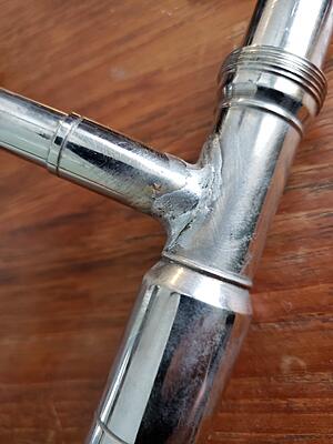

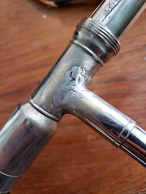

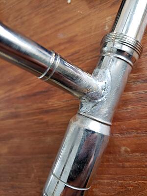

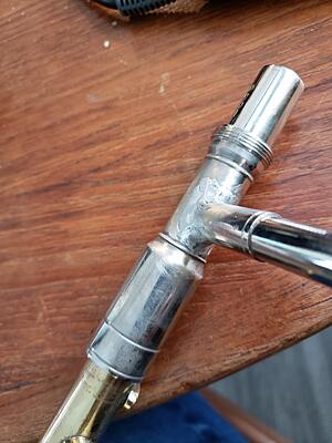

        I took some lead free solder I had, and my wife's stained glass soldering iron. Cranked the iron to 540, fluxed, and got this.. it aint the prettiest, it aint the worst I've seen, but it seems strong enough to last the kid a trimester.
        I didn't think it would bind but it did. Color me surprised.
        Thanks all.
