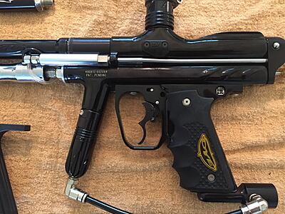

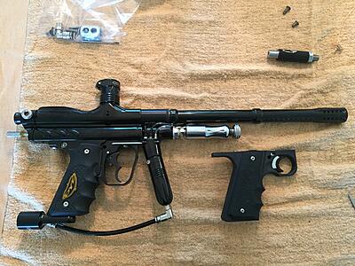

    Yo, i just scored a deal here in Canada on a parts cocker, and hooowweeee the parts!
    of course I immediately have questions.....
    For the Vigilante Reg, I assume I'll have to rebuild it, so do those Immortal Air , Air America Reg Seat and Pin Unireg kits they have also fit in the Vigilante?

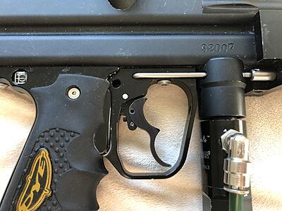

    And the Planet Eclipse swing frame does not have the PE double trigger shoe, it's something other double trigger that clearly not for this frame. It's not terrible, but it is sitting at a weird angle, and kind of looks odd, So, do you guys know of any place that might still stock the PE swing frame trigger shoe? Or even better, do one of you gents have a spare one?

        Chances are slim to none that you find a PE trigger shoe for that. I've never seen one available separately.
        I'm sure any decent machinist could make a new trigger shoe. Hell, Delrin would work fine.

          ....maybe I'll just take some meat off the end of the trigger shoe I have (bastard file) and call it done......
            I've done exactly that with a Shocker trigger to get it to fit in a smaller trigger guard. Didn't take much.

            • WORR13
              • 374
              you would need the whole trigger, these weren't 2 piece with a shoe. someone modded the trigger, oof thats ruff. you'd have to modify some kind of shoe or possibly try to find an ans trigger for it, they are similar- dont know if they fit
              *edit, sorry the early pe swing frames had shoes, later ones were one piece triggers

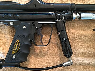

                    Modified my non-Eclipse trigger shoe to fit better...
                    and my Poor Manโ€™s Orracle is getting pricier by the minute!

                      MCB member
                      • 3511
                      • Montreal, Qc, Canada
                      This is the most expensive trilly I ever saw ๐Ÿคฃ
                      Look GREAT!!!
                      ๐Ÿ’€Team Ragnastock๐Ÿ’€
                      • Meleager7
                        Meleager7 commented
                        Yep, Iโ€™ve gone a bit crazy on it, fun though, and fast as all hell! Thatโ€™s also the ans jackhammer you sold me installed on there!
