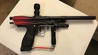

            I am currently running a GTR ram on a midblocked dye reflex with an MQ2 valve. It is currently programmed to ramp up to 15bps and it took some tweaking to get it there but I think that is more because of the peculiarities of the MQ2 setup than the ram itself. My issue was velocity dropoff at higher BPS which I diagnosed as being caused by the bolt not being all the way forward in time for the ball to fire. I should also say I am running a really low LPR pressure since I don't have to overcome the hammer spring (hence the MQ2 peculiarities). As a result to get up to speed, I had 3 choices: Change board timing which would lower BPS, increase LPR pressure which would make it cycle faster but give more kick and potential ball breakage, add a QEV.
            I chose to add a QEV on the retract side which got me to 15bps running a really low LPR pressure. I know that doesn't really answer the question but might give some considerations for how to go fast.
            Also for what its worth, modern cell phone high speed cameras are great for diagnosing cocker timing issues.
