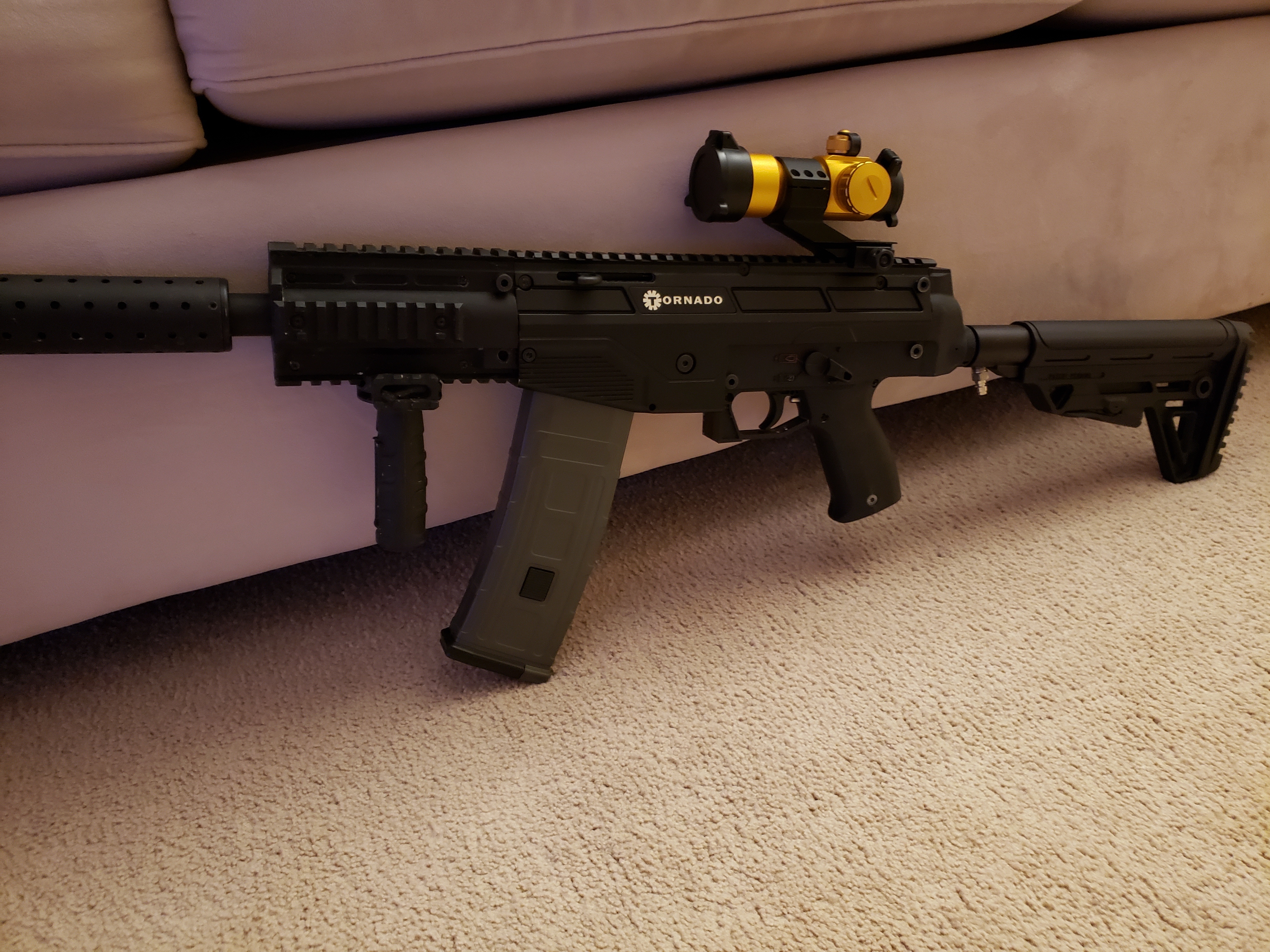

            I have an internal air kit. In this pic, I have a gas-through stock, but now I run 15ci tanks. Using any normal vertical hpr ain't gonna work.
            I also have an egrips, which I like to switch between semi and 3-shot burst, which is at 10bps. So the recharge needs to be ok, but nothing crazy. Maybe I'll look into the RG-1.

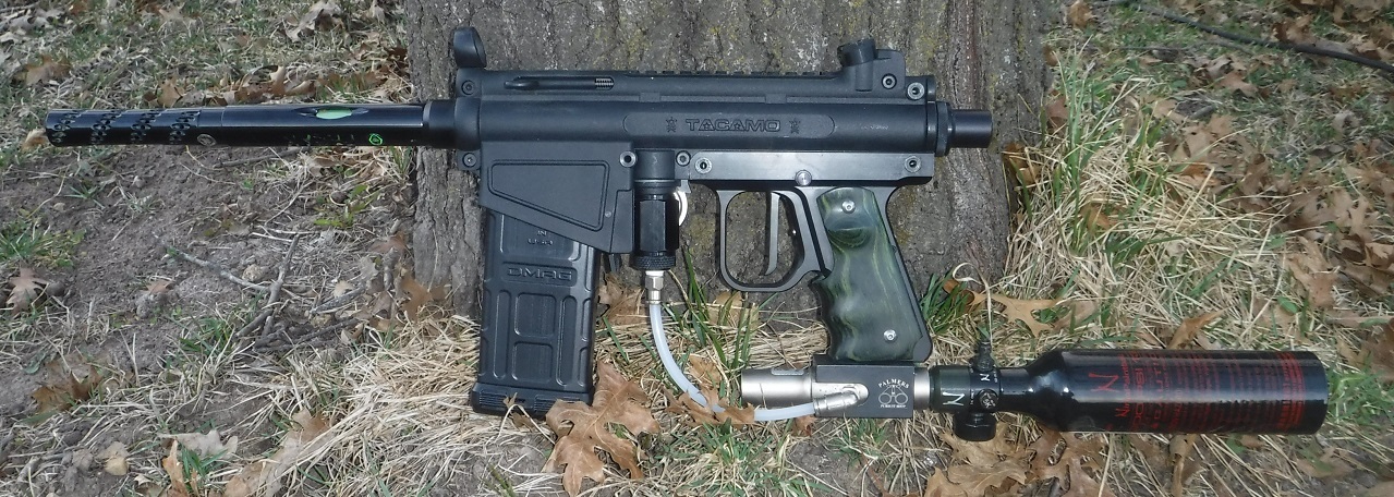

                  This is one of the reasons I tend to avoid the gas thru tank in stock setups. That and bottom line setups leave more room for masks. But anyways, with the tank in a more traditional paintball location, and having a gosh darn hose in the mix, you have multiple options for regulator placement. This one has a bottom-line female reg (which at the moment needs a rebuild, ugh), but this setup could also have a male regulator vertical behind the magazine.

                    Brokeass_baller commented
                    Yeah, but I kinda like the drop stock on mine.
                    What the heck kind of trigger frame is that? I've never seen one before.
