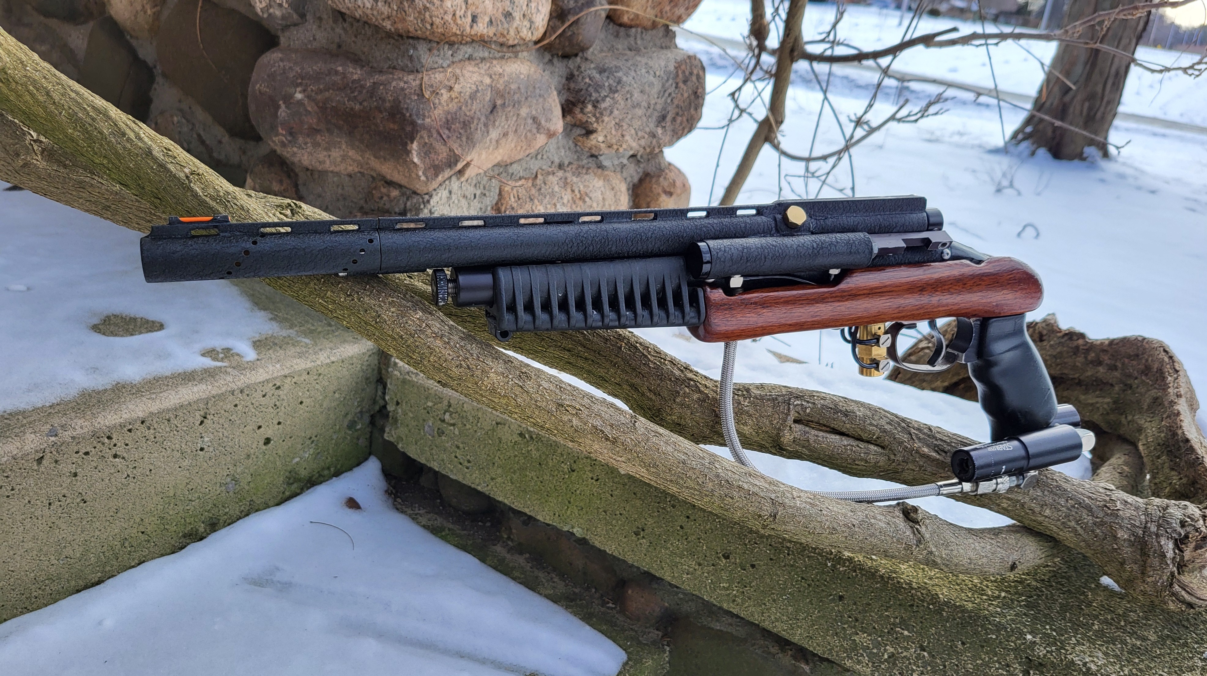

        In interest of updating this post:
        I decided in the end to build a new body that accepts PPS components and Freak XL inserts. Was it a lot of work? I suppose.... I'd be willing to do another but you might as well buy a Blazer for what I'd charge to do it.
