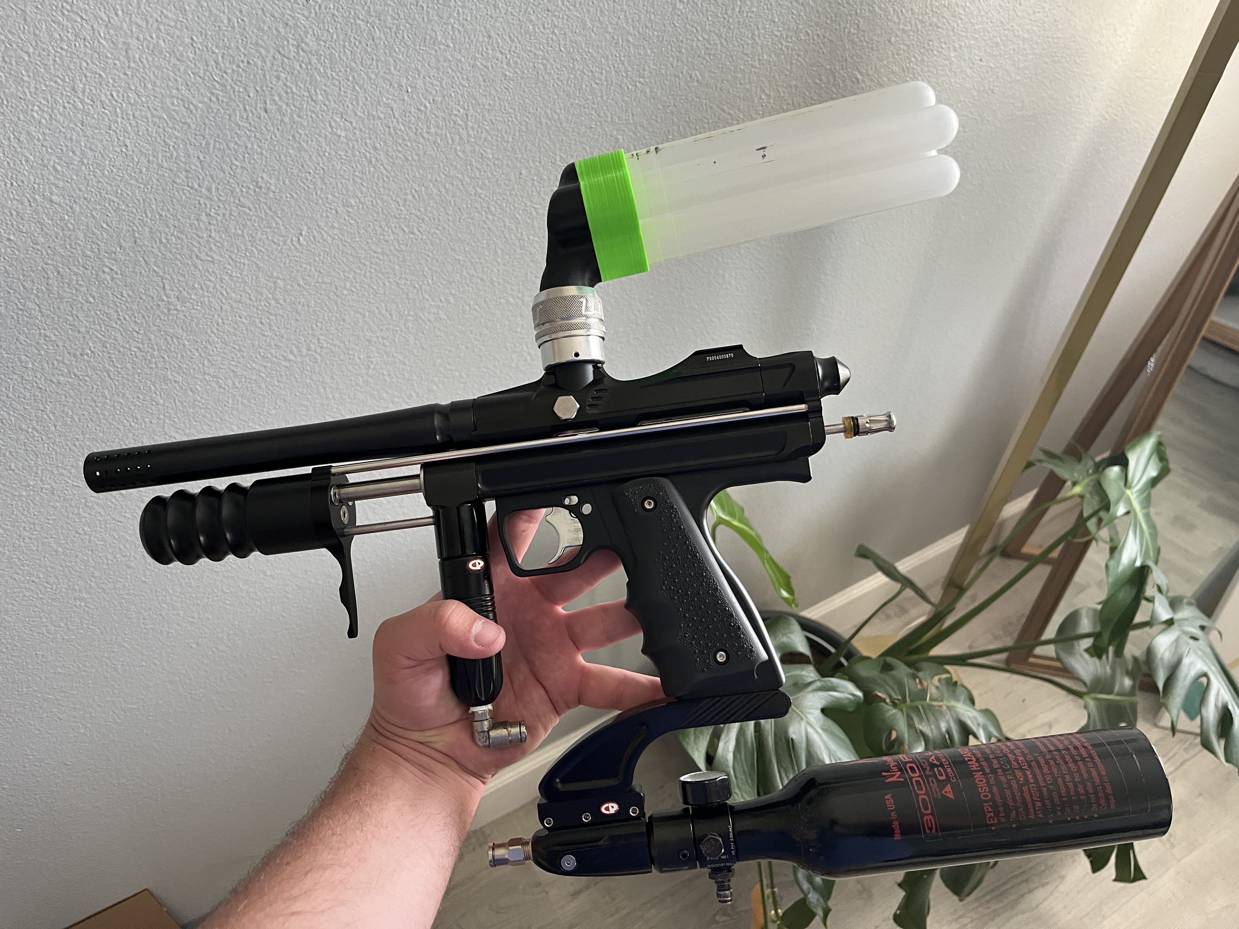

      I was optimistic, but the remote line was a no go. Still don’t have a reg tester but I’m going ahead and rebuilding the reg as the next troubleshooting step. After that it’ll be a look at the internals.
      Just look at how much this poor baby wants to really hit the field again. Lol and before someone says it, I know the macro
      line is absent.

        • redsquirrel
          redsquirrel commented
          Yes stock internals. I wish it was the bolt. Definitely fell for that with my first cocker though.
        • Chappy
          Chappy commented
          Putting a bucket changer is going to feed it 800 psi plus, and unless it’s an early cocker designed to run high pressure it will lock up and act just like your reg creeped. So I’m not sure swapping a bucket changer actually confirmed anything.
        • redsquirrel
          Darn, thanks for pointing that out. I’ve been spoiled by swapping between the two on a Phantom.
