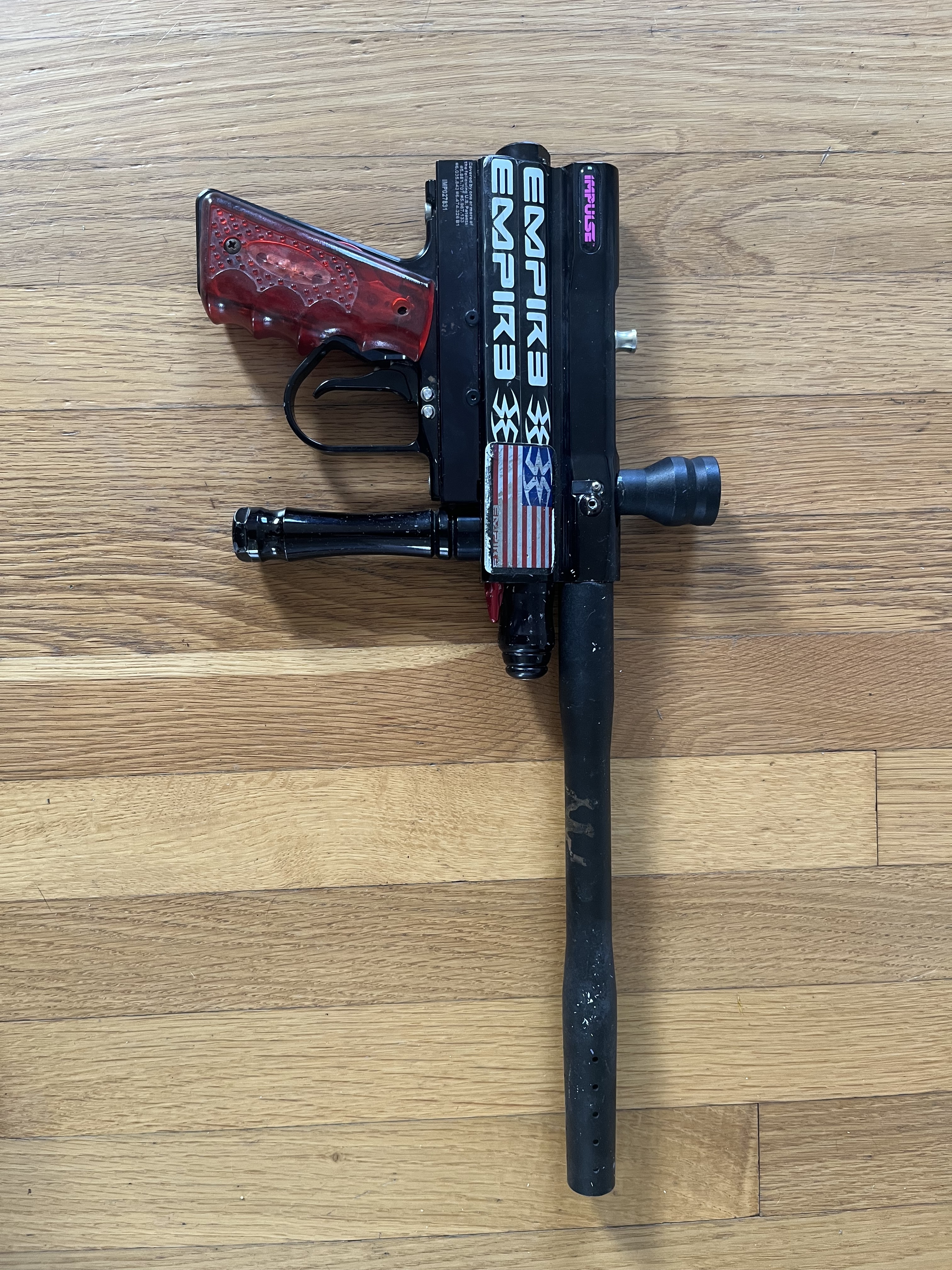

    I received a beat up, old impulse. Safe to assume it needs a full rebuild and then some.
    I know close to nothing about these markers. Where shall I start ? This is a rebuild for nostalgia more than anything else.

    That one doesn't have a reg on it so youll want to get some type of reg on there before you air it up.
      • 6182
      Yes you will need a regulator if you want to keep it classic by a 5 lb Max flow either foregrip or bottom line and bolt it on
      Otherwise it's all pretty standard sizes so take it apart and start replacing o-rings the hardest part I had with one a while ago was getting the ram apart you have to twist the hammer off of the ramshaft to get the rest of the ram out of its housing I had to use some heat to loosen up the loctite

        http://www.zdspb.com/tech/mguide/impulse/index.html
        this site will help too
