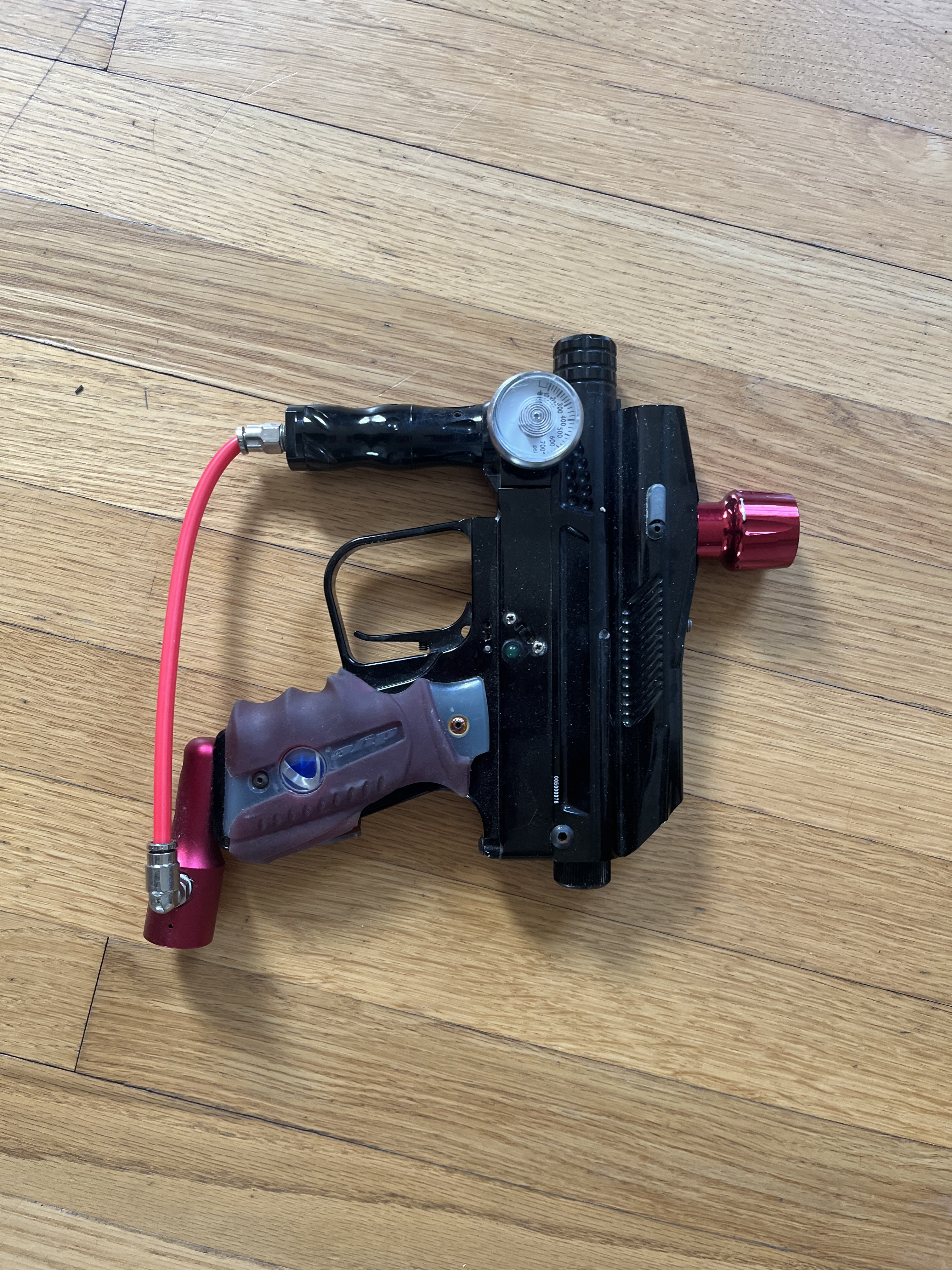

    Hey all,
    I received a bushmaster, I am not sure what year / model.
    considering doing a rebuild. Is it possible to get parts ?
    Thanks

    Well for starters.... That's a bko

        BKO minor rebuild kit ...that should get ya started.😉

            If you want to break it down yourself I could help. I've owned a number of these over the years. They're not bad compared to their higher-end poppet counterparts. Just tedious with the extra tray screws.
            If you are planning to use it for actual gameplay, I HIGHLY suggest swapping out the HPR. Those are notorious for being straight-up junk.

              I've rebuilt a TON of bushmasters over the years. Unfortunately never had my hands on a BKO, but they are super similar, just a fasor instead of a true EP. It should be REALLY easy to rebuild it yourself. The biggest weak point on the ICD electros is the wiring harnesses are crap. Very thin, very brittle, very old wires. I'd honestly just recommend a new harness from Sam (vapor works)
              https://www.vaporworks.net/?product=...wiring-harness
              Other then that, vapor valves and bolts for the B2k will both work in BKOs as well, but they are really hard to find now. Be sure to check out my tuning guide for getting B2ks to shoot modern paint.
              https://www.mcarterbrown.com/forum/p...ng-paint-fixes
              I do typically replace the HPR's & LPR's, and given it's age I'd just replace every seal in it. Should just be standard buna "o" Rings you can get at a hardware store, late 2k3 and 2k4 bushmasters need 90 durometer on the manifold, but prior years you can use 70 durometer just fine. Obviously you need 90 durometer for the ball detent too or it wears out really fast.
              The solenoids in these are rock solid. You should have zero issues.
              Just let us know if you have any issues or questions. They are excellent guns that can run forever with minimum maintenance.
