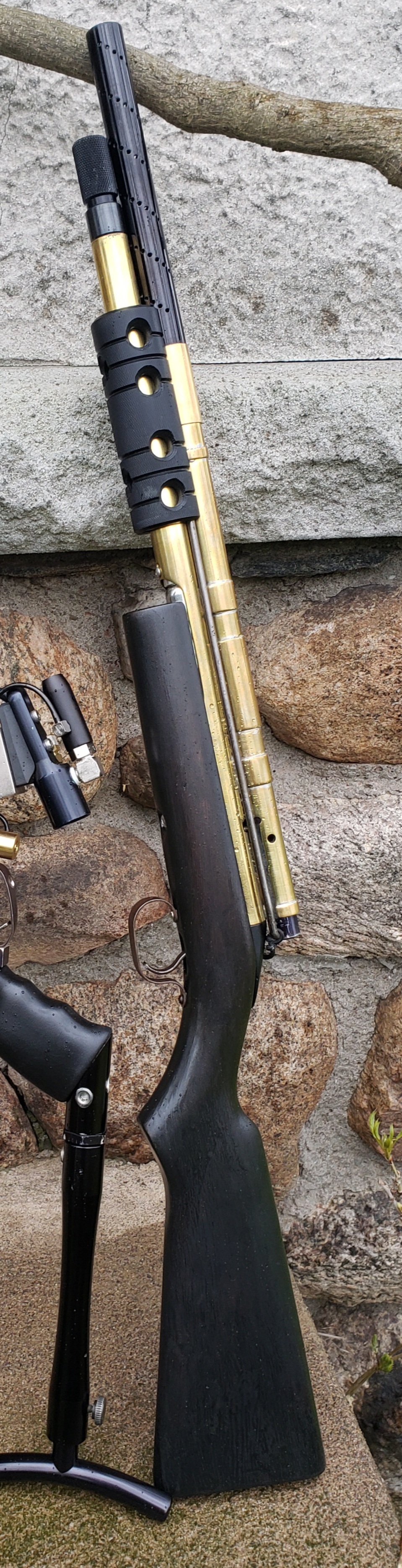

        Glued... I took apart a damaged AA and used the tip on my KP project.
        Took some heating to separate - I used a propane torch - and to reassemble I used two-part epoxy.

        I sure love spiral venting on a plain tube. Glen Palmer invented that right? Thanks Glenn.
        That KP does look amazing.
