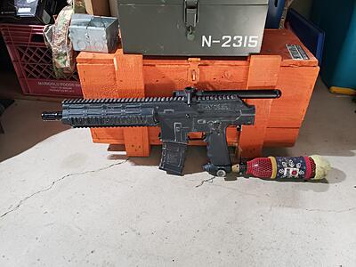

                            • 3411
                            Im a total sucker for the tm15. Ive had qnd sold one a few times. I bought this one and pimped it out then I just pull it out from time to time.
                            Pot scrubbers glued into the internal baffles.
                            32 degrees nightstick
                            Ape board
                            Flasc single trigger
                            Its quiet as can be and the bolt out back design is far superior to the tm7.
