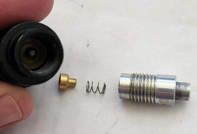

    Trying to get my EM1 up and running and have been having issues.
    First issue is I couldn't get velocity above ~230fps.
    Tried using a Spyder bottom reg, then switched to my Palmer Female Stab, adjusting pressure between 200-500 psi, but not doing anything.
    The LPR is adjusted to the point of venting then turned down half a full turn. I can't test it but I know it should be somewhat high, around 90psi.

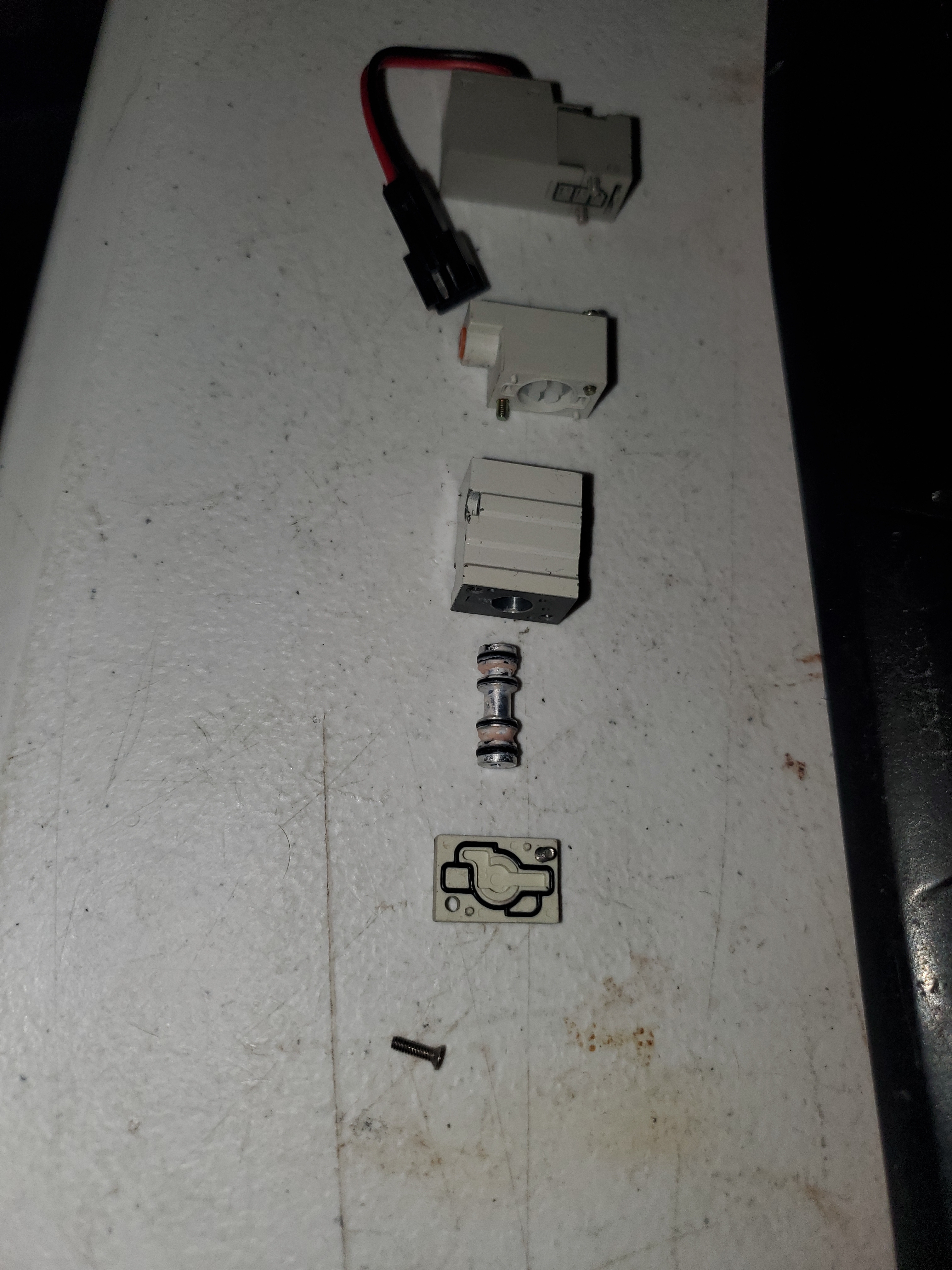

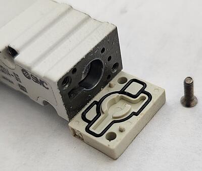

    I disassembled the whole thing, even tore down the SMC solenoid. Lubed everything with Dow 33 and put it back together.
    Now the noid clicks but does not fire.
    I goofed something up. Anyone have the assembly directions for each part?
    Edit: not humphrey, it's a SMC solenoid

      This is laid out exactly how it should sit: 20230703_130518.jpg
      • Seajay
        Seajay commented
        Thanks looks like I have the end cap upside down.
        Long side is opposite the long indention in the body.
