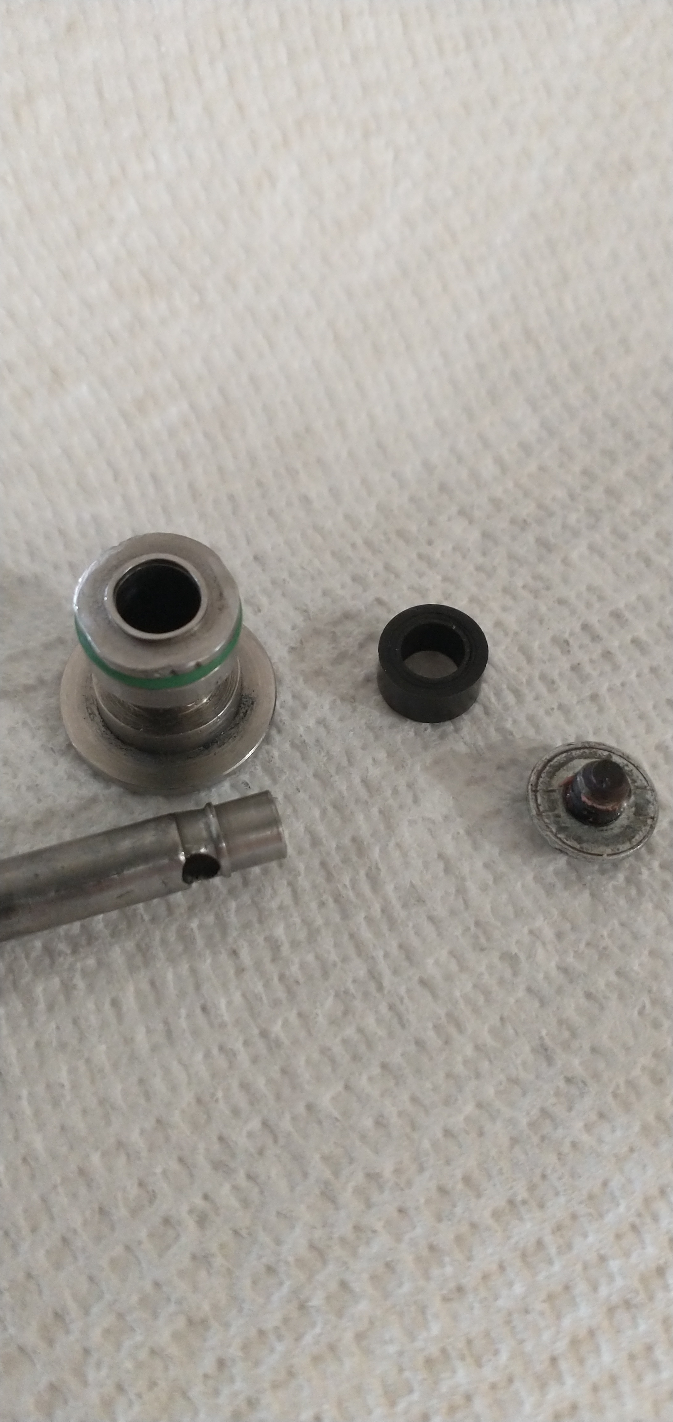

                  Looking at it, I'm starting to remember why I converted mine to a Nelson power tube. I think I got that screw out, but not the seal. I also don't see how the original seal can be any amount flexible while sealing against the screw in the center of it. I think I started with a random no4 Nelson tube, but it let me cover the end like a regular poppet.
                  I'll try to get it apart this weekend.
                  • Spider!
                    • 542
                    • Houston
                    IMG_20230714_102845979.jpg Red loctite on the screw. Seal is very hard, which led to leaks, which led to valve fiddling, misalignment, and crushing. The valve body and power tube steel is quite soft.
                    I'll draw up a model of the seal. Being softer might require a metal sleeve to keep it from expanding over that little lip on the power tube.

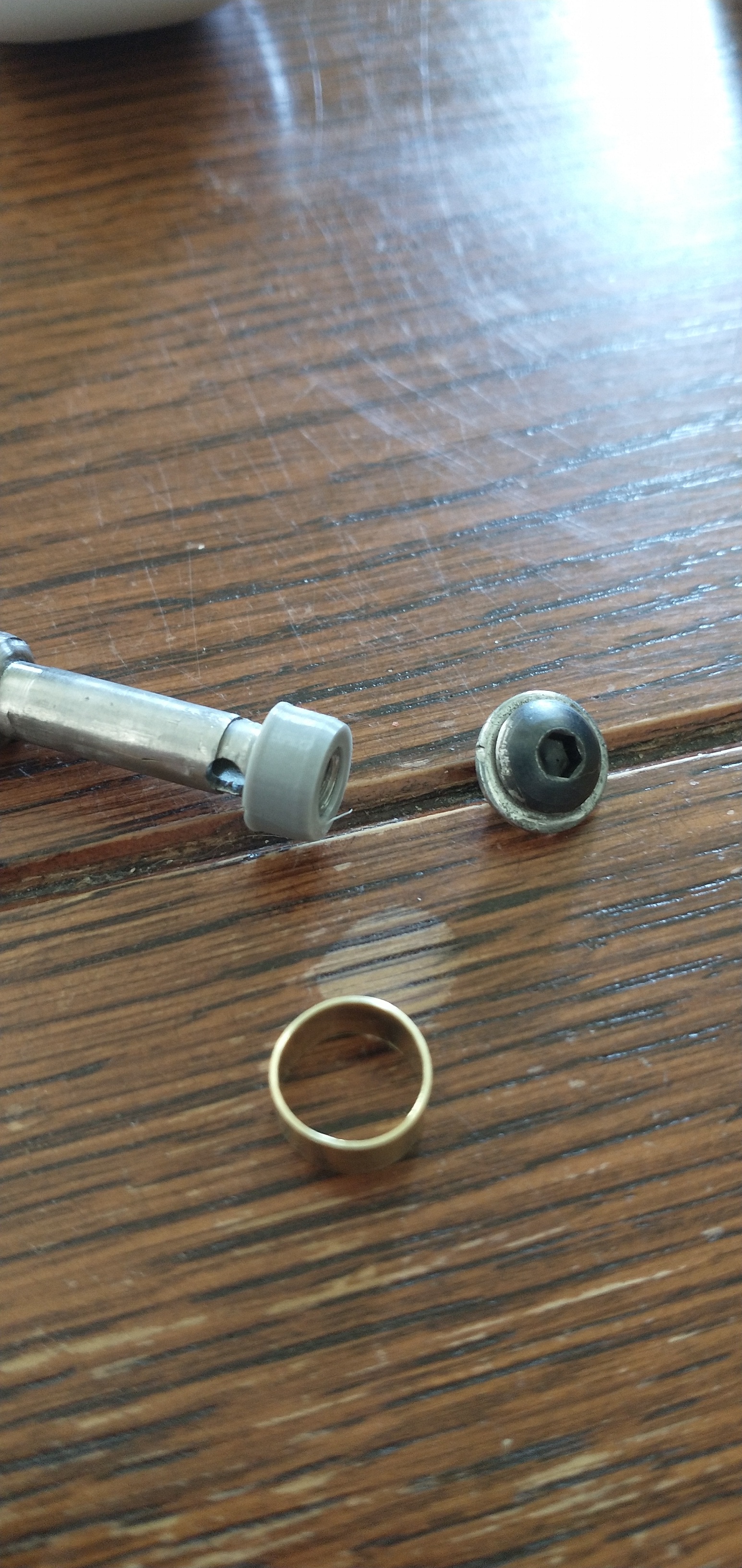

                      Do yours look like this? I can send you this for testing (seal and ring). It's possible the seal will work without the ring, so I can send a few seals.
                      I've used this filament on a12g Piranha setup for a while now, but it doesn't have that open back. I'm not concerned much about the seal face as much as the seal around the tube.
                      The seal goes on first with the chamfer facing toward the back, then start the ring over the chamfer and finish pushing the ring in place with the screw. The screw needs at least blue loctite as a sealant to prevent leaks through those threads.
                      The ring is 3/8" id k&s brass. My sl valve doesn't use the old power tube.
