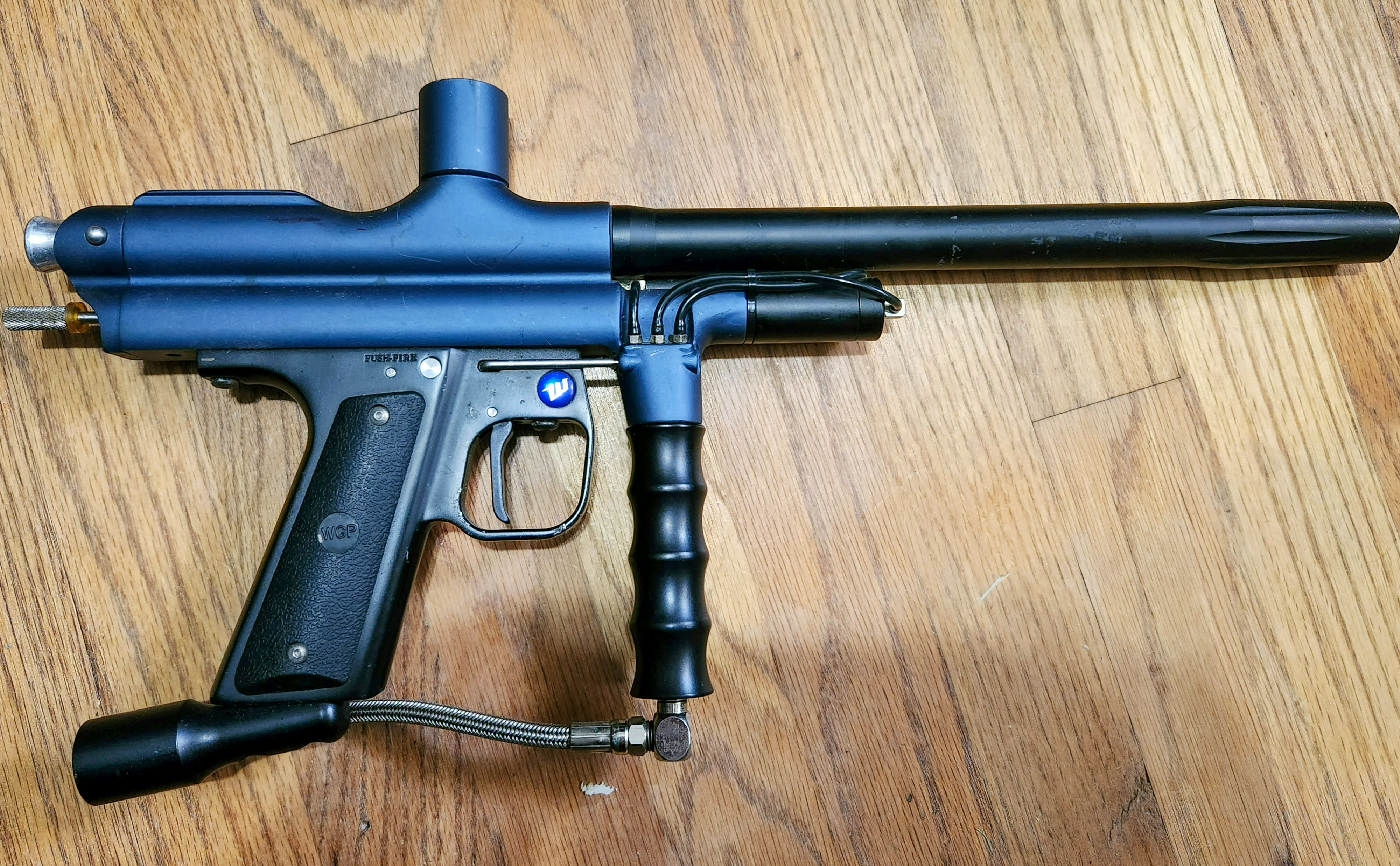

    PSX_20230721_115815.jpg So I had forgotten that a while ago I had gotten this over someone years ago. I have no idea what it is I think maybe a spyder?

    WGP Trilogy Sport

      that makes more sense. now I need to see what I can do to this thing, not even sure it is working currently

      considering that, I'm pretty sure this thing is stock, any other things I should look at doing to it that will improve it?

    I'd try a bit of oil, air it up, and see if it shoots. At that point, just rock a Trilly.
    If you want to get a bit creative, getting the barrel Freak bored to prevent rollouts and possibly a clamping feedneck mod from superman .

      Not the prettiest markers out there but they do work well. Getting a clamping feedneck modification would be one of my first modifications.

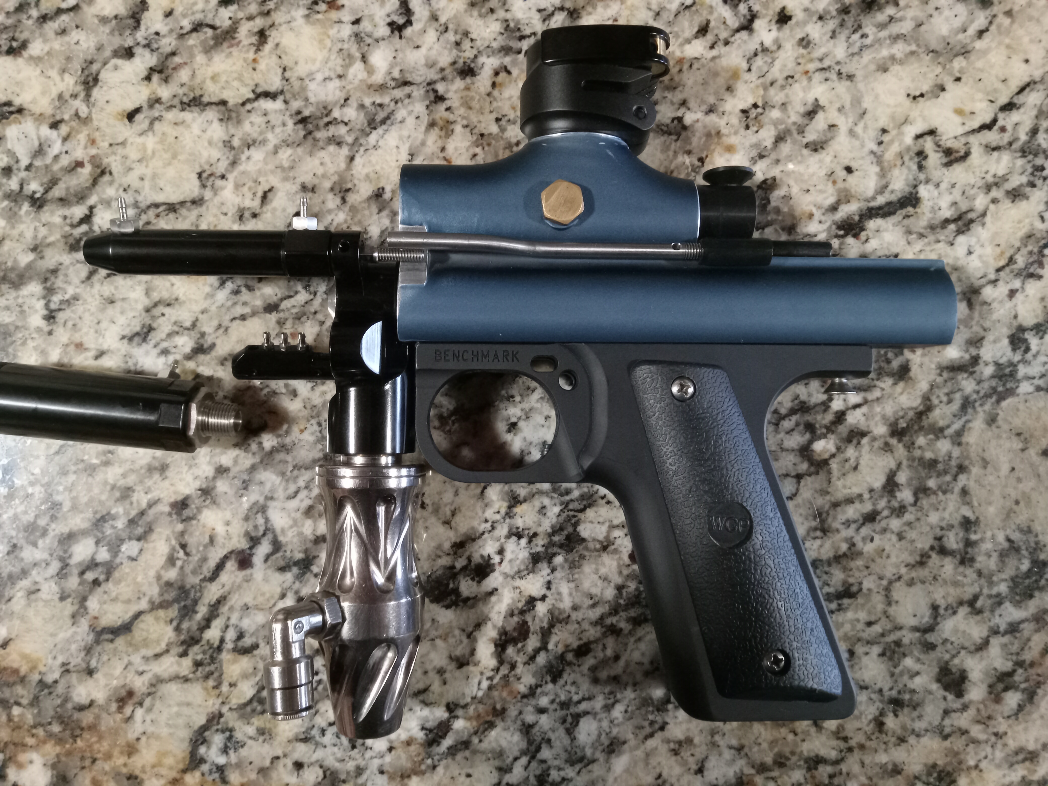

            My build so far
            • Psycho91
              Psycho91 commented
              I will say if you ever go this deep just know that parts may not all just bolt on perfectly, like on this i have to shave the back of the front block so it seals against the body and add a small shim underneath to keep it from rocking, oh and I don't think the bolt that came with this will work on this body, i dont think derlin pins are good for this either but guess ima find out, it's always gonna be something until your finished with it
            • superman
              superman commented
              only because they forgot to leave the lip on the front of the body.
            • Psycho91
              Psycho91 commented
              Yeah i know, its all good no biggy when I finish this it will just have its own specific parts lol
