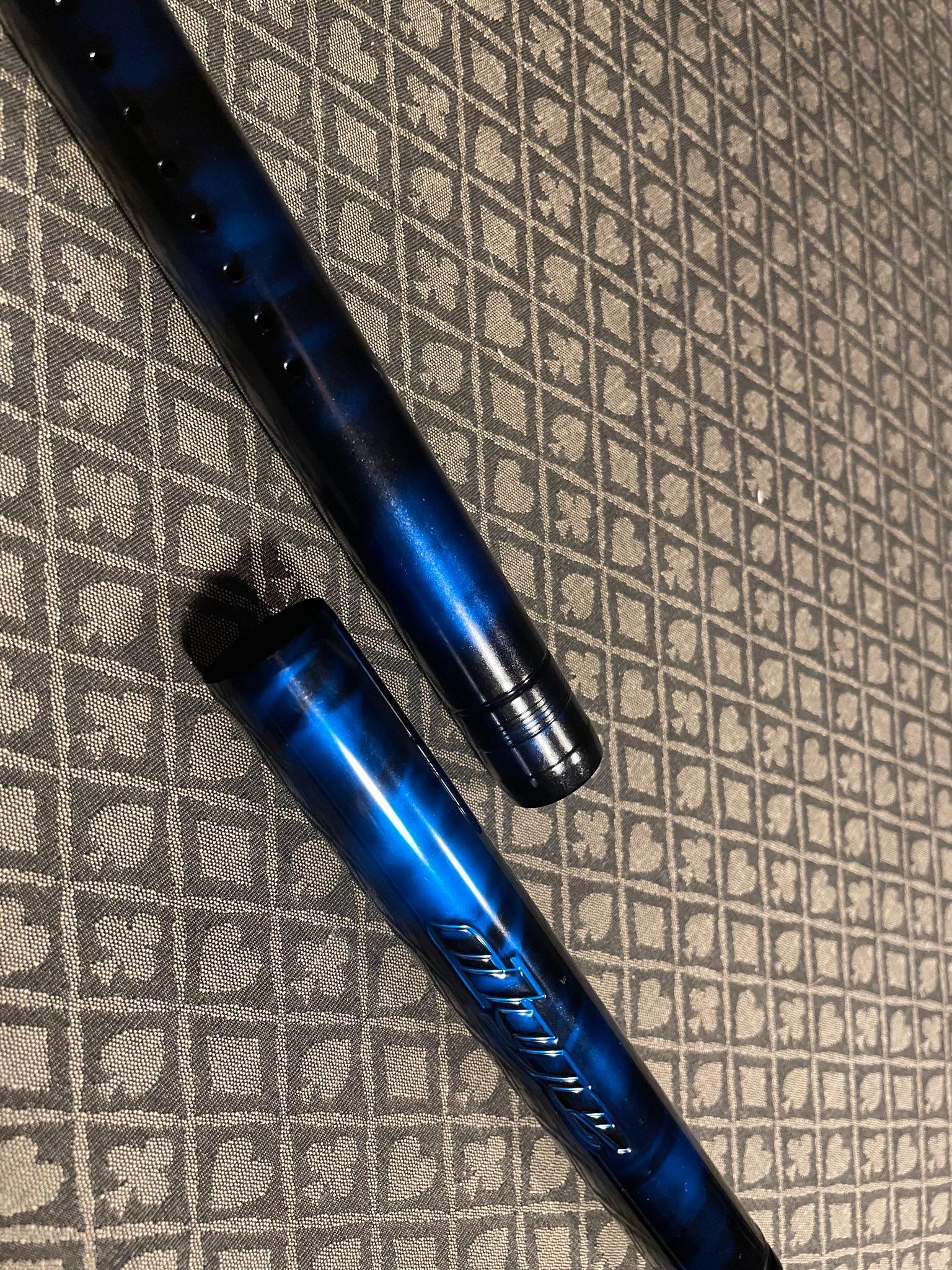

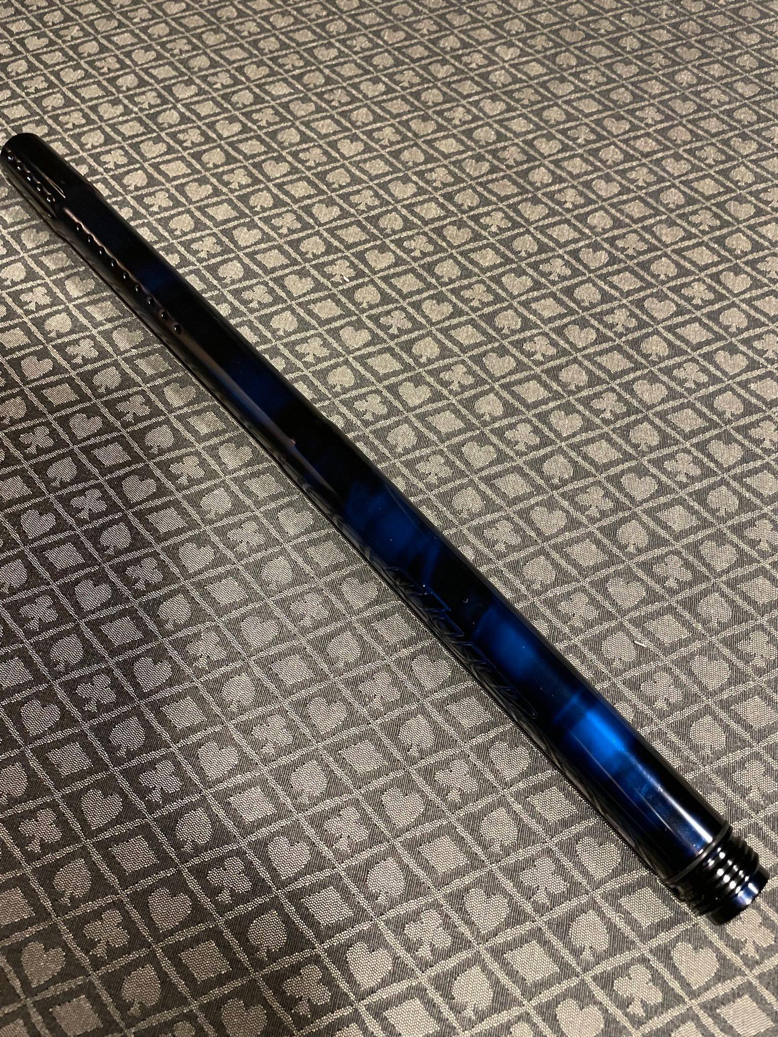

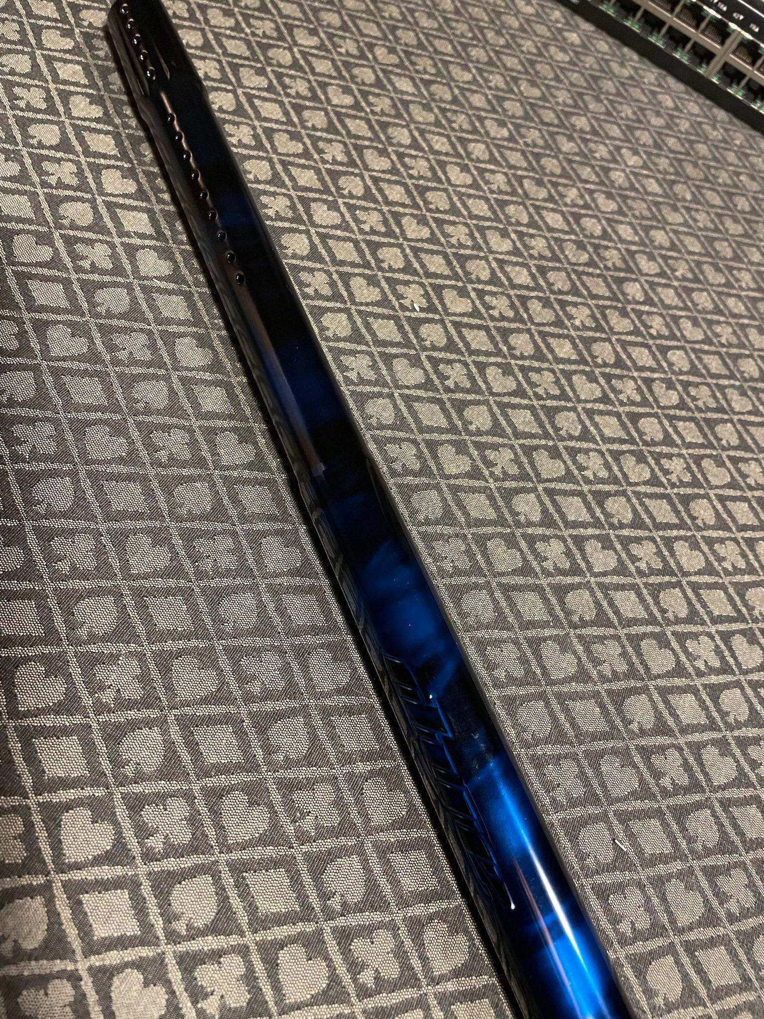

    I'm hoping someone has some obvious answer I'm missing. I need to know how to epoxy a Dye two piece barrel together. This is a Phantom barrel I got in two pieces but there's just so much play in the point of attachment. Almost 1/8-1/4" as you can see in the photos I took with the lines on the poker table if I pull the tip back and forth on the bottom half. How do you attach these in a way that ensures the bore is straight? Is there a tool, special trick, specific o ring???

        Not familiar with the phantom ultralights but something looks very off on the back half of the tip.
        Generally the glued dyes I've pulled apart have a slight flair and two machined in grooves. Yours looks like someone turned down a threaded tip..... That would be considerably thinner
