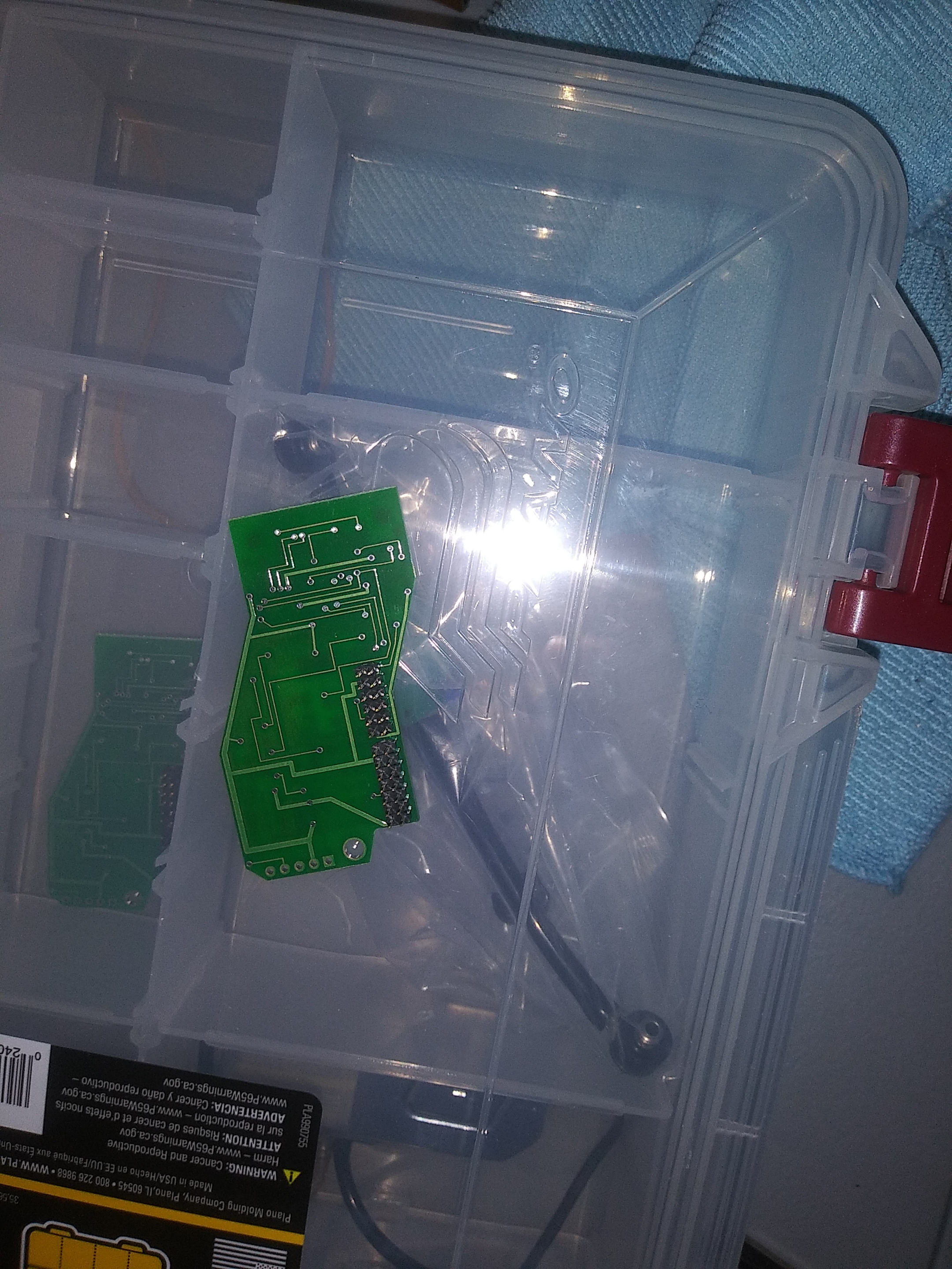

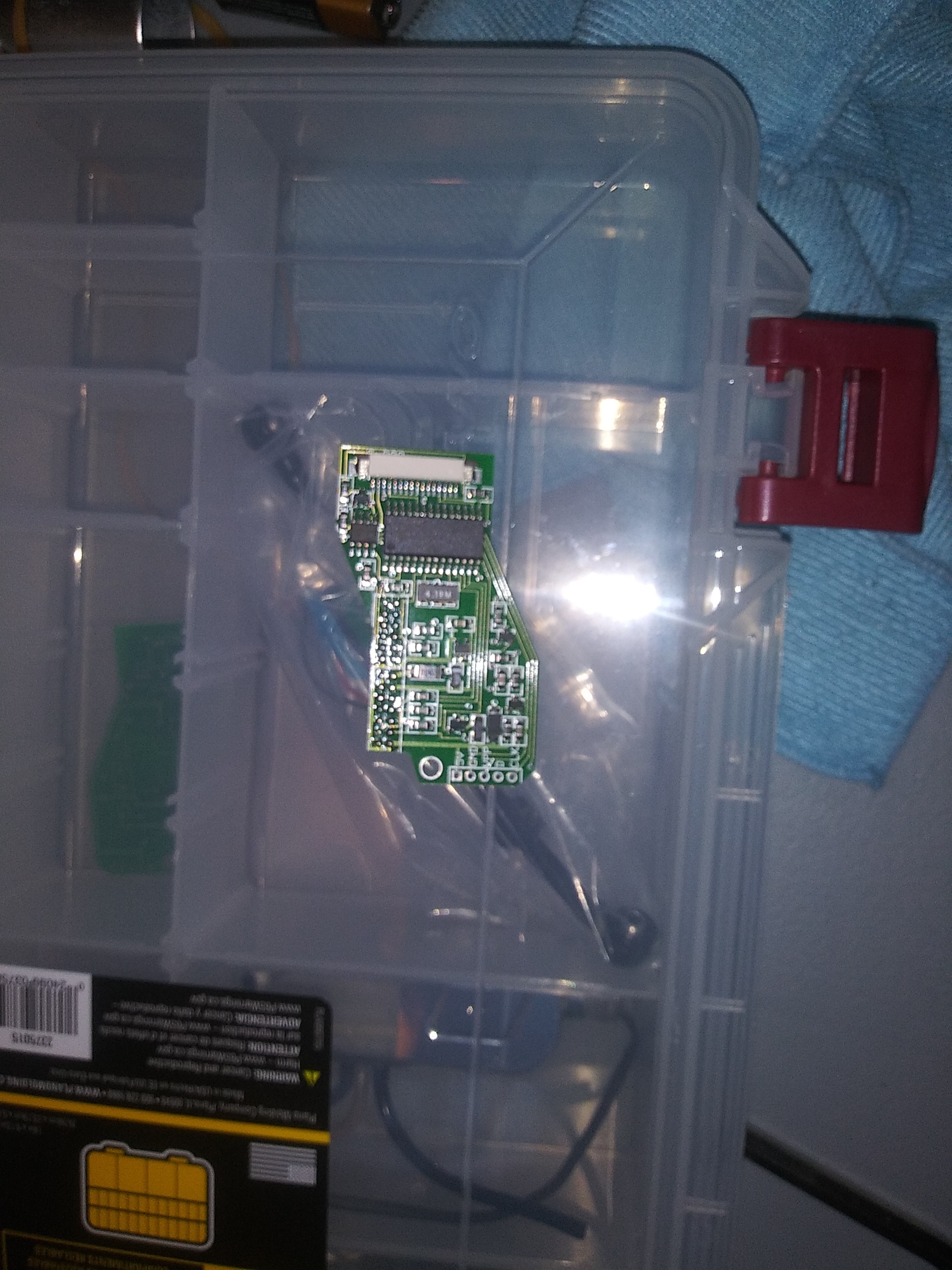

    I would like to upgrade the board in my matrix and have a couple of spare 2k2 intimidator boards. I'm thinking that as long as I can verify if the voltage sent to the noid is the same I should be good right?
    Has anyone tried this before? If so what hang-ups should I look out for?
    Fitting it in the frame shouldn't be too hard since I have a 3d printer

      I have the gun 12 chip currently. My goal is to make it easier to tune the dwell, the added firing modes are a nice plus as well. And I already have the Timmy board on hand so its "free"
      I also have a spare set of break beam eyes from a proto rail that should work with the Timmy board. So if I want I could mod my breach in the future to add eyes

        The timmy manual I found online references a different board then the one I have. That one apparently can go up to 50ms of dwell, mine only goes to 16.5ms so it won't work or would work poorly.
        I don't have a harness but I do have wire, a soldering iron, and connectors that i can make work. Not that it matters now tho.

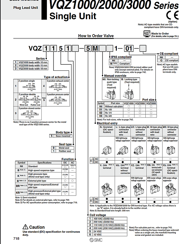

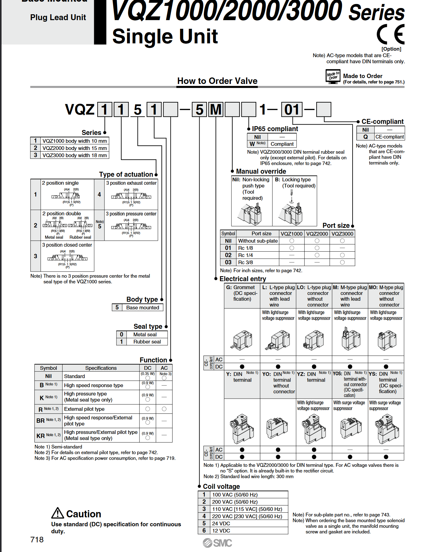

            for people in the future, here is the info I found before giving up
            1. The matrix solenoid part number is vqz1151K-9g-x86​ i couldn't find the voltage but did find the how to order section of the datasheet which mentions the operating voltage but doesn't have data on our exact part number
            The noid in my 2k2 has the part number of HEA10FS-GL-101W and states on the label that its rated for 5v. On the label in small print on the bottom right it says 42H not sure what this means but hey it could be useful idk.
            also attached is the datasheet for the matrix solenoid
