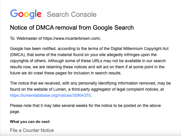

      Ahahaha... This thread just received a DCMA from google.
      Click image for larger version  Name:	Screen Shot 2023-09-20 at 9.28.01 AM.png Views:	0 Size:	85.7 KB ID:	451276
      Apparently I can file a counter notice. I'll do it just for fun to tell them they are idiots to blindly do it. Apparently y'all upset some casino company. I literally couldn't make this up, it is beyond stupid.
      Here is the description of the copyright claim:
      Fraud is being committed by using the imitation name of our licensed betting and casino company. The contents of the website is owned and operated by 1XCorp N.V. as a License (Curacao license No. 1668/JAZ). Klafkaniro LTD (НЕ407770) provide processing services on the website Billing Agent and with a registered office located at Christoforou Perraivou, 2 KALIA COURT, 2nd floor, Flat/Office 2, 3025, Limassol, Cyprus. https://verification.curacao-egaming...main=1xbet.com
      I wonder if I can counter sue google and said company for an obvious false claim?
      I am the admin...
