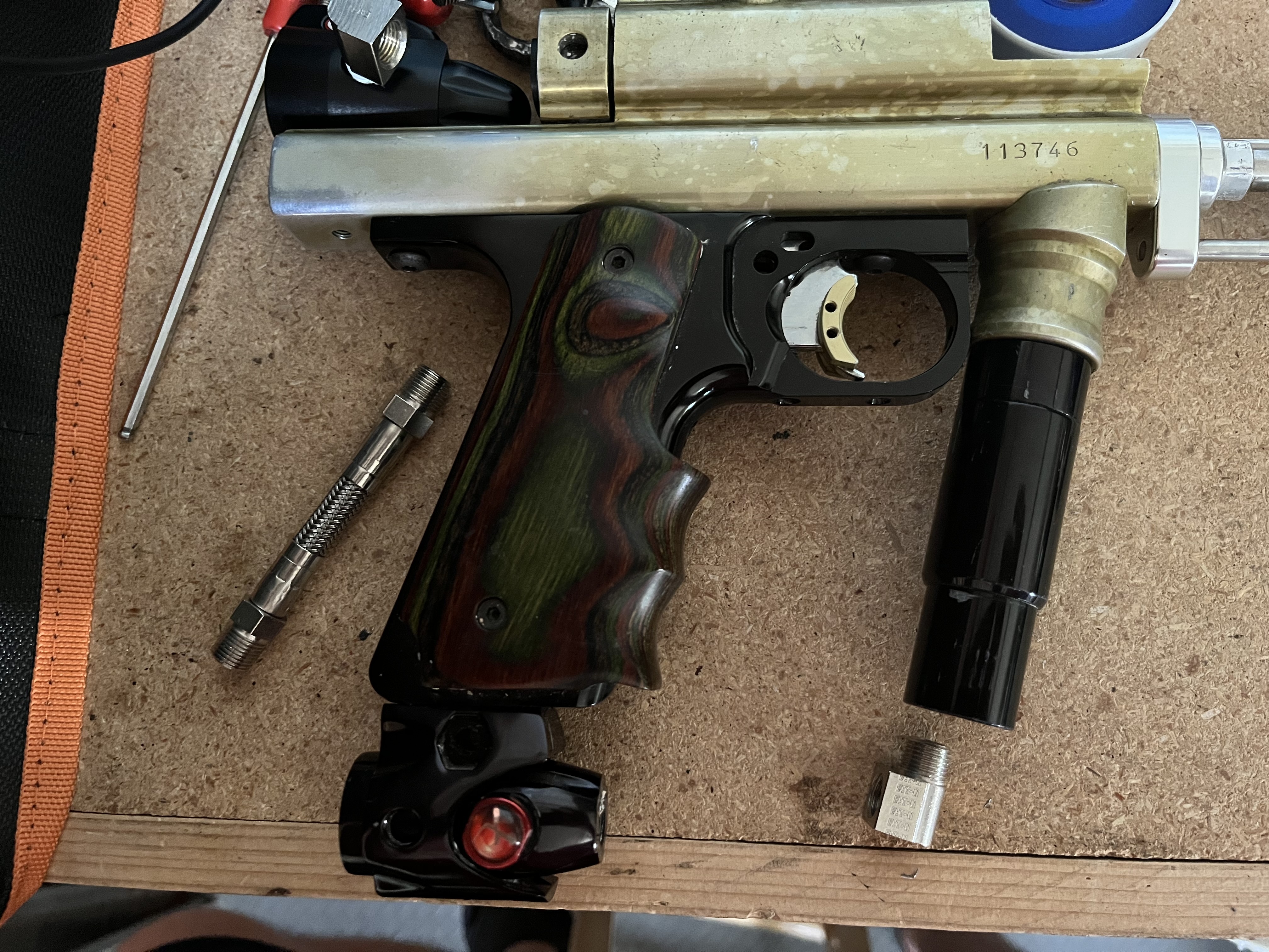

    I’m swapping ASAs on this Sniper and with the variety of steel braided lines I have or have picked up I can’t make it work without a pretty harsh kink. I need something a little more open than a 90* elbow, but does that even exist? Haven’t found anything at ANS or autocockerparts.

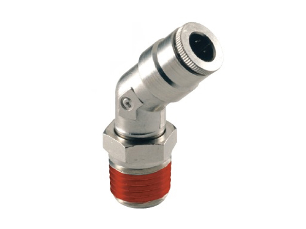

        45° brass elbows also exist, if you prefer to retain the SS braid.
        • evilfishsticks
          Spatula City
          • Oct 2021
          • 428
          • Chicagoland
          Paintball wizard has 45 degree fittings in stock for 4 bucks. When i got back into paintball a couple years ago i went to the local paintball shop and dug through their parts bins for a handful of them.
          https://www.paintballwizard.com/products/45deg
