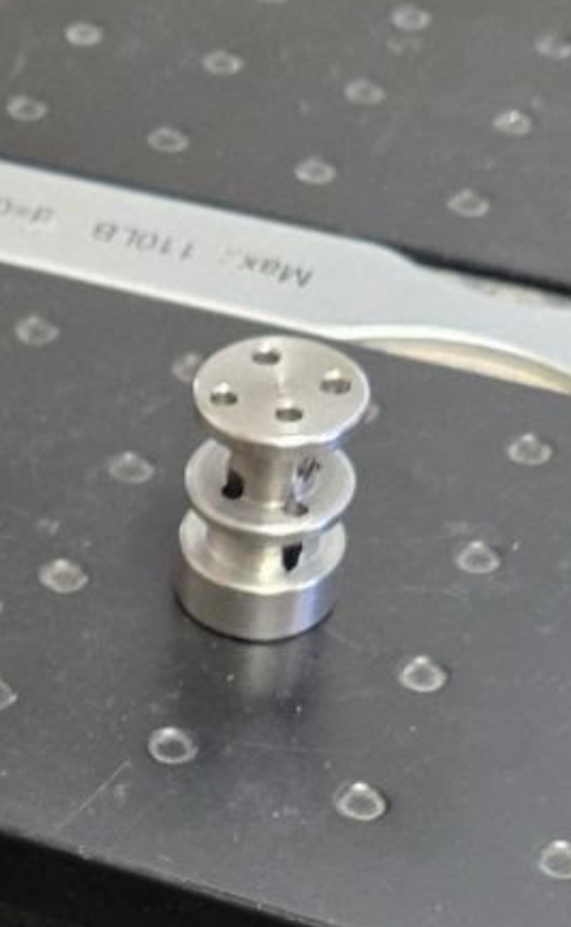

      you can change the springs in the Laz valve for different setups. I have spring rates going from 2-lbs/in up to 16-lbs/in for both laz valve springs and hammer springs. Depending on the many variables, valve chamber size, reg flow rate, hammer weight, and spring rates, how fast the back pressure builds- each marker has slightly different needs. For example in a trillogy, If you want to drop to the 160 psi range and not have 10fps swings each shot, increase the spring rate in the Laz valve.
      speed hammer out of stainless 20g - Photo credit BMC - who machined it for me
      • Tracker
        Tracker commented
        Thank you for sharing this info,, cool hammer

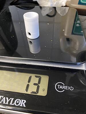

        PTFE 13g with lug
        • tyronejk
          tyronejk commented
          How's that shoot with the Laz valve? What's the rest of your setup?

        Have not shot paint. Dry fires nice pop. Probably shooting 250 right now, my guess.
        SS-25, hoping to try air and stockclass soon. I did not swap the u oring yet, will see if it holds co2.
