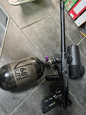

    I just picked up a low pressure kit for my old (non ACT) 98 custom which has an RT and Cyclone. It should be here Monday. Thing is, after watching a bunch of install videos on YouTube I can’t find out if the low pressure kit is compatible with the RT and Cyclone.
    Is there a spot on the new low pressure valve for the RT to screw in to? Will it provide enough pressure to power the RT and the Cyclone? I bought a new CP V2 reg with gauge adapter and a reg gauge. I planned on running it at 400psi (maybe 450psi?)
    Any help or education will be greatly appreciated!!

                        I got it all installed. The power tube that came with the kit did not have the RT port so I did end up having to swap valves and reuse the old power tube. No leaks and it cycled great. The RT and cyclone are still functional as well. If I had to guess I would say around 8-9bps. This is with a 300psi SLP. When I set up the reg I think 400-500psi will be the sweet spot, hopefully.
