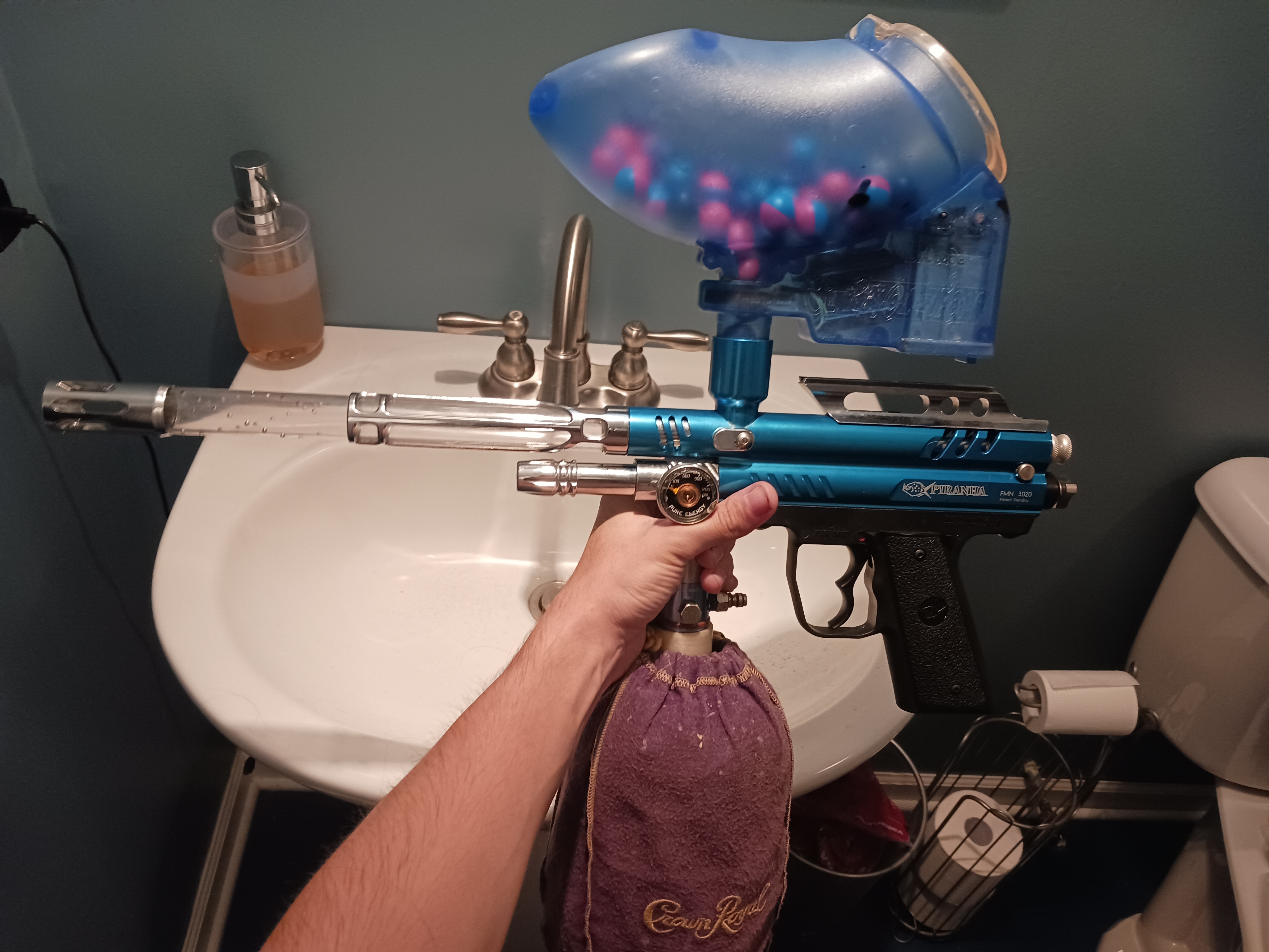

                      I should have mentioned it's an unregulated vertical feed mechanical Spyder (I think Xtra?)
                      I opened the valve and it's super clean inside (surprising considering the outside). I was also happily surprised at the ease of service on the things ... I'm leaning there due to the simplicity and ease of repairs. I'll throw a few oring in the frame to have the handy if needed 😁

                        • Tarsun2
                          • 1031
                          yo, do you keep that in there? or did you just go in there for lighting lol
                          the "newer" spyders (with the mate finish) are really as easy as it get to work on.
