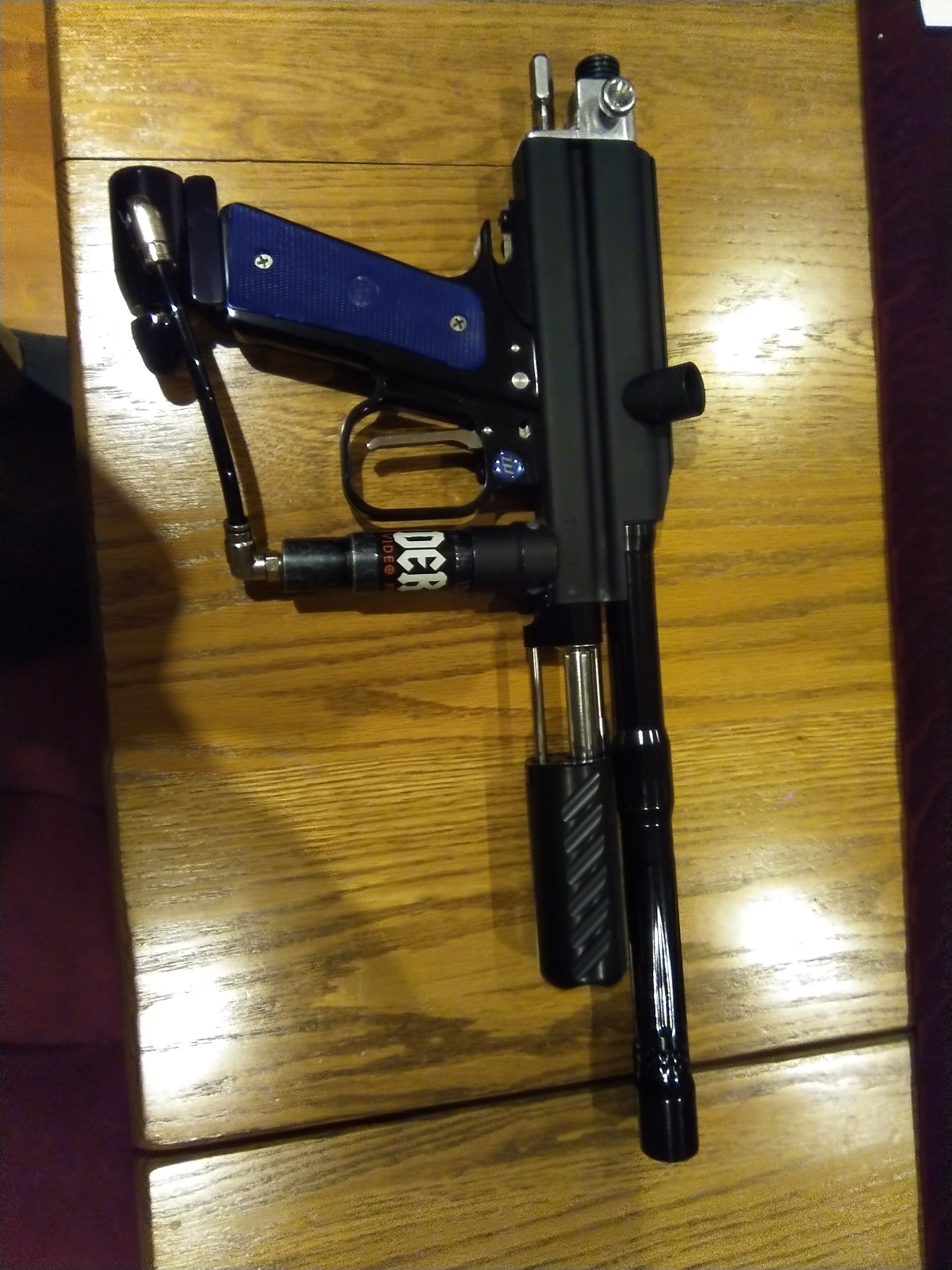

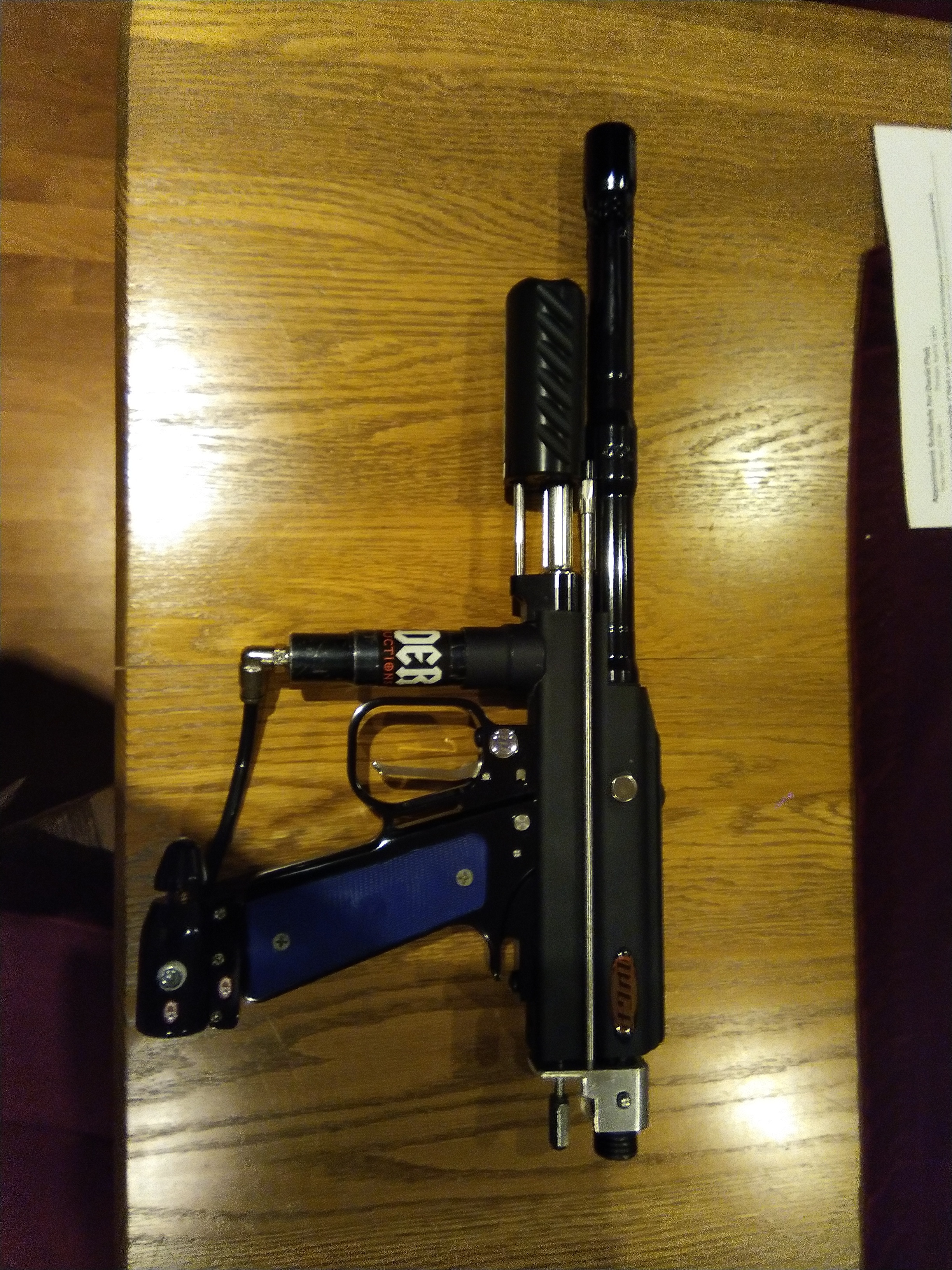

        So it's all installed. Haven't got a longer spring yet. Have a feeling I need a barrel with a smaller bore. Any recommendations on a good all around size if I'm not going to buy a kit? Click image for larger version

          And a cocker has been returned rightly to its origin, "bravo zulu"! Next is to replace the unsightly double trigger
