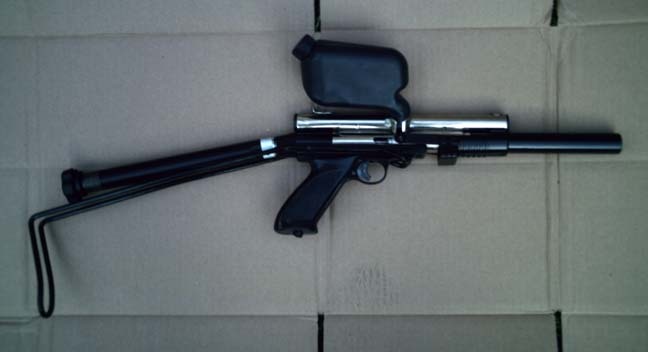

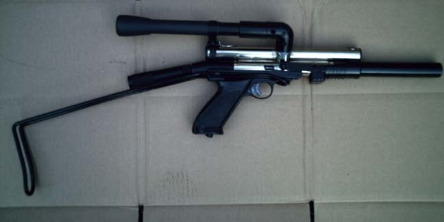

    I either have to sell it, or start using it!
    What is a good ball detent setup for a Nelspot 007? (it does have the removeable barrel)
    Click image for larger version  Name:	nelspot_8.jpg Views:	23 Size:	19.5 KB ID:	522967 Click image for larger version  Name:	nelspot_2.jpg Views:	20 Size:	19.8 KB ID:	522968

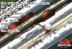

          I would try something like this for double feeds
            I. Am. Canadian. 🇨🇦
            • 3512
            The body tube is too thick, I think. I've had trouble adapting that style of detent to anything other than stock Sheridan barrel tube.
              XEMON commented
              I've made some 3d printed one that looks like the spider/ego ones, but held in place like the Palmer's. They work great 👍
