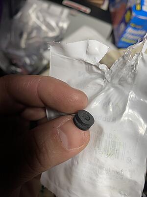

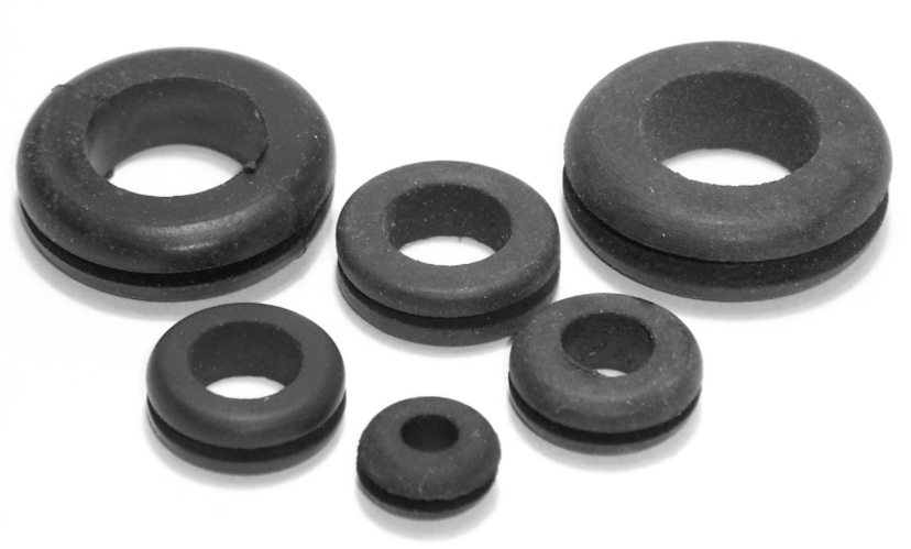

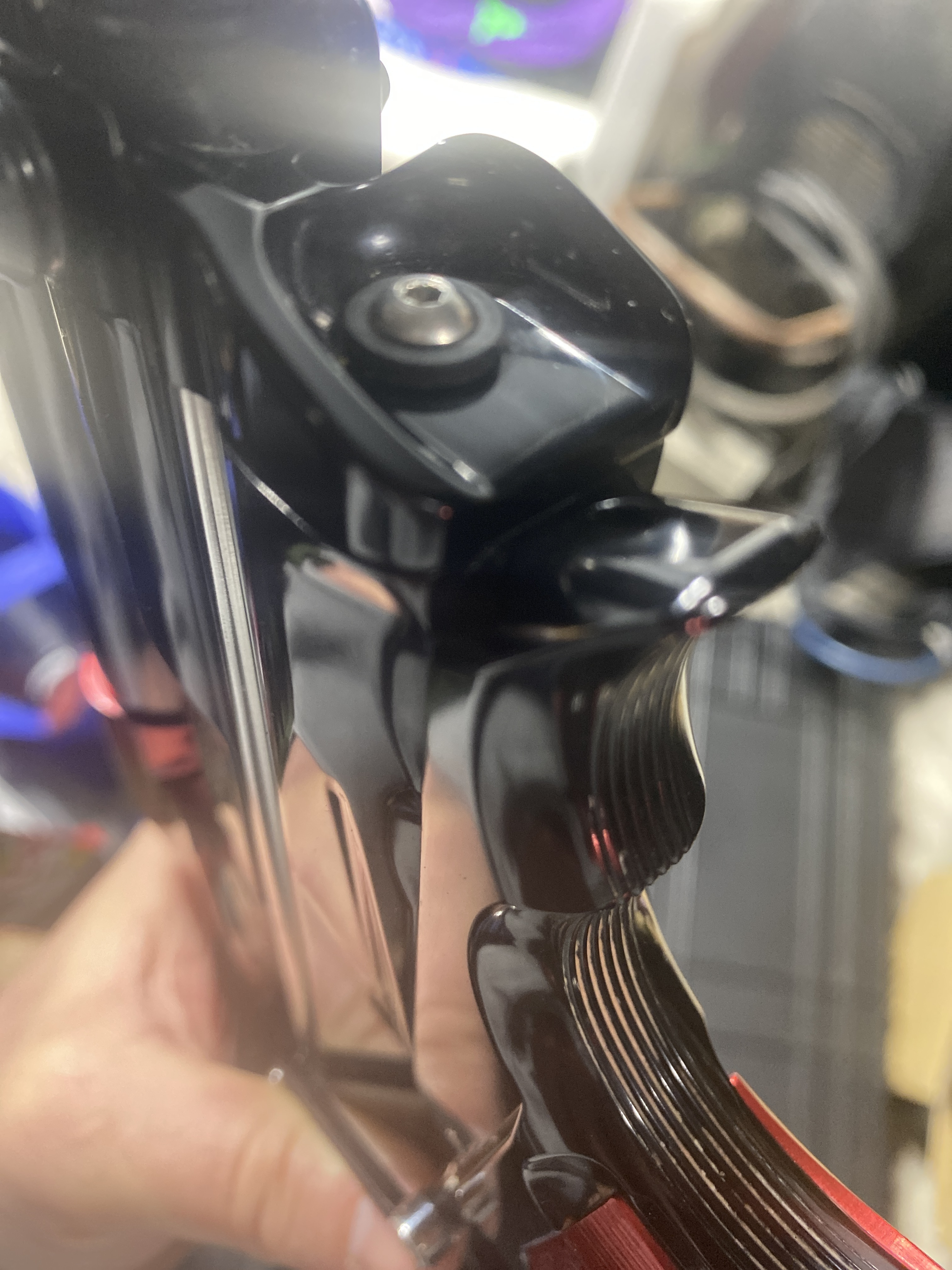

          I have the TJD and a CCM one. Both function the same different hammer weights the TJD uses a brass hammer. I don’t see a difference in performance. I do recommend getting a rubber grommet for the back block screw. I trim one side so it slides in the back block hole and leave the other side so when you tighten it up the mount screw rides and sits on the rubber grommet instead of Ano aluminum or the supplied Oring that will eventually fall off. The oring can pop off and mess the finish around the cocking rod hole in the back block.
          get one of these that fit in the back block hole after you trim one sides lip off. I just use a razor knife. Put the small end in the back block let the larger side sit over the back edge it protects it nicely and will permanently protect the back block. It feels nicer as well without the ICS floating cocking Rod moving around. Keeps it tight in the back block.

            I attempted this with just a cooking rod, and found it was just too stiff and caused too much friction.
            Iirc, the ccm ics has its own delrin "grommet" so to speak, but I could be wrong
            A standard Cocking rod needs to slide threw the back block cleanly otherwise it will cause inconsistent strikes to the valve. With an ICS the cocking rod free floats inside the hammer. So it can be fixed to the back block. In fact the extra friction makes the cocking rod friction tight and stays centered in the ICS so it’s smoother less of the ICS feel is transferred to the marker because the rubber acts as a damper somewhat. So not only is this functional but it helps make it super smooth. Because it only really makes contact with the hammer at the very end of the pump stroke just enough to cock it. My SC J6 is one of my smoothest CCM. It’s very well broken in, super consistent on both HPA and 12g.

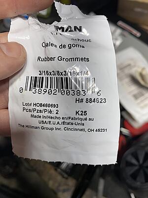

              This is what I used for reference. Homedepot hardware section. I just trim the one side back with a razor knife and stuff the small side in the back block hole and bolt it down.
