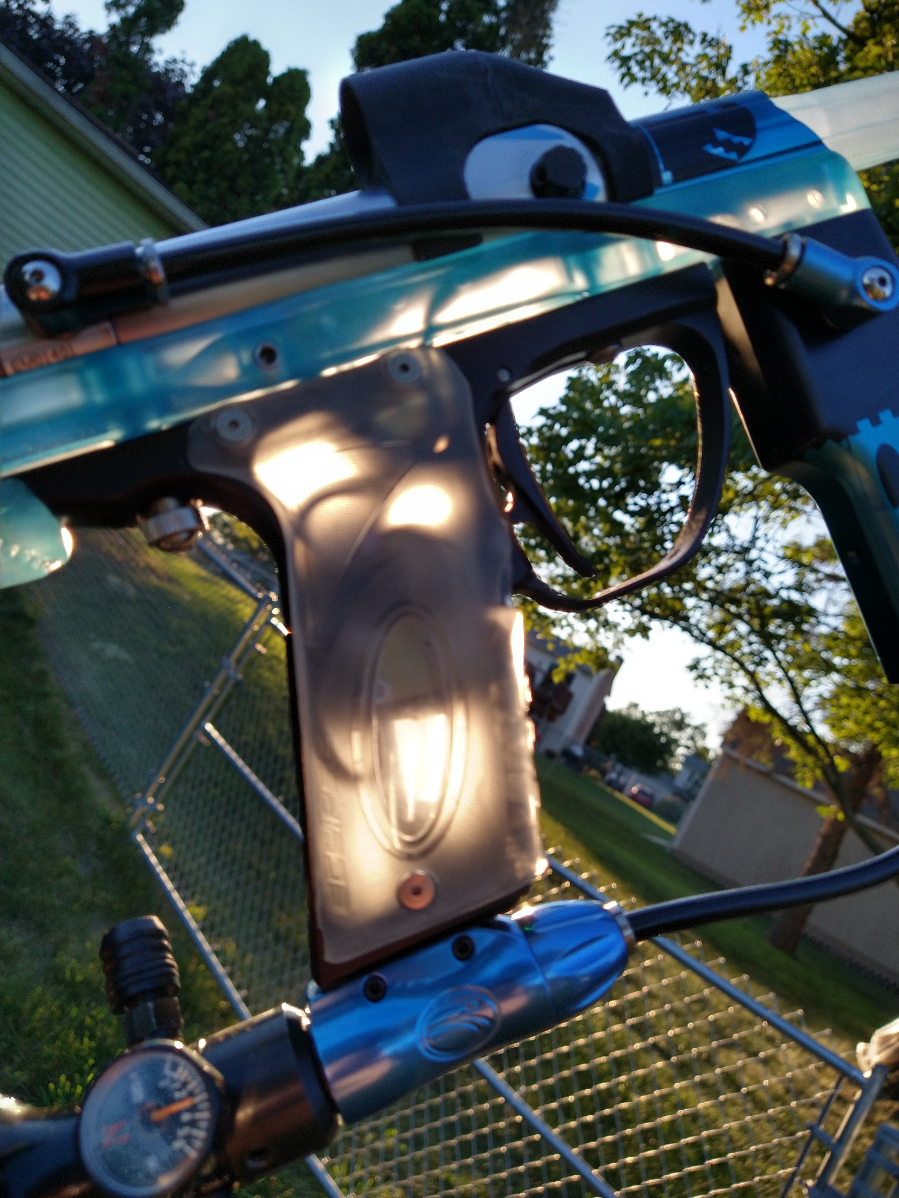

            I used a 05/06 Ego frame. Keep in mind not all Automag rails are created equal. I believe the older mag rails are not flat but have wings. Luke has some cool mag mods: https://lukescustoms.com/index.html
