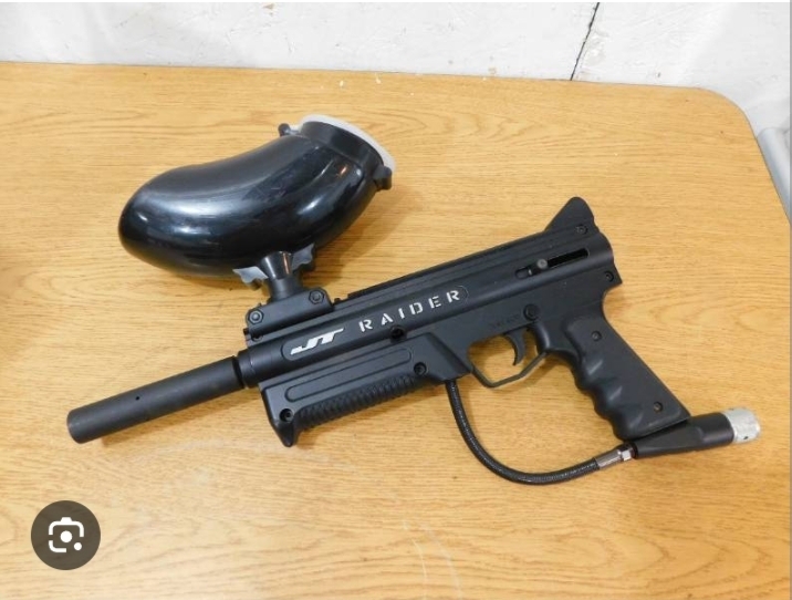

      Too many Raider paintball in the industry...
      Brass eagle Raider
      Click image for larger version  Name:	Screenshot_20240430-093431_Chrome.jpg Views:	0 Size:	368.3 KB ID:	538363
      JT Raider
      Click image for larger version  Name:	Screenshot_20240430-093454_Chrome.jpg Views:	0 Size:	232.8 KB ID:	538365

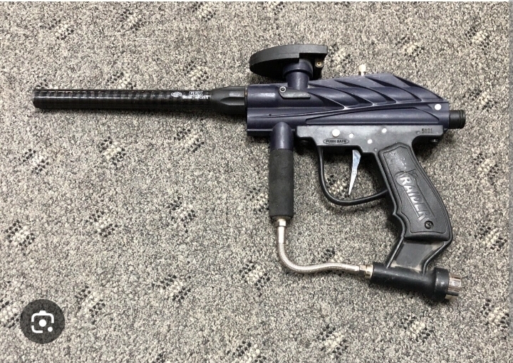

      USI Raider

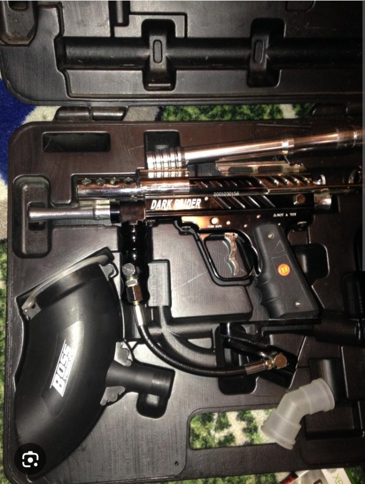

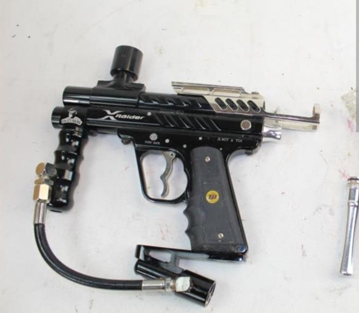

      WGP Boss X Raider and Dark Raidee
      Click image for larger version  Name:	Screenshot_20240430-093637_Chrome.jpg Views:	0 Size:	182.8 KB ID:	538366 Click image for larger version  Name:	Screenshot_20240430-093709_Chrome.jpg Views:	0 Size:	430.5 KB ID:	538367

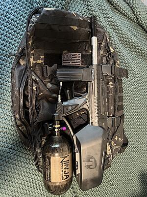

            I got it in today and I gotta say I’m a fan. I running in on a 68/45 Ninja tank with SLP reg (300psi) and it’s shooting very nice!

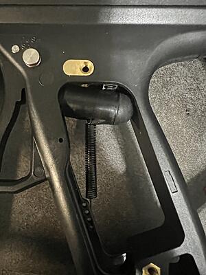

            I bought a pack of Dorman brand universal vacuum caps from AutoZone and cut out a small portion in the middle and slipped it over the trigger like a shoe. Fits great and reduced 90% on the trigger pull. I used the largest cap in the pack and moved the top hook of the spring over to the hole on the left (there are two holes for the spring to attach at the top)
            I dropped in a Shocktech Superfly Ion bolt and had some problems getting her to seal. You need to swap the 2 O rings on the front of the stock bolt to the aftermarket bolt. I just played it safe and swapped all the O rings to the Superfly. The O ring sizes are Urethane 90 Dur -010 and Buna 70 2mm CS x 16mm. Works perfect now. With that being said, the stock bolt is very nice. It actually weighs the same as the Superfly, it’s one piece aluminum, and plenty of porting for airflow. The Shocktech bolt was not an upgrade. It changed the sound signature to a “softer” sound but that was about it.
