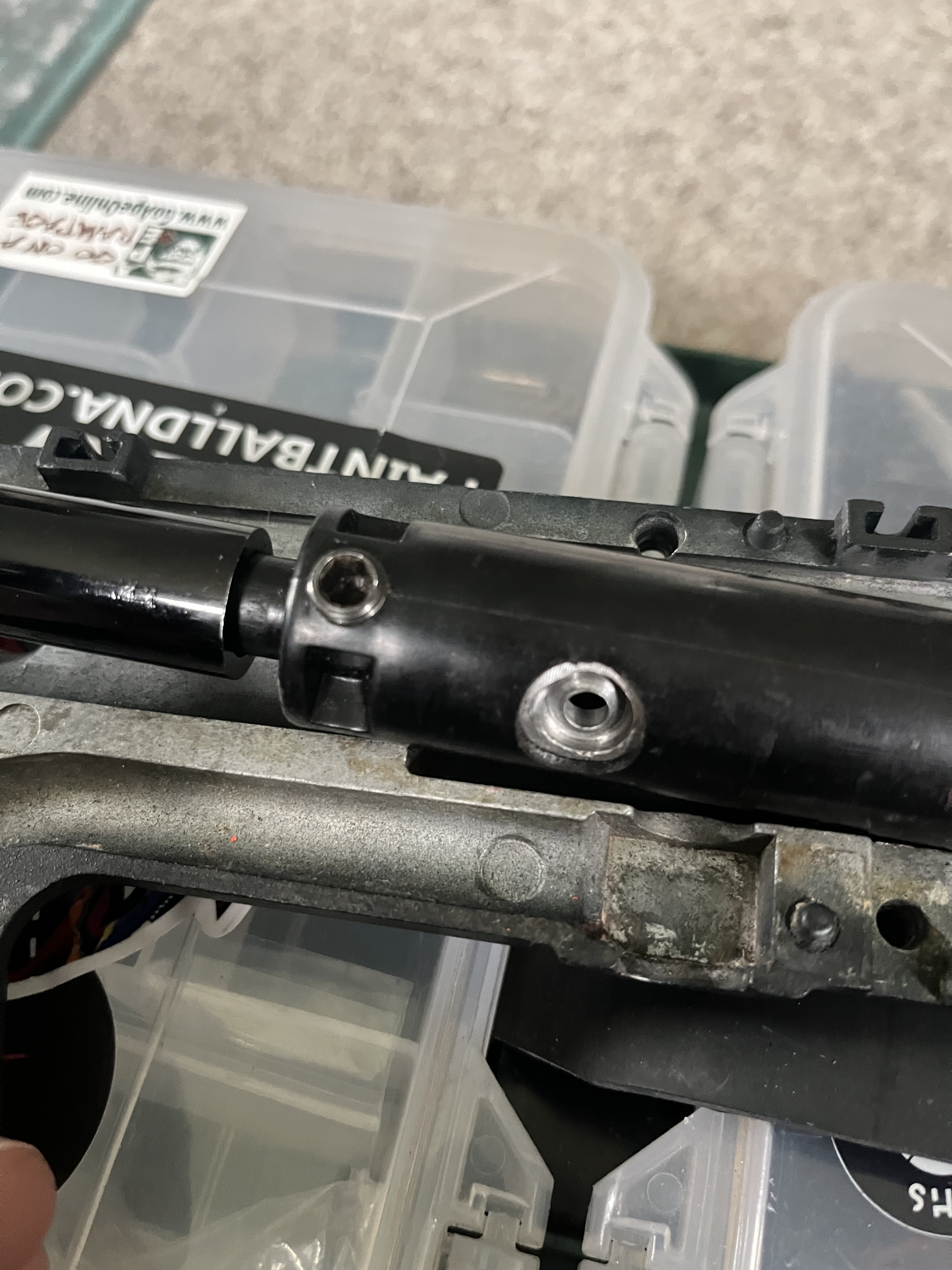

    Hello,
    I am cleaning / tuning a platinum 98 for a friend. First time I’ve taken apart a platinum, basically the same a little easier.
    looks like there are a lot of after market parts on / in this market.

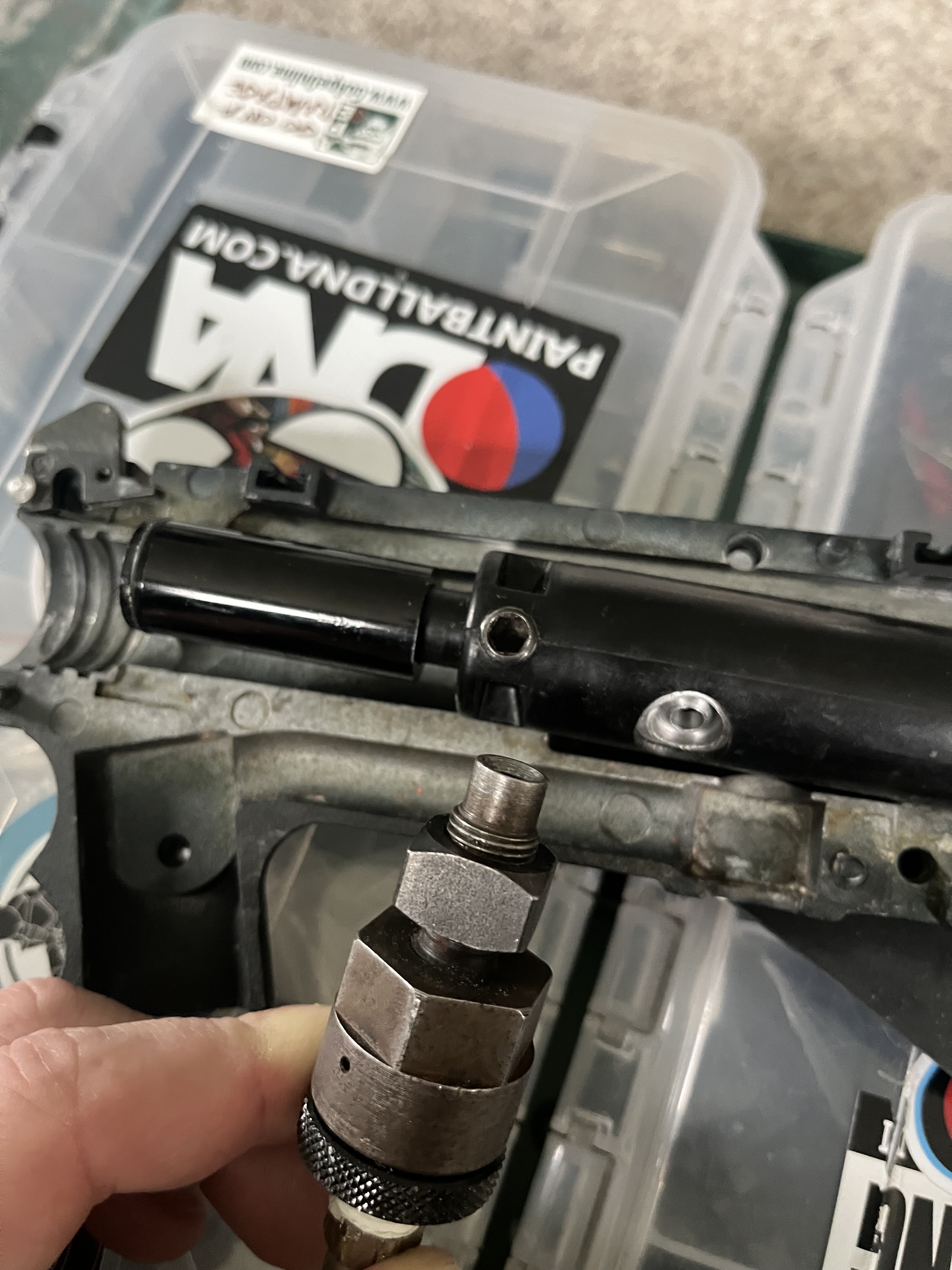

    i had a question about the steel hose connection to the power tube. On a typical 98, the hose screws into the power tube. I believe that to be the case for the platinum as well. The 98 I’m working on has
    a slightly different hook up to the power tube (see attached images).
    my question is are there any missing pieces and or orings?
    and are custom 98s and platinum 98s interchangeable?

    That looks like a flared fitting. It should seal

      Ok great, thanks
      i have half a tank of air and no fill station around- so I’d rather ask then roll the dice
        • 6182
        I'm pretty sure there is an o ring in there somewhere. Flare fittings are fine for lower pressure situations but 800ish psi they don't typically rely on metal on metal to make the seal
        Yes you can swap out for a standard braided hose and 1/8npt fitting and id actually recommend it. There's more options that way. You can actually just drill and tap that power tube to get the threads in it. I've done it before but you will need to just replace the hose completely, check the other end as well, I'm not sure if the ASA was a matching situation. If it is you'll most likely have to replace it as well.

          No, there is no o-ring between the flared fitting and the valve body on a platinum 98. What you have is normal. Although, it doesn't usually go into a VASA. That's unique.

            That vertical asa is a rare, desirable, and nearly impossible to find part.
