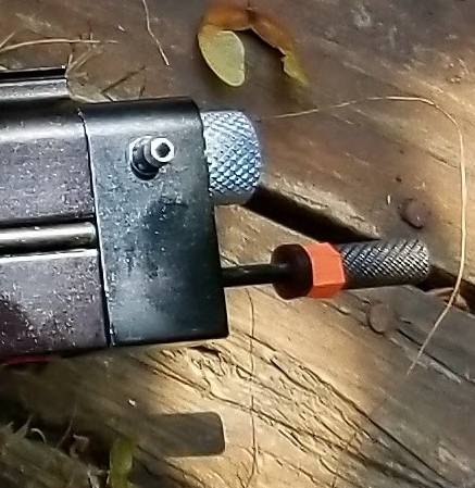

                Janky piece of orange rubber mat you cut to fit...plus a bumper?! ... worked for me
                Velcor will save us...
                  scottieb commented
                  100% jank. I like it.
