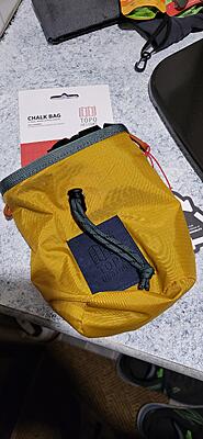

    The chalk bag was pioneered by our original single shotters and it has worked well for me.
      • 3402
      Chalk bag is what I figured would work best. I haven't played single shot since I bought mine, but topo designs are nice bags.

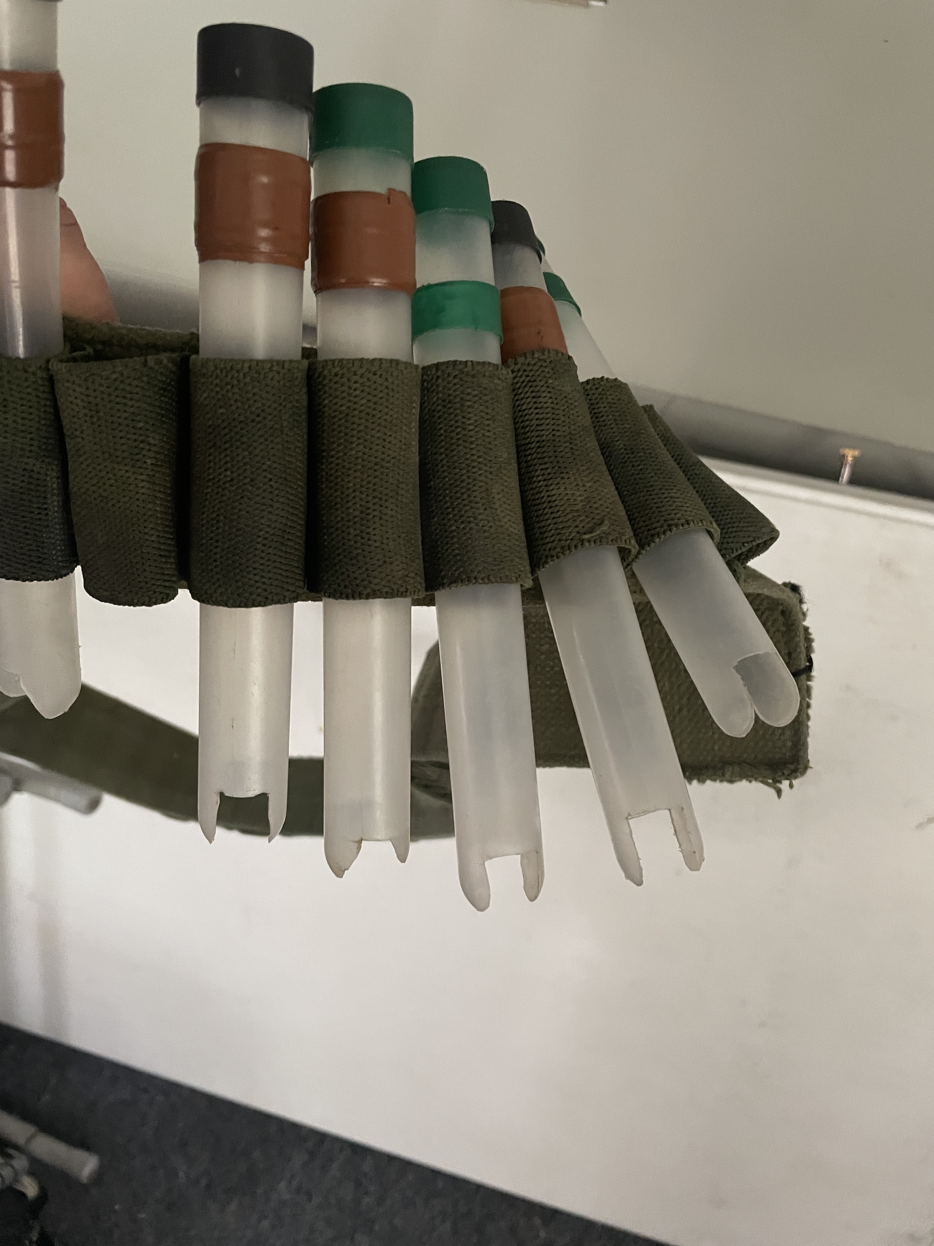

                My favorite is slitted tubes. Cut a hole in the tube at the bottom so there are two fingers that hold the paint. When I go first strikes, I use Dukie Pez dispensers.
                  XEMON commented
                  do you have pictures of it?
                  I want to make something like that and mount it on the side of the SR1
                  JeepDVLZ45 commented
                  XEMON I’ve done this too.
                  You’re basically just cutting a notch out of the very bottom of a 10 round tube so you can pinch the ball between your thumb and index finger to pull it from the bottom. You want enough “curve” left on the bottom of the 10 round to capture the ball and hold it in place.

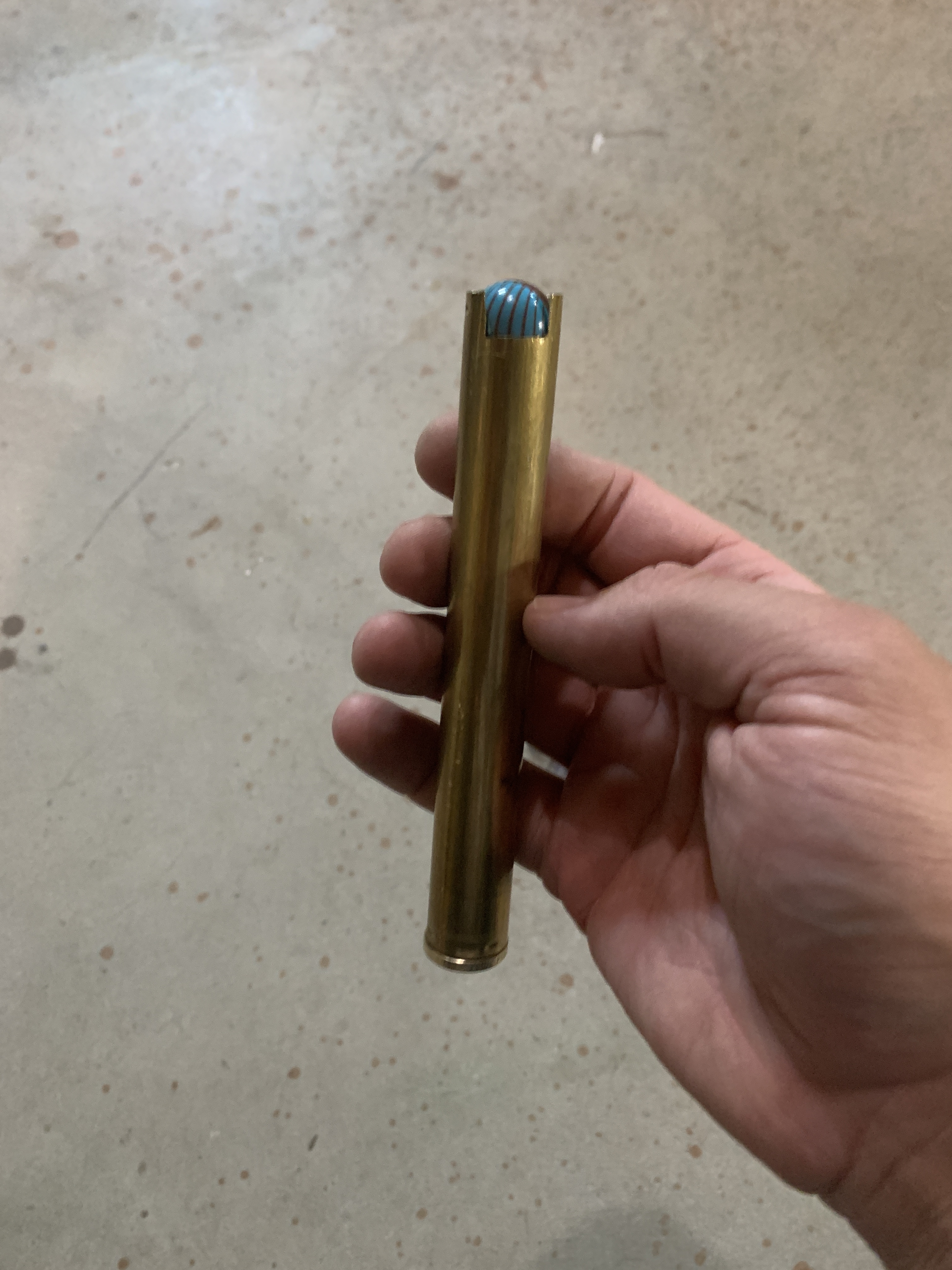

                  Who was it who made the "Pez" dispensers for paintball, Dukie? If I was to go down to single shot (not likely) I would want to do something like that.
                    It was dukie
                    I worked with BLachance75 in a design to reproduce something similar out of brass. shooter311 was kind enough to print me some followers to help out.
                    I made a few that worked, but found that a pouch was a lot easier and faster for me.
                    I’ll see if I can dig up some of the ones I made

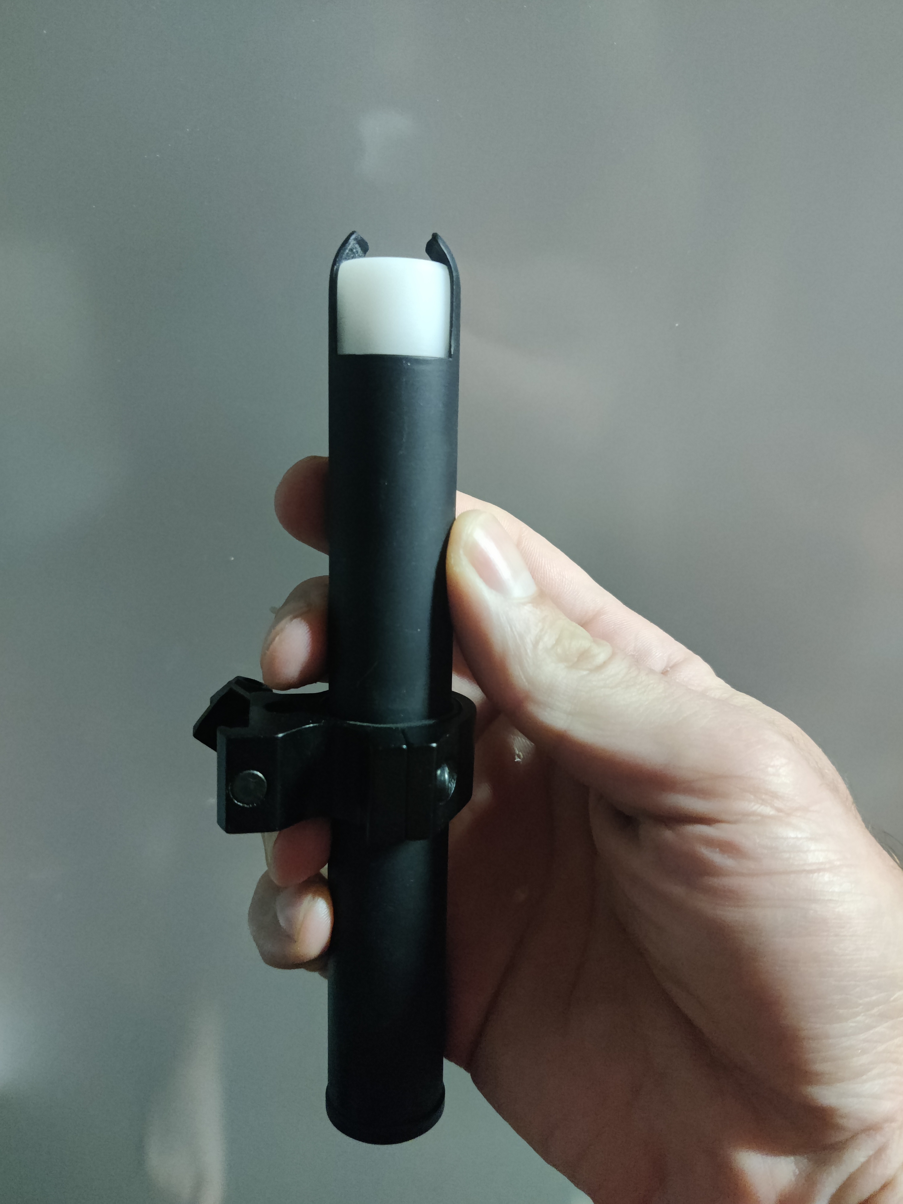

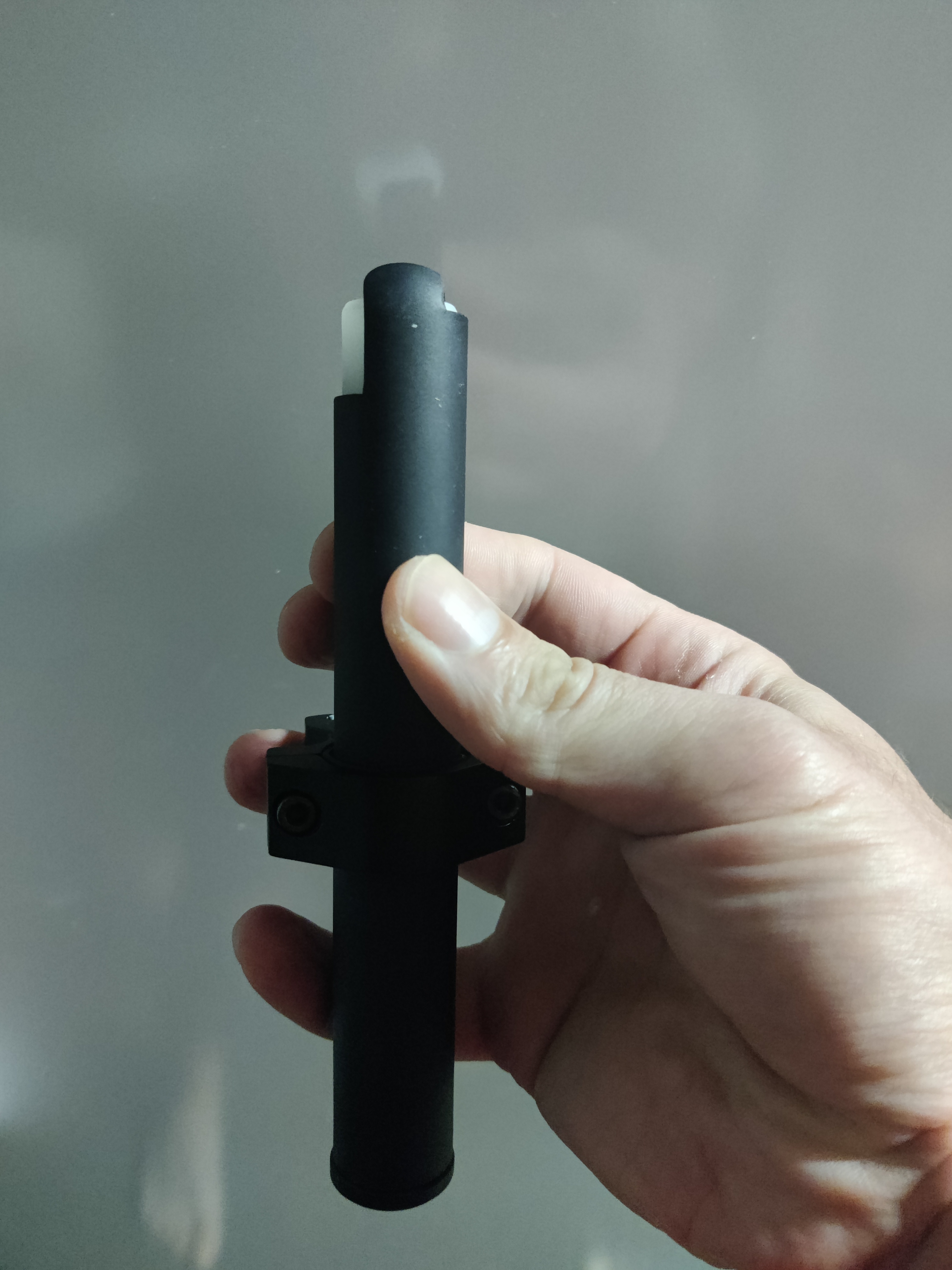

                  This was a prototype for roundball. Not the prittiest, but it worked.

                    That is pretty cool, mounted on the marker where your cocking hand can access a ball quickly.
                    That was actually the plan. I’ll send you the info for how I made it (supply list). They’re super simple. We did run into a tolerance issue though. We were using 0.686 ID brass, but one round was perfect and the other was a little too tight, you’ll want to find something closer to 0.69 ID
                    I had it set up a little different for FSR so you could “roll” them out with your thumb.
                    I found that I liked the dump pouch much better, I like having 3 or 4 extra rounds in my hand for fast follow-up shots and abandoned the pez dispenser idea
                    I tried the Pez style. But ended up liking the pouch style better as well. Having the ability to grab a few at a time for a quick follow up shot made for an efficient setup. That and off setting my single shot feed hole a lil for my non dominant hand made the most improvement in handling.
