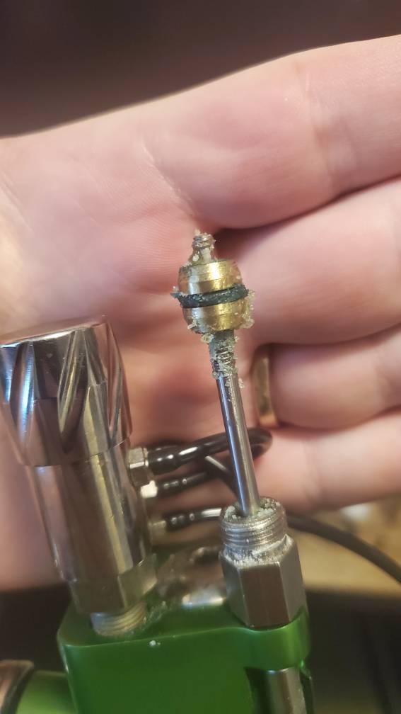

                Ram was trashed. It still cycled like this! It has convinced me to do LPR too. It cant be much better

                  See pic of ram below...

                  • latches109
                    latches109 commented
                    010 for the piston and There is a 006 oring in the ram base.
