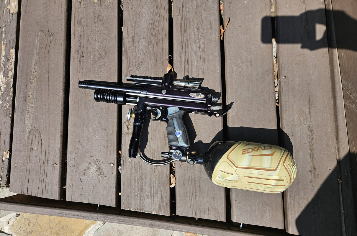

          It was pretty warm and very sunny day today so I was able to run some tests and...
          It's not the regulator... but it is temperature-related.

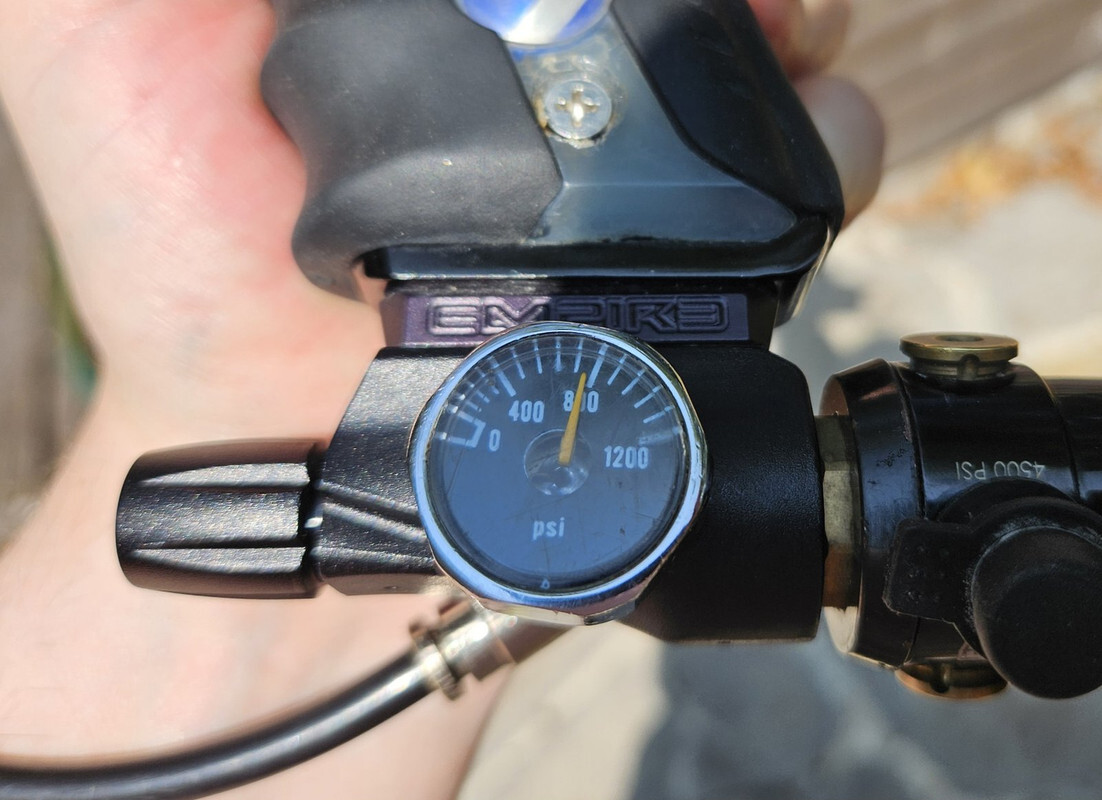

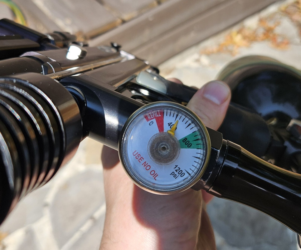

          I kept the Azodin reg on the gun but put a LAPCO dual tank adapter between it and the gun and screwed a gauge into it. The gun was set to operate at around 430psi, which is kind of high but it is a minicocker, and I've got a thing against that pumps that make a farty sound.
          Anyway, I chronoed the gun at 290fps and then left the gun (with no paint) in hot sunlight for an hour or so. Coming back to the gun it was so hot that the grip was uncomfortable to hold. However, the Azodin reg was holding steady at 430 and the gauge on the ASA showed that the tank was still putting out around 800psi.
          Chronoing the gun with paint (the same paint I used the last time I had the problem) showed that the velocity had dropped by more than half- about 130fps when the shots would even register.
          Degassing and re-gassing the gun did nothing to change the problem.
          I degassed the gun, brought it inside, and set it on top of an air conditioning vent to cool. After an hour or so I re-gassed and re-loaded it and once again it was shooting at 290fps. Paint out, gas on, another 30 minutes in the hot sun, and again, velocity was down below 150.
          To see if it was the temperature and not just sitting gassed up that was causing the problem I let it cool down again and tested the velocity (again, 295 or so) and left it gassed up inside the garage where it's cool.
          After an hour, no change, so it's my assumption that getting hot is somehow causing it to shoot way under, though at this point the mechanism making that happen does not appear to be regulator-related.

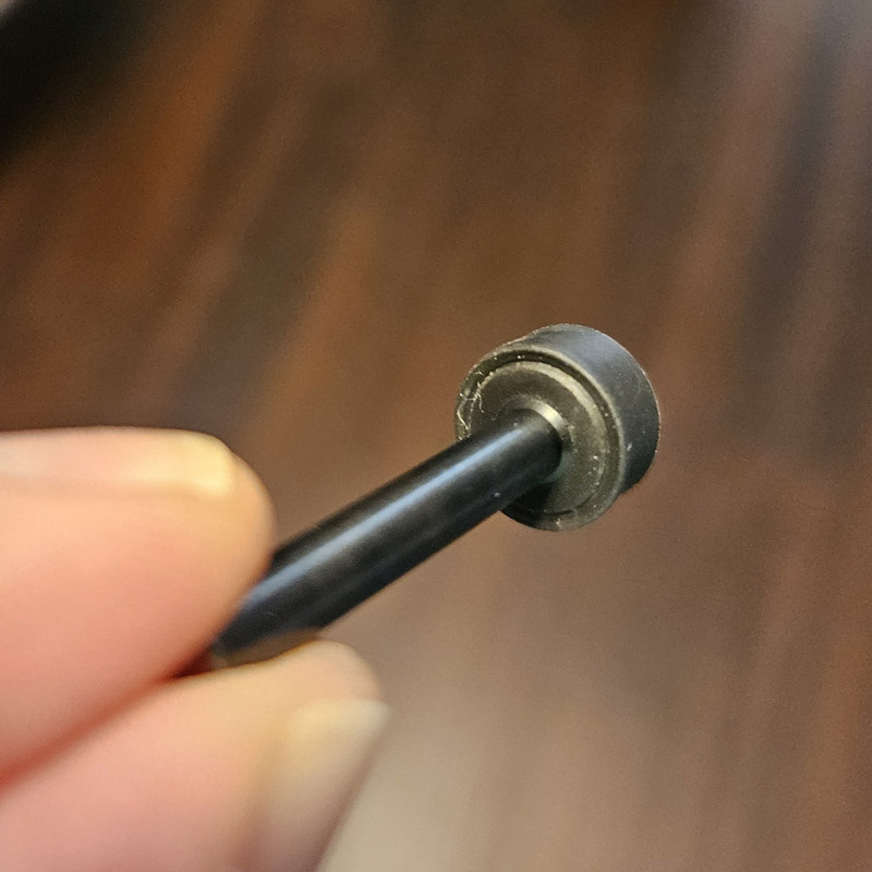

            The only remaining thing that would make sense to me is the cup seal. Could the heat be making the cup seal get too soft and sticky?

              I guess the question is, did it return, near-instantaneously, to 430psi after each shot when it was hot and shooting 130fps or less?
              If yes, it’s not the HPR, right?

                It did, yes. Pressure downstream of the HPR didn't budge before or after the heat.
                Gauge is good, too- I had to adjust the reg prior to testing since I had taken it apart to inspect the seat and it was accurately showing the inline reg's output.
                I'm ruling out the inline reg as the cause at this point, which is on the one hand is confusing because I struggle to think of how heat could be doing this, but on the other hand it didn't make a whole lot of sense for the gun to be demonstrating the same exact problem with two different regs which had been working properly on other guns.

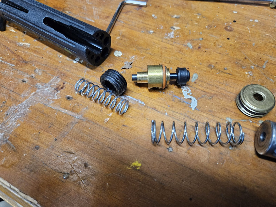

                      I'm not an expect at identifying cocker internals but aren't these stock WGP parts?
                        Cdn_Cuda commented
                        Yes look stock. So no internal o-rings.

                      I'm no expert at ID'ing cocker parts either, but is that cupseal made of delrin or other plastic? The theory that the cupseal is getting sticky in the heat seems to make sense to me too.
                        Cdn_Cuda commented
                        Heat that cup seal while it’s out of the body and see if it gets sticky. Also look for a fine crack maybe?
                      • Socalpumpballer
                        Socalpumpballer commented
                        I 2nd this theory. Those stock wgp injected molded plastic cup seals are hitting their expiration date. I’ve had all of mine go bad in the last 2 years on 4 different snipers
                      • Myrkul
                        Myrkul commented
                        I've for sure seen at least one WGP cupseal go bad in the last year or so.
                        I like the idea of hitting this with a hair dryer to see what happens.

                          That made sense to me too, but doesn't seem to be the case. I heated the cupseal with a hair dryer until the stem was too hot to handle, but it wasn't sticking to the face of the valve.
                          Left the whole thing out in the sun for a bit, again to heat up, and same situation- not sticky.
                          I'm wondering now if somehow I'm assembling the valve and its jam nut and locking screw incorrectly to where the stem of the cupseal is binding in the valve, but I would think that the valve being pushed out of alignment enough for this to happen would cause leaks. Other than the metal moving a bit I don't know how if this is indeed what is happening it would be temperature-dependent.
