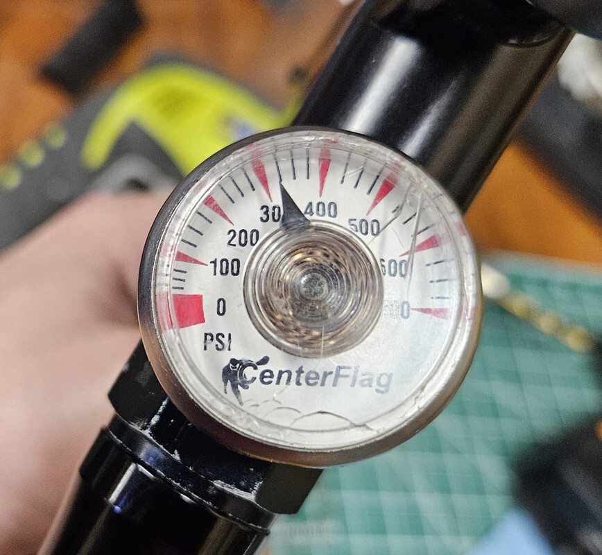

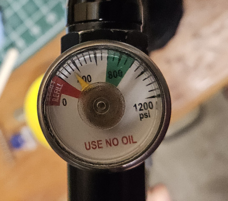

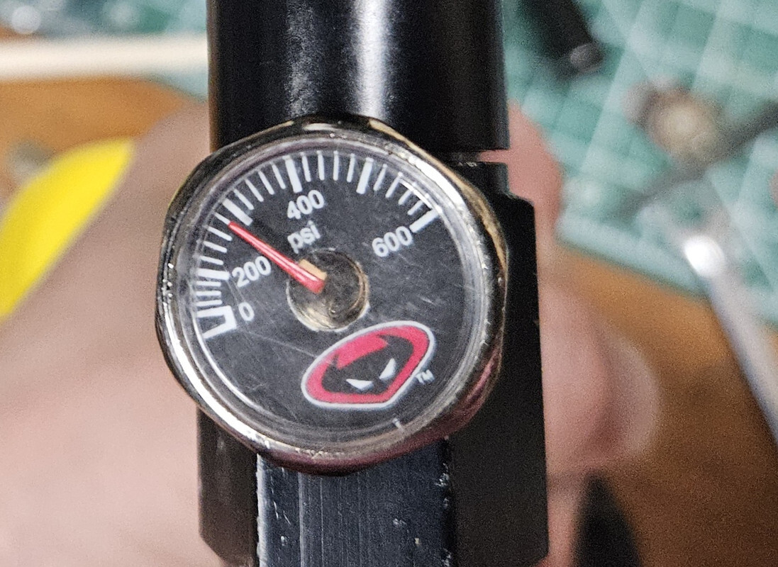

                I don't think it was regulator related. Both the Azodin reg and old Diablo Torpedo clone appear to be functioning properly. Even when the gun was warmed up in the sun the post-reg gauge on the adapter didn't move off its observed setting. Looking at them again I'm guessing pressure is more around 300psi. I'll probably bump it up a little when I chrono at the field next time I play.
                Post-valving, here's the current reg output with a handful of gauges I've got lying around. I don't know that I trust the Diablo micro gauge.
                Click image for larger version  Name:	20240917-141113.jpg Views:	0 Size:	196.7 KB ID:	592928
                Click image for larger version  Name:	20240917-140412.jpg Views:	0 Size:	187.6 KB ID:	592929
                Click image for larger version  Name:	20240917-140751.jpg Views:	0 Size:	268.3 KB ID:	592930
