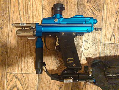

    So, I picked up on of the PB cockers from that auction over the summer that was for a friend having medical issues (sorry, I'm bad with details) but then it pretty much sat around at the tail end of other projects. I recently picked up an Eblade and was planning a build around it but then remembered the Superbolt. I really like the body, even if it is cheapo overall, so I figured why not πŸ˜‚
    Honestly, it all went together easily and I replaced the stock pneumatics in the process but I did have issues with the valve and a few small things I was hoping to get some guidance on...

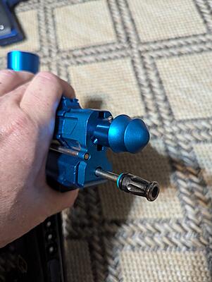

    4. The bolt seems to be a proprietary design, or at least one I am unfamiliar with. I am attaching a photo but it basically has a fixed pin in the bolt that inserts into the block and then twists to lock it with the help of a ball detent. Are my only aftermarket options to drill the block for a pin? Are there bolts drilled of a P-block or would I need to figure that out and drill the bolt as well?

    In regards to three and four
    Likely yes but you'll be spending more on something than it's worth
    The bolt is similar to dye ultralights but there is not much after market for those....and again when they pop up cost around what an entire super bolt costs.
    You are really better off leaving these be

      It looks like it is an evo length bolt? Was thinking the locking pins and maybe the detent could be moved over. I realize the value on all of it is poor, just planning to tinker as opportunities come up...
      Ecapnation commented
      It might be Evo length but not mounting style
    • nicmauro
      nicmauro commented
      I actually forgot I have an Evo bolt from a lot I bought. It is the same length and is the same overall design but milled to be a lot lighter. Since I have zero use for it I will probably try to drill it for the mounting pins and see what happens

    IF I recall correctly, they do not use a standard literally ANYTHING.
    Your best bet, if you want this body to function and flow would be to have the lower end bored for the larger valve.
    I also hope you are planning on running anything except the stock PB pneumatics... That LPR is garbage at best.
    Yes, the half twist bolt is a pseudo dye design and definitely not much in the way of aftermarket for those. If you want a different bolt, you can either modify one to take the pin, or have someone make you a bolt. Either way though, a different bolt is not going to gain much of anything in terms of performance.

    You can replace the bolt with a normal post-2K bolt as long as you also use a normal backblock. This will, however, look very odd because so much of the bolt will be exposed at the back of the gun.
    I never got around to doing it myself, but if you get fed up with the twistlock mechanism of the stock bolt you could always drill out the bolt AND the stock backblock and then retain the bolt with a normal pin.

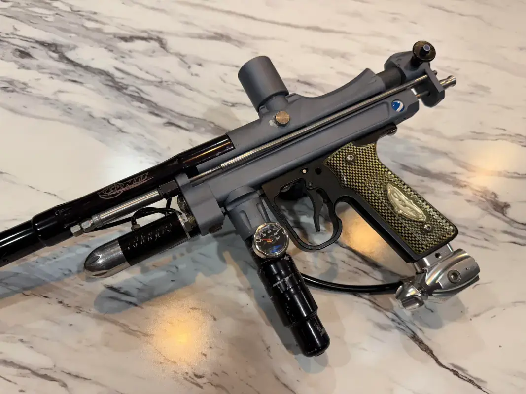

      Taking her out for a trial run tomorrow!

      • nicmauro
        nicmauro commented
        otar Yup. Honestly, it was probably the only time I ever had a gun air up and just work with minimal adjustment πŸ˜‚
        Unfortunately I haven't used it much because I got a black magic a month or so later and I prefer the midblock.
        I think the body is nice looking. I'm sure everyone is correct and it could have issues over time but it built fine, operated fine and looked good!
