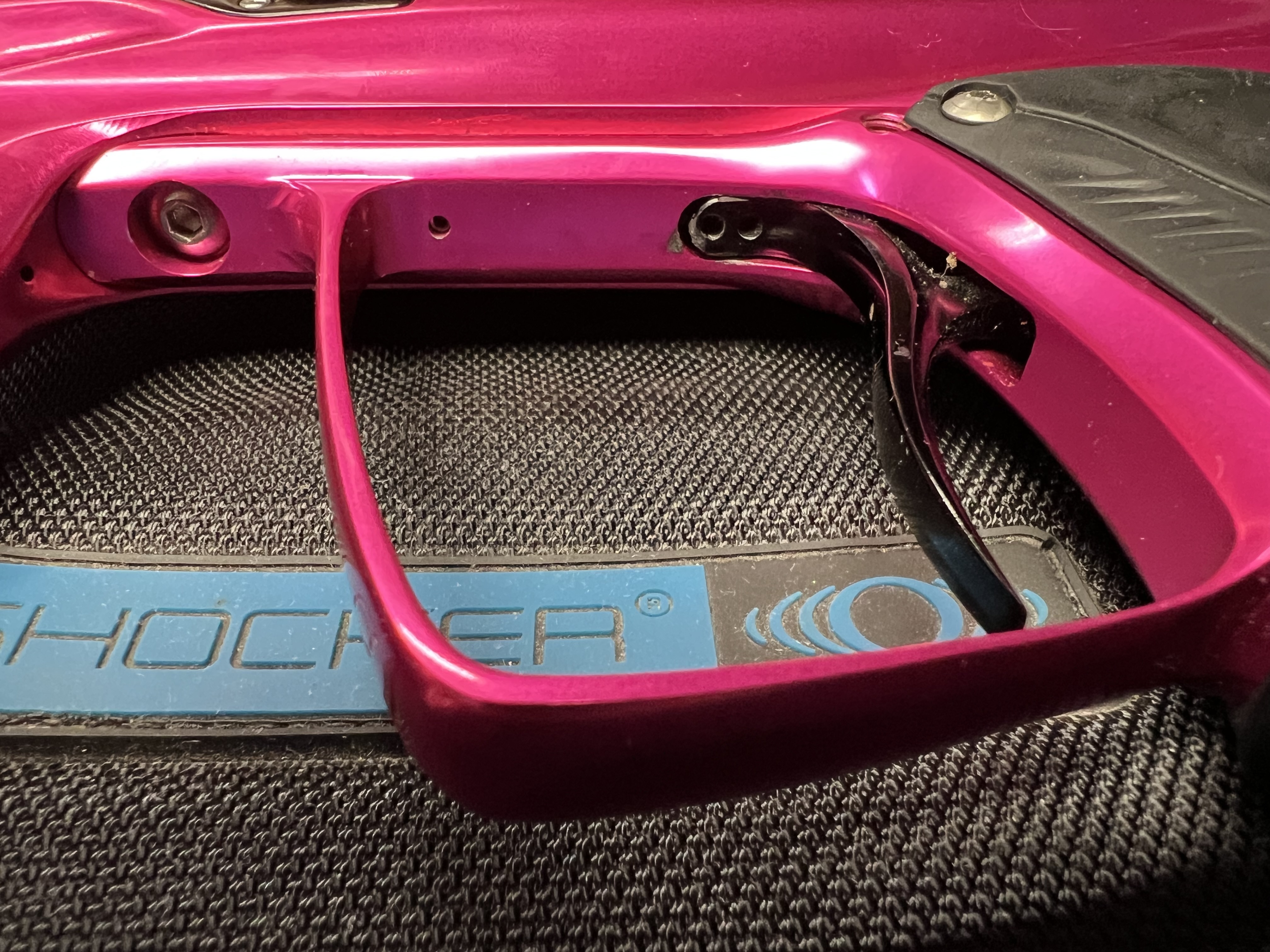

      For those playing along at home, I adjusted the bolt speed and seemed to have fixed my issue. It’s the Allan key on the front of the trigger frame. Counter-clockwise to increase the speed. Backed it out and no issues on semi-auto.
