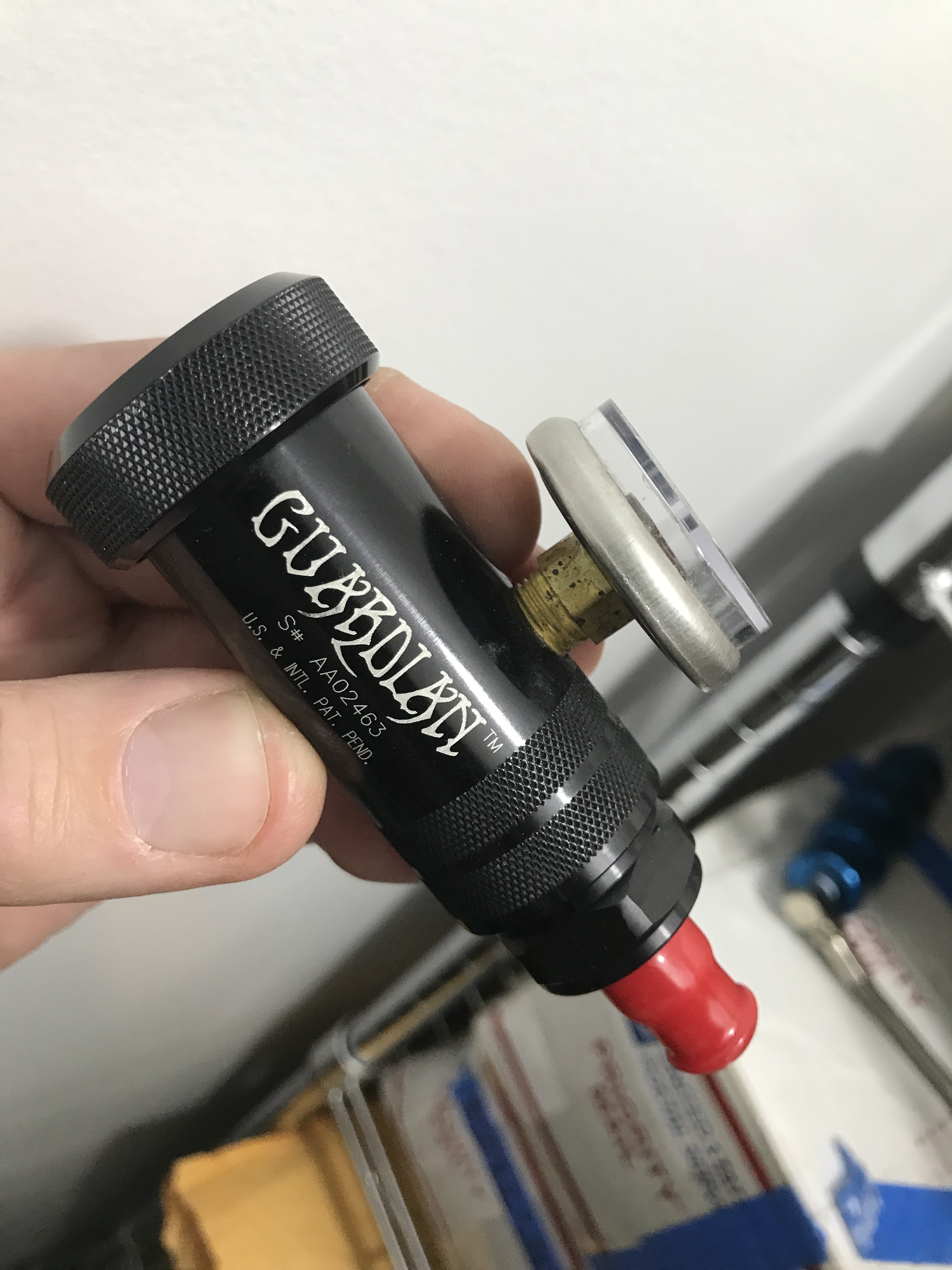

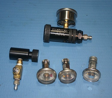

          I built one out of a remote ASA with a male QD on the output and a push button bleed. I put a female QD on three gauges and switch back and forth as needed. 200psi, 800psi, and 1500psi
          You can screw a bottle into the ASA, an HPR into the ASA, or use an adapter that will take a macroline, and another that will take a Cocker LP hose and screw one of those into the remote ASA.
          I also found an AirAmerica Guardian on eBay for $20....

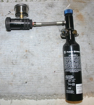

                • 4288
                This is what I use.

                  The only thing with the Guardian is it doesn't have a pin depressor, so you still need to have a way to depress the pin. I use a remote ASA with a short piece of hose, and connect to the Guardian with a QD...

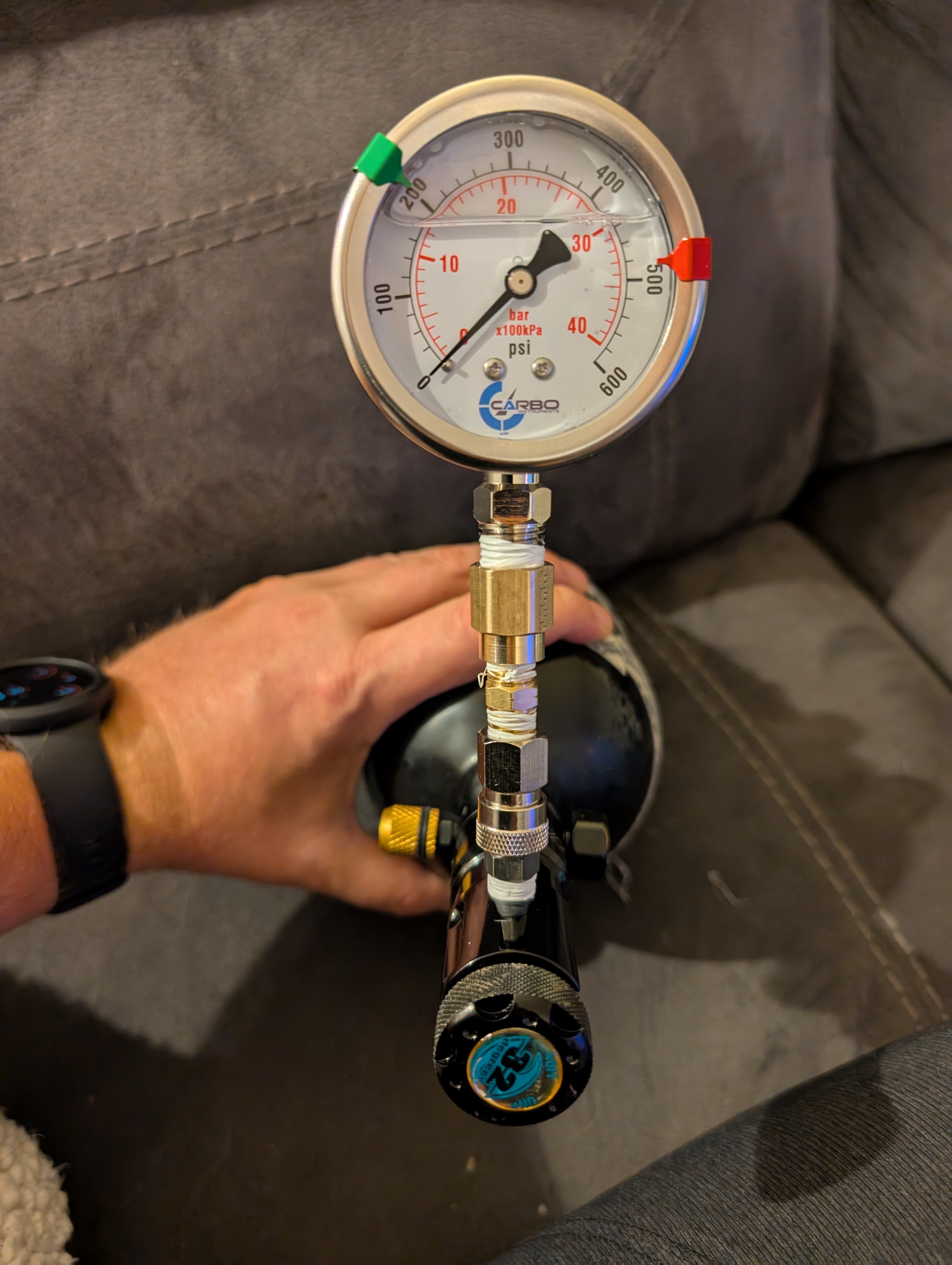

                    Thanks to all of the help here, I cobbled together my own solution.
                    32 Degrees ASA: $35 on eBay
                    Fittings: $7.00
                    Gauges (1000 and 600 PSI) $10 each on Amazon
                    I'll probably loctite the fittings as plumbers tape isn't air tight, but it works and my reg is outputting around 490.

                        So, I fixed the leaks. The only problem is that now you can't depressurize the system, LOL.
                        Turns out this 32 Degrees on/off ASA is full of shit. No wonder they went out of business. (Snark over). Turns out that the ASA is air tight. The screw will push the pin down, but when unscrewing the knob it only pulls off the pin, there's no way for the air to escape. So you have to push the gauge fitting in and hold on to the bottle as the pressure blows out your ear drums and pushes the fitting off.
                        Guess I'll find a different ASA or do some kind of pressure release valve on the other side.
                        My Feedback: https://www.mcarterbrown.com/forum/b...xnine-feedback
                        • Toestr
                          Toestr commented
                          Yeah, many on/offs (especially early ones) don't have a vent. You have to dry fire or otherwise vent the downstream pressure manually. There are some applications where I prefer a non venting on/off. For this application you'll either need a venting on/off or attach a slide check to the other output port on this on/off to be able to vent.
