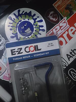

    Hey so one of my tracers bolts is so badly worn down that the tigger sear slips right off (both sides) so I'm going to drill another hole ... any one know what the thread I.d on the pump arm screw is??
    Thanks.

    They're 10-32.
    Doc.

      Ya welI I fucked them up already put the wrong tap in....
      I'm no machinist...just some dick head with a drill...
      But... I got some of these

        What do they look like? The same?
        XEMON commented
        Same ones 👍
