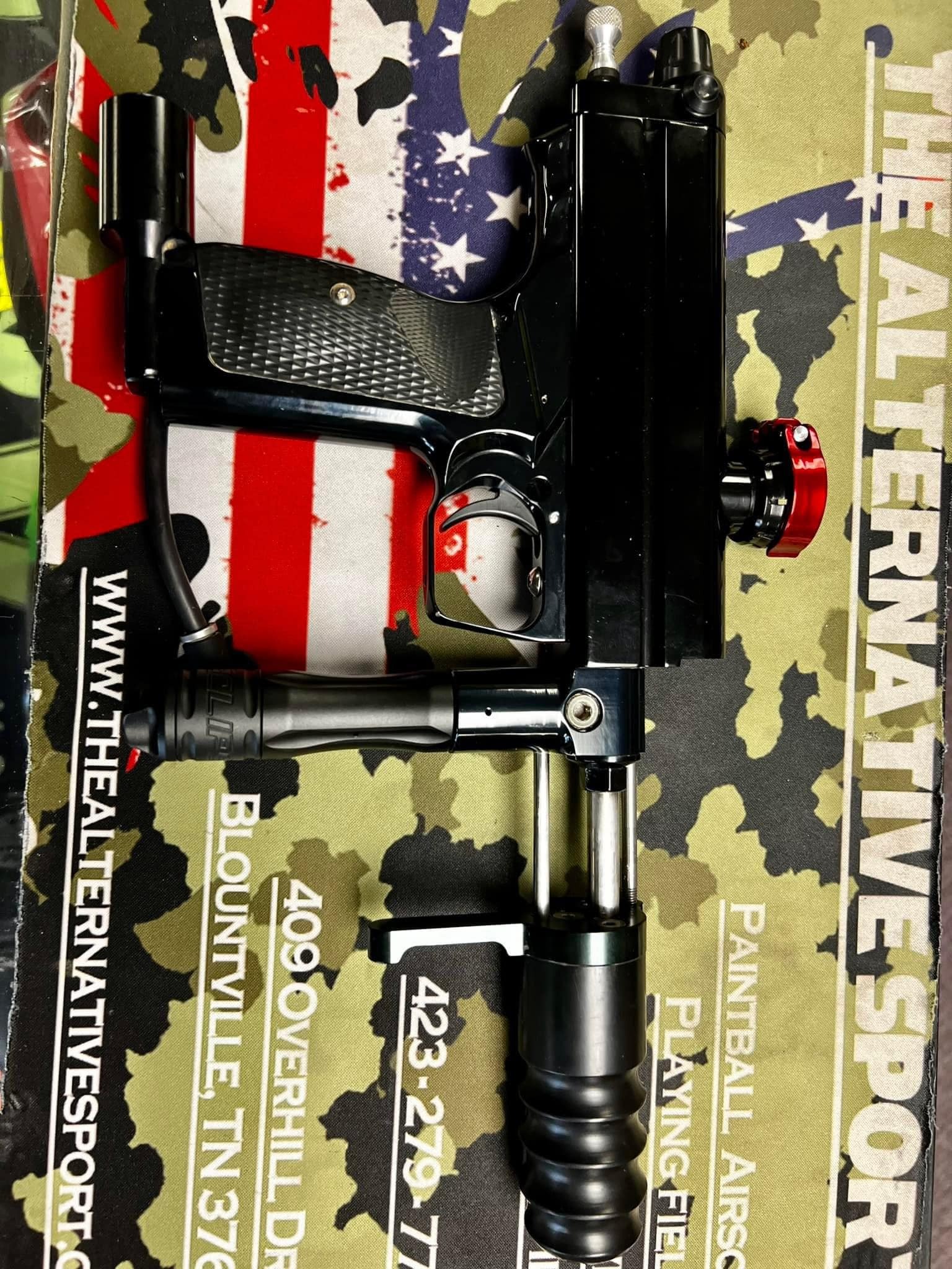

    So from the collective minds of CCM aficionados here in MCB I have a couple of S5 configurations questions:
    • Were there any CCM S5 that were not Slab Sided (pump arm milling on the passenger side of the body)?
    • Were there any CCM S5 that were Mini?
    There is a guy asking for $$$ value on an "S5" that is a Mini and has pump arm milling on the passenger side (not Slab sided). I have owned a few S5 over the years and all were full slab bodied and I have never seen one that wasn't. Even did some images searches and I can not find an example of either on an S5. He states it is an early S5 but the Trigger Fame is a later 86' CCM frame and the body is round topped and early S5 bodies had sight rails behind the CF.

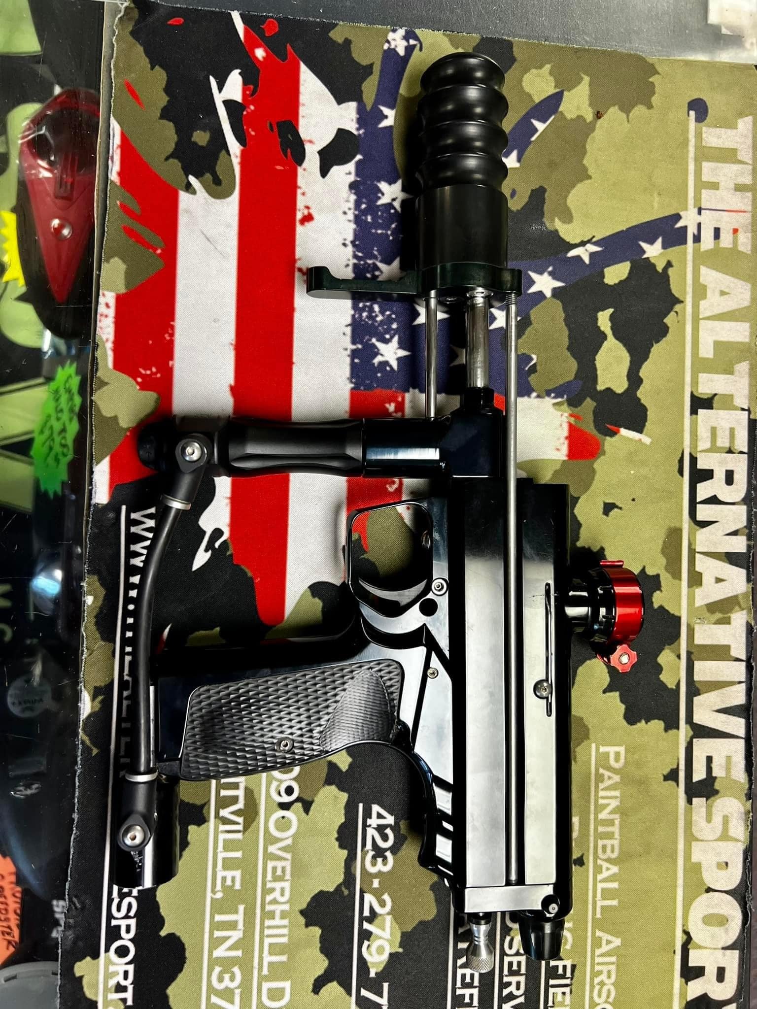

          The body does not have a serial number on it under the trigger frame. It does have a wire detent but I have other non-CCM bodies with wire detents so no guarantee there.
          I did ask about valve size not gotten an answer on that yet.
          Here are the images from FB https://www.facebook.com/groups/PaintballPre05/posts/3879462868934969/?comment_id=3879752265572696&reply_comment_id=3879 847818896474&notif_id=1732028877476559&notif_t=gro up_comment_mention
          Click image for larger version  Name:	S5_Right.jpg Views:	0 Size:	577.9 KB ID:	621555
          Click image for larger version  Name:	S5_left.jpg Views:	0 Size:	523.3 KB ID:	621554
            • 6284
            That’s an SS-25 100% it’s 11/16th valve.
            Likely an early run. (Wire detent, machined in feedneck mount) it’s had some parts swapped out but that’s an early SS-25 body for sure.
            Looks like a NoPro feedneck with an aftermarket clamp.
            Asa is different and likely a PE SL3 reg. Missing the AT as well. Not sure about the cocking rod but it’s got the nice aluminum backed bolt that came with them. Those are my favorite grip panels for the 86* frame to. The hit man plate might be aftermarket as well. I forget who made those but I don’t think it was CCM,

                Well the valve is a 9/16 valve in that body. I assume the SS25 is milled from the same blank as the S5 just bored out to 11/16 and mini-ed? If this is a CCM body it looks like a one off/employee/prototype.

                  I stand corrected it’s cut from a S5 blank.
              • Socalpumpballer
                • Nov 2020
                • 235
                That’s a mini S5. people are just making stuff up now. Nothing about it says ss25. Ccm gun fuddlore is getting worst than proflex parts at this point 😑 keep in mind ccm made the mini works autocockers so it’s not like a round body mini wouldnt be something they had lying around

                    S5 mini. I believe Hellion360 has one in his collection.
                      I think he dose I always thought it was a SS25 my old “ss25” had a wire detent as well. I bought it used cleand the lowers but never pulled the valve I wonder if mine was a mini S5 as well. Looked just like the one the OP posted.

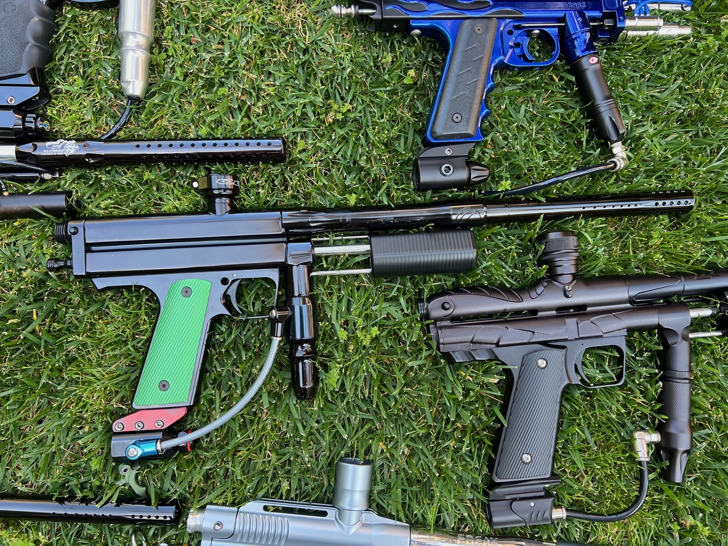

                    "That is a modified S5 body. The mod was remove the rail on top of the body. Nothing special." I asked Bill about mine last year. I will ask about the mini mod. 9/16 valve, ball on ball accuracy out of this one.
                    Click image for larger version  Name:	IMG_9582.jpg Views:	0 Size:	1.70 MB ID:	621854
                      That’s how they all shoot my friend. Haven’t owned a CCM I didn’t like yet.
