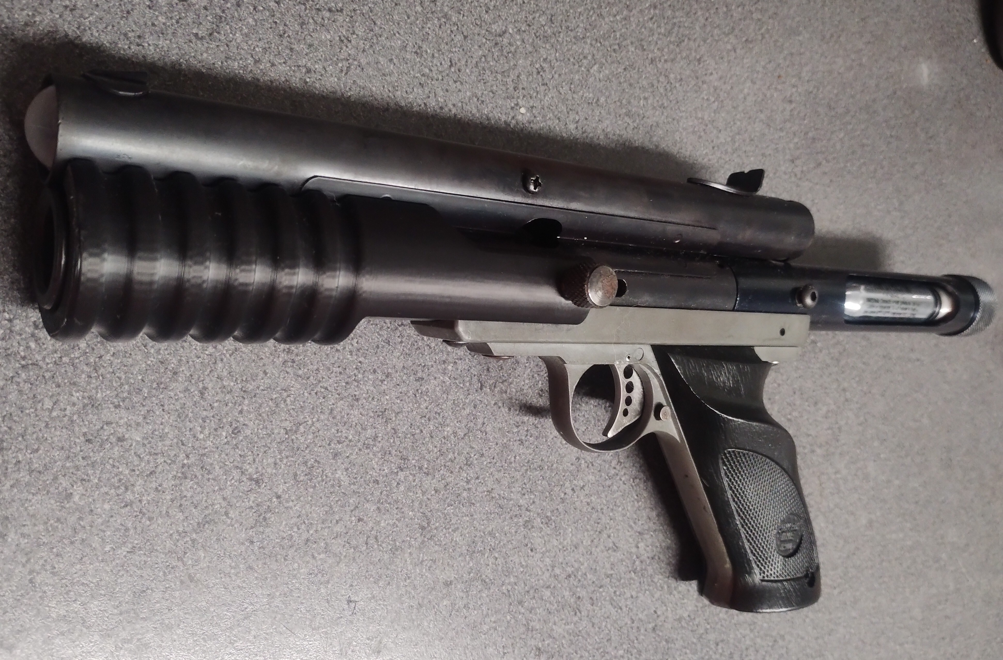

      I plan on making mine out of petg. I just designed a smooth handle if you want the stl file.

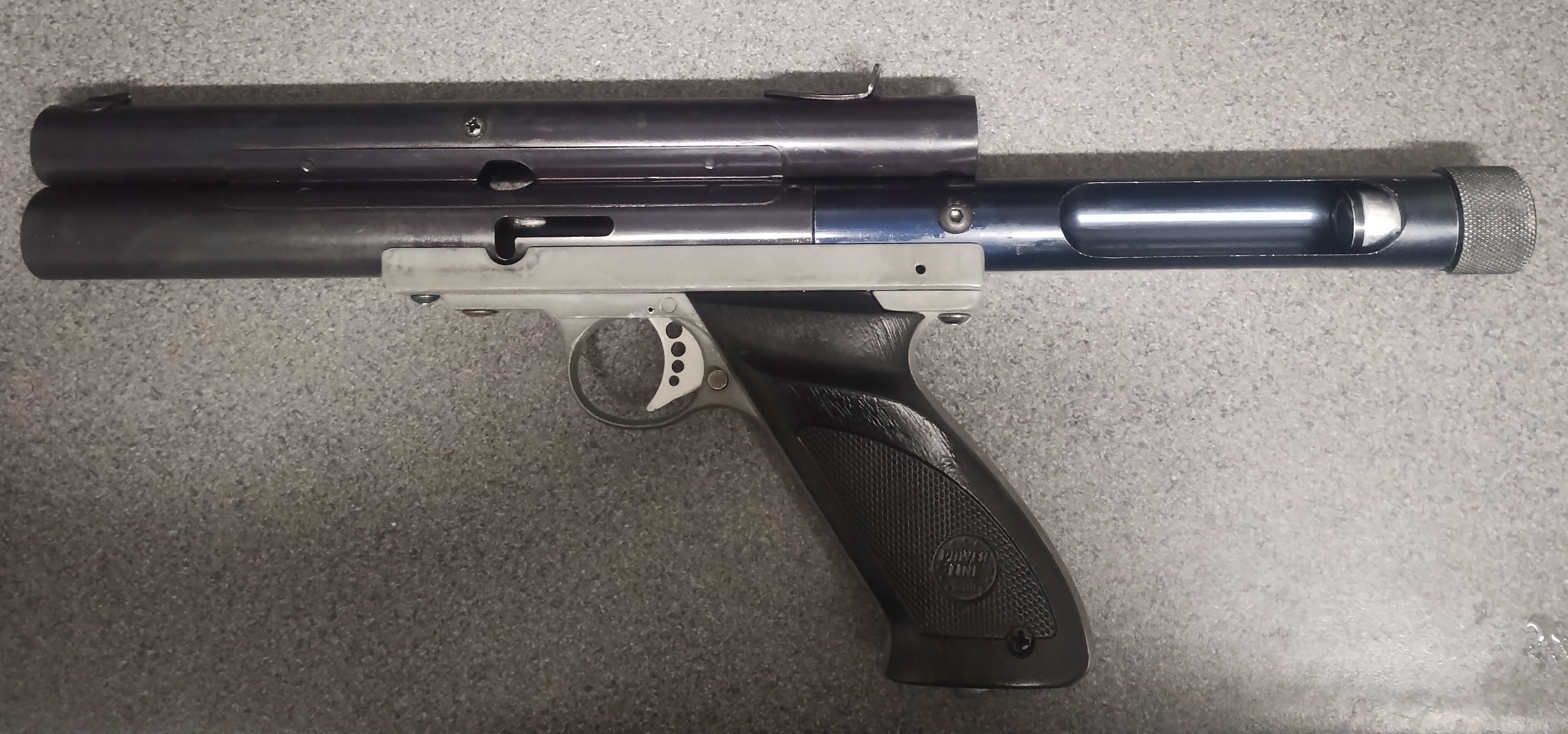

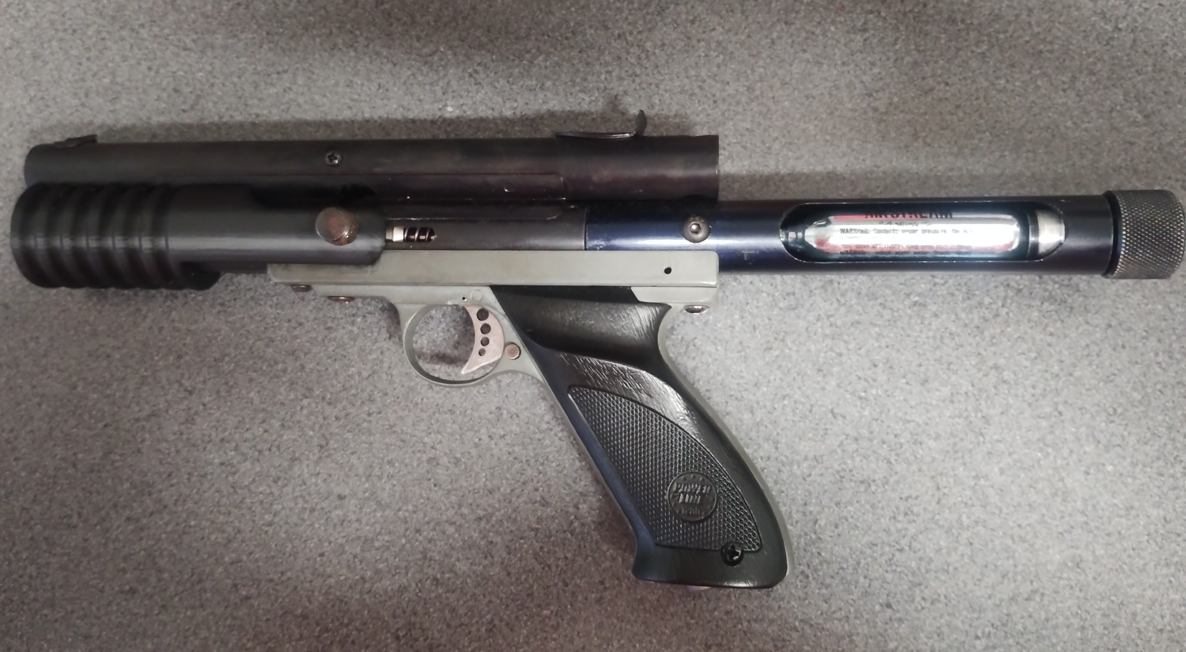

        Wow! That's a cool pump handle 😎 Mine is a replica type stock one. I found a local company that can do it in ASA so hope it's okay. I guess since I'm paying, I don't have to worry how hard it is to print 🤣
        So after a clean and a Cold-bluing bath, she's looking like this. Planning on fitting Phantom internals.

          Here's a link to a smooth one I designed: https://makerworld.com/en/models/885709

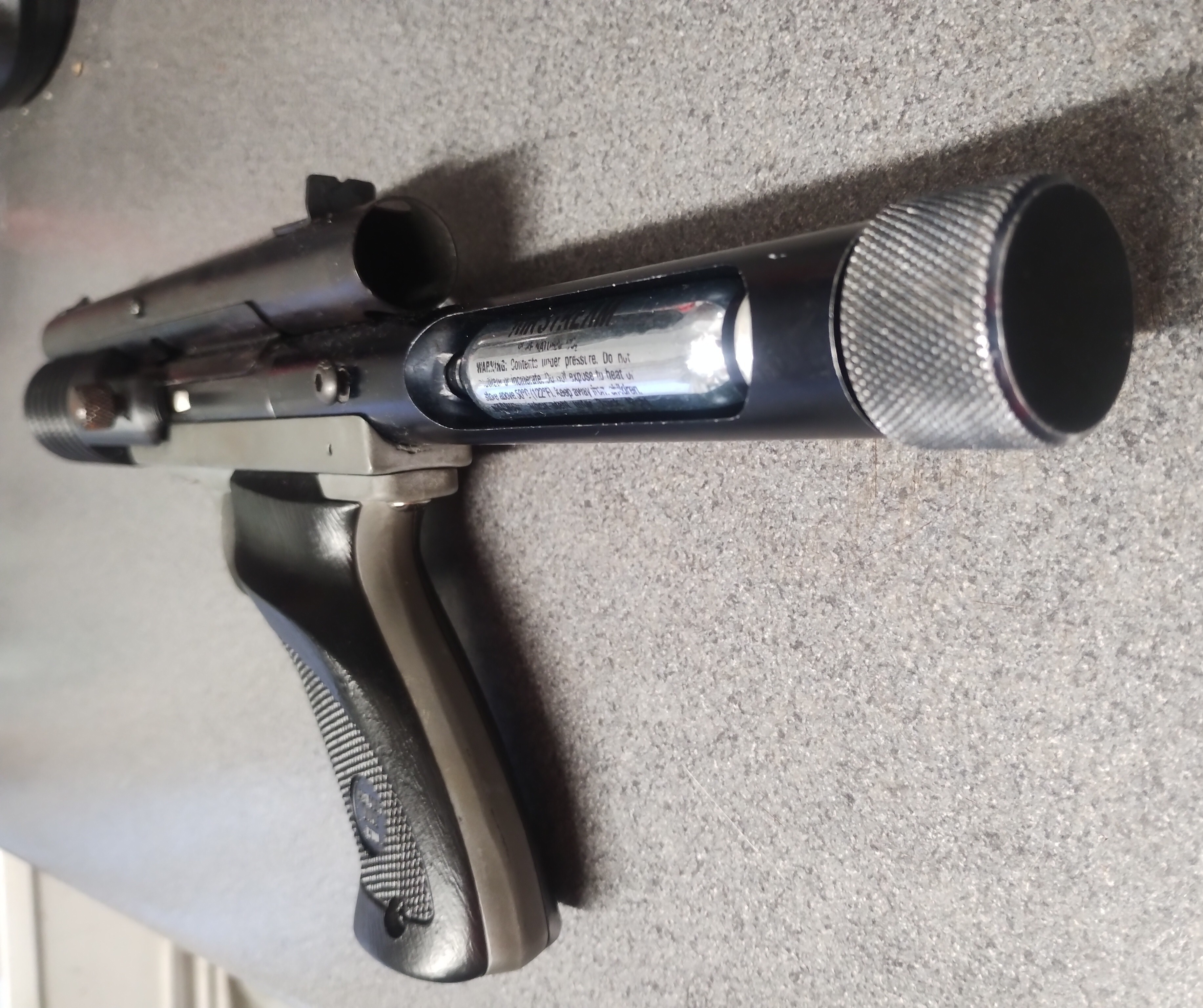

              Done!
              IMG_20241220_154644835.jpg IMG_20241220_154746505.jpg IMG_20241220_154848213.jpg
              So, in the new year I'll set up the Phantom internals a bit better. She's a bit stiff and ten shots per 12g isn't good haha. Plenty of springs round here somewhere. 🤣
