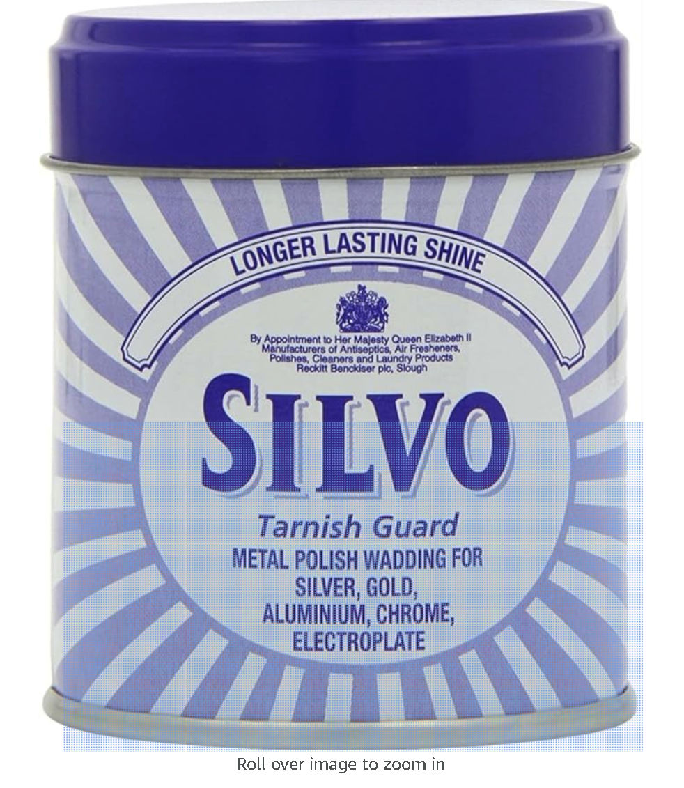

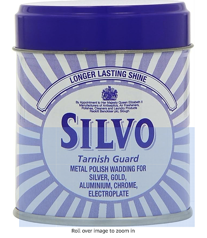

    My grandma give me a can of Silvo years ago. She used it for cleaning and polishing silverware. It comes in little can and you pull out a little wad of cloth soaked in the solution from the can. Great stuff. Used it on all my palmers guns back when I cared.
    Plus it has a great odor to it.

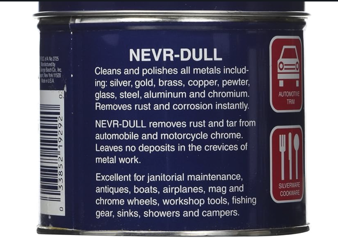

      I use Nevr dull, the smell is not great but it works on anything and while i see on Silvo it list electroplated items, on Nevr dull it states all metals.

        Never-Dull just thinking of that reminds me of getting in trouble during my Navy days >.<

          Silvo or Brasso will work with a microfiber. Nickel is usually very thin. Like less than .001 typically, so try not to use anything abrasive.
