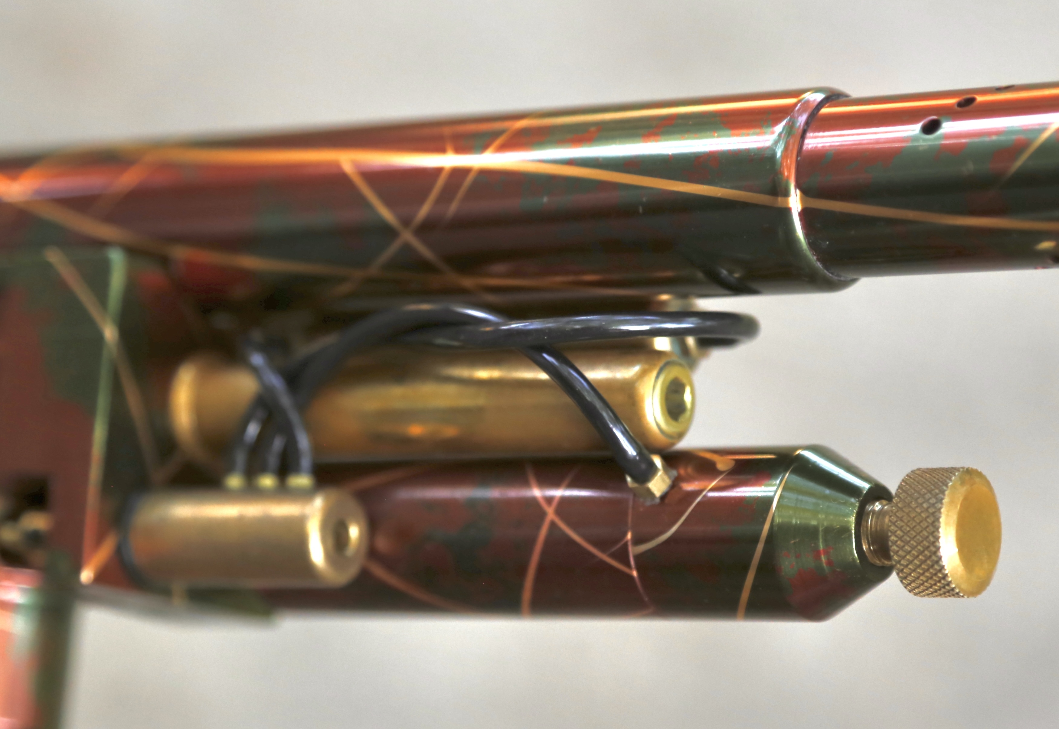

            Here is a brass angry on my old evo
