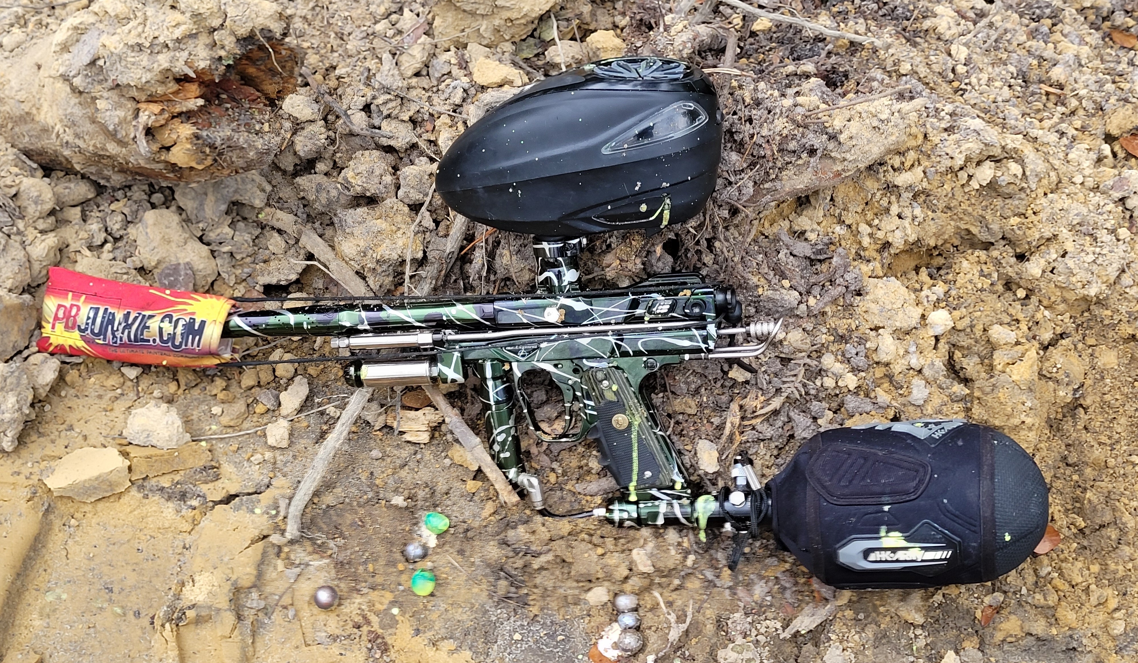

      They are tools and tools should be used for their purpose but should also be taken care of so they function. Cosmetic issues while painful to begin with fade quickly IMHO, while enjoying playing the game. I bought a highly desirable custom Banzi anodized Eclipse Cocker this summer and before the PayPal payment cleared to the seller I had the marker out on the field playing hard during a scenario getting it dirty, covered in paint, braced against bunkers, pushing through brush....etc. Even put it up wet and did not even wipe it down until the 2nd day.
      Picture day 2 prior to packing up
      • Sherwoodsghost
        Sherwoodsghost commented
        Sweet rig 10/10
      • Grendel
        Grendel commented
        Thanks, looking to use it some coming up at the end of the month.
