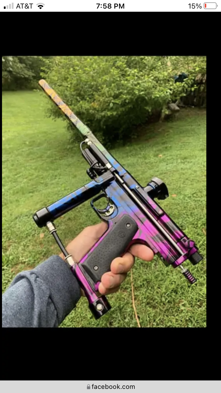

                        cannot believe my buddy sold this last month
                        but he did.
                        inline roundbody
                        went for $3500
